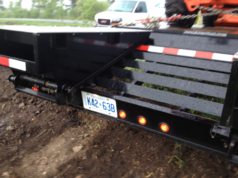

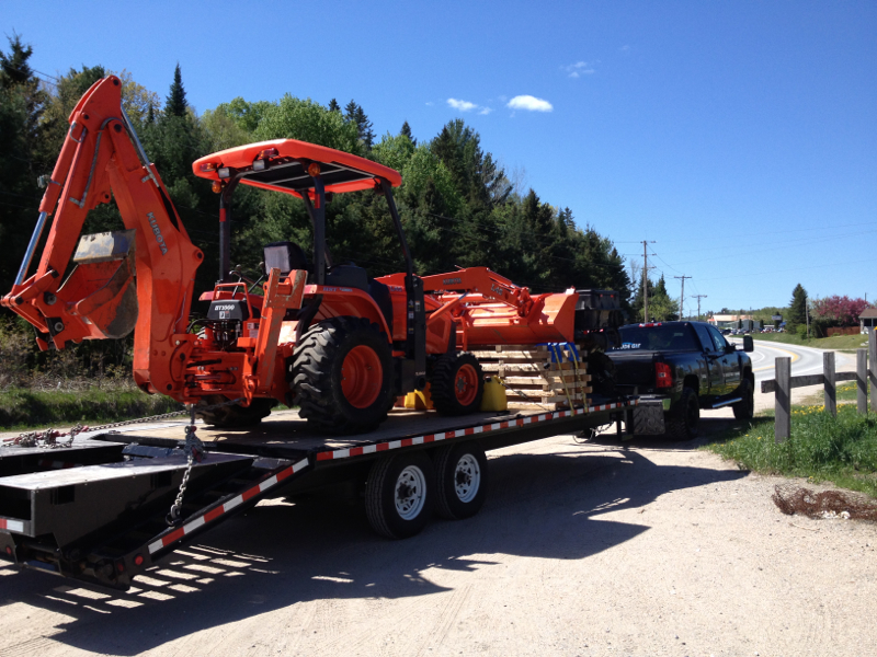

Yes truck and trailer are sitting level. Heres some shots. You can see the peice of 3" tubing is what I added. So you can see how far off it was before. With the tube, they are 3-4" off the ground. 7.jpg8.jpg
Also had to modify the assist springs. The doubles that were on it were broke. So I ordered new ones, but the peice that connects the two halves together was too short to touch anything, AND they were about 1/2" too wide to fit. So I cut them in half, and straightened what was left. Basically making two single assist springs per ramp. They work great now. You can see where I heated and bent it, that is where they were connected to eachother, and just too short to touch anything...

wow! those things were way off the ground before. I would guess someone put bigger tires on it at some point, at the rear of the deck seems pretty high off the ground as well. Can you see any evidence of "lower" the axles to clear the bigger tires? Nice truck and trailer btw.
Nope. I believe the tire size is original
/ Trailer Ramps / Leg height
#13
Springs are already under the axle.
I dont think anything has been modified, except maybe the ramps were added from another trailer??
I couldnt lower the trailer even if I wanted. As it currently sits, the GN is in its highest position. So if I lowered the axles, the trailer would have a downhill slope toward the back and look funny.
I dont know how it compairs, but with the trailer hooked up and level, from ground to center of the ramp pivot pin is 24"-24.5". The ramp legs were 17.5"-18"

Yes truck and trailer are sitting level. Heres some shots. You can see the peice of 3" tubing is what I added. So you can see how far off it was before. With the tube, they are 3-4" off the ground. View attachment 322742View attachment 322743
I need to replace one spring on my equipment trailer and its the same setup as yours, but with a wider ramp and hinge bar. Where did you get your springs, and do you have any tricks for installing them?
My ramps won't fold all the way flat against the deck to take tension off the springs so I'd have to compress the spring and support the ramp while inserting the hinge bar. How many hands does that take? :)
