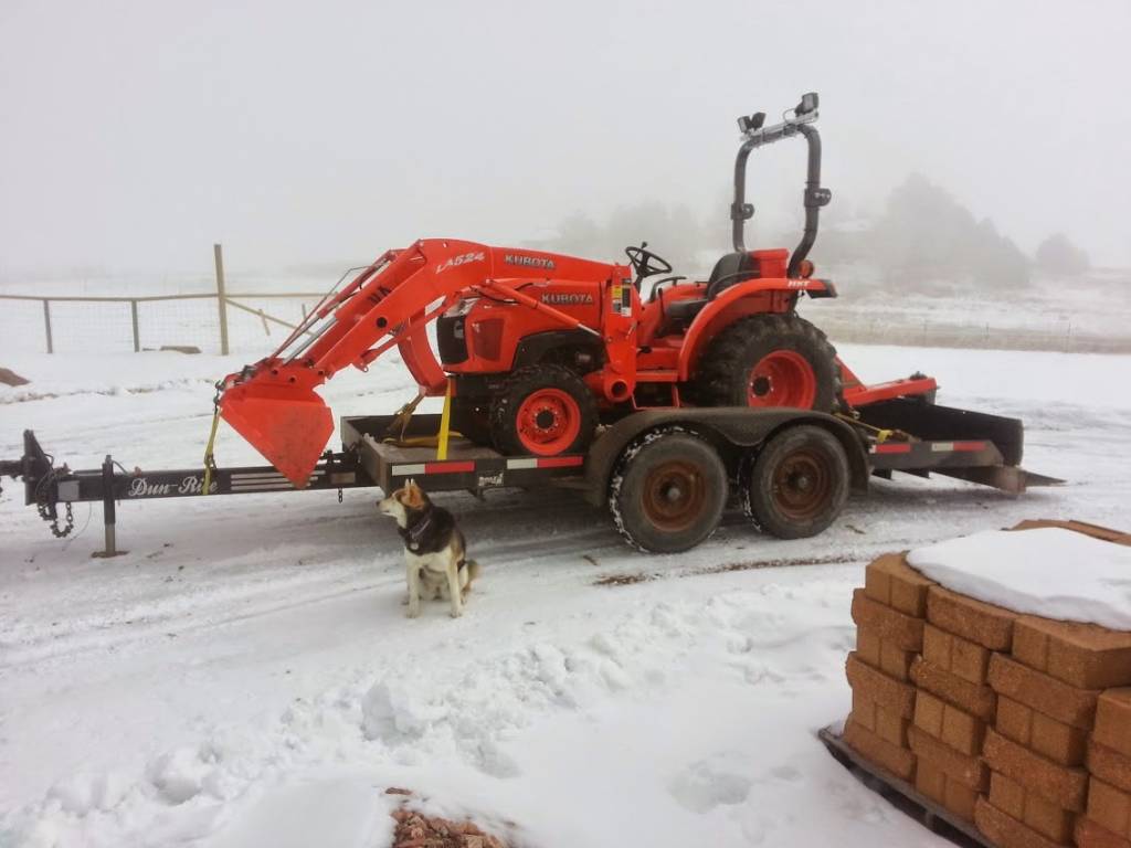

Just to put some closure to this.....I pretty much only use this trailer on my property but sometimes use it to go down to the nearest lake and fill my ibc tote.
LSS I hear a bang last weekend, pulled over and found a spring had snapped and struck the pavement. I nursed it back to my property thinking no big deal.
4 a.m waiting for sun to come up this morning and I decided to get under there and have a look thinking its just a busted spring and not an game ender.
Come to find out front r spring had been gorilla welded and it had snapped completely off.
R rear spring was entirely missing a u bolt and the pad was fixin to come out from under that spring entirely.
I picked up trailer with my fel and the axle fell off the spring.
Im in ocala now hoping to find parts at northern tool.
Don't trust anyone. The guy that sold trailer to me knew what he was selling.
No biggie. Ill fix this and now prob have a trailer that will not sway at all.

Huh? If you throw some northern tool parts at it, it will still be a junk trailer. Please, please do not use this trailer on the road to transport heavy things ever again.

If you are thinking of using this on the road again, I would put the front axle where the rear axle currently is and the new axle behind that so that your axle centerline moves back.
