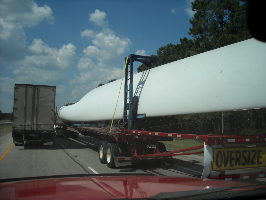

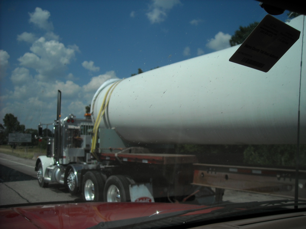

Not to criticize any of the creative ways some are hauling their tractors but many of them would not pass a DOT stop. To be totally in compliance when hauling a TLB both the loader and backhoe bucket must rest on the bed of the trailer and have their own chain, not strap, restraint. The tractor itself must be chained to four points.
DOT focuses on commercial users for the most part and let a lot of us home owners get a way with some violations. They do have the right to check and ticket anyone hauling a trailer and they do here at times. If you want to follow the letter of the law there is no way you can haul a BX on a 10 trailer and meet the standards.
MarkV
Got a link to those regs? Straps are used on everything down here. How about a 100' prop for a wind turbine? Got Straps?? :D
Rob I don't have a file on the regs and am to lazy to go looking for it. This is information I got from one of the DOT guys in the area. We have a good number of them around here because of all the pulp wood haulers in the area. Those guys push the limits often so are looked at closely.
From what I was told straps are fine for a load that does not have the possibility of suspension movement, which includes rubber tires. Everything else requires chains.
Also I am not trying to be the safety cop. I haul so little for such short distances that when I do I don't meet the regs myself. It just isn't worth the expense of a lager trailer for as little as I use it. Just wanted to point out to new users that even if you meet the weight restrictions of the trailer you are not necessarily legal. Most rural areas seem to be pretty lenient for non commercial users but I am sure some are not.
MarkV
