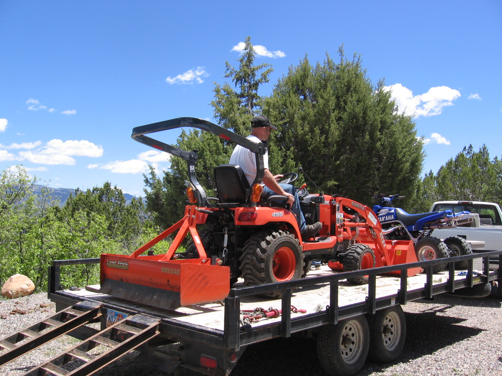

18 footer here, with plenty of room for everything else.

Mr. Coreshot's setup is nice with the deck-over-wheels configuration. The 18 foot flatbed has about the same room as my 20 foot dovetail...I just have a little extra space to set extra ramps or the BH bucket in a bind. Curious: Do the side rails fold down to allow side-loading of the ATV or do you shove it into the sideways position?

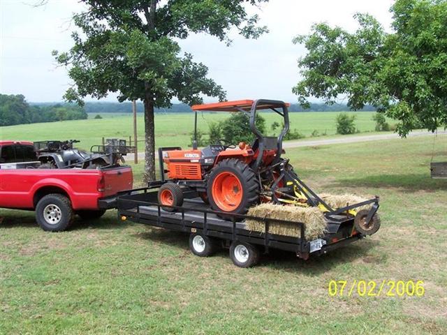

I certainly would use it, don't have to buy/store another trailer. Mine sits back in the woods up at the country, out of sight, out of the way. When you get right down to it, most guys here that are not running a commercial business have a big fancy trailer that they don't use that much to haul their tractor. Maybe a bit more if they haul it between home and a weekend place. I only need my tractor in town a couple times a year to clean up around the area clubhouse. I could borrow or rent and come out better in the long run, but I wanted to make my own.
Sides do come off, makes a good float to!
I have to turn it sideways, but only if I am hauling the tractor also. Normally, I have 5 ATVs- 3 kid sized units that all fit across the front, and 2 Banshees that pull up behind them. This leaves room for 2 additional full size ATVs on the rear. I plan on purchasing a UTV in the near future, at which time I will modify the rail on one side to accept a side loading. The trailer is a full 8' wide inside the rails, so when turning the ATV sideways you don't have to lift it over the rail, it just slides around.
