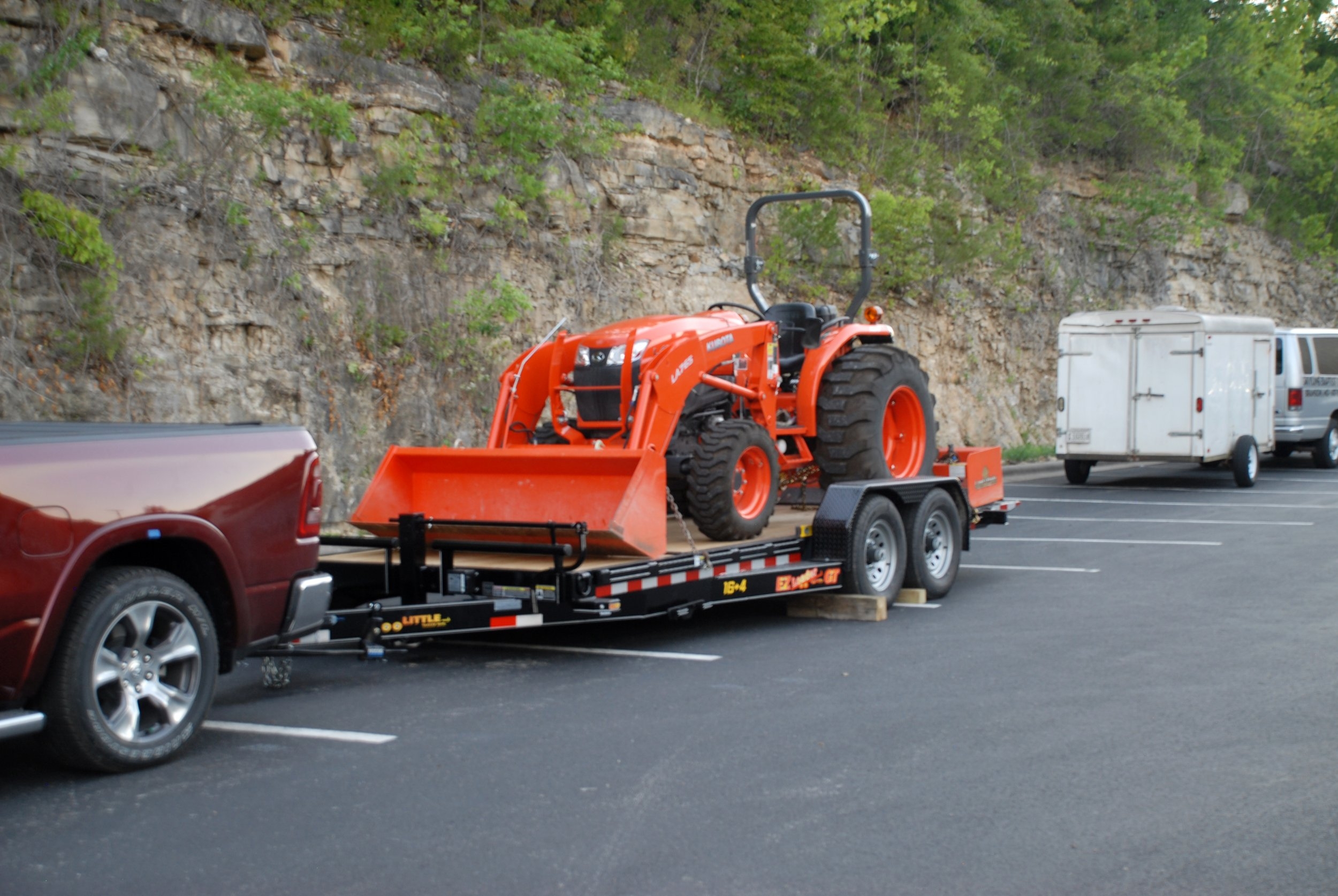

I purchased a Diamond C 24ft 14K tilt with pop-up 12k winch recently. IMHO, it’s the slickest setup you can get. Full 8” I-beam construction. Just towed it cross country with no issues.
View attachment 799244View attachment 799245

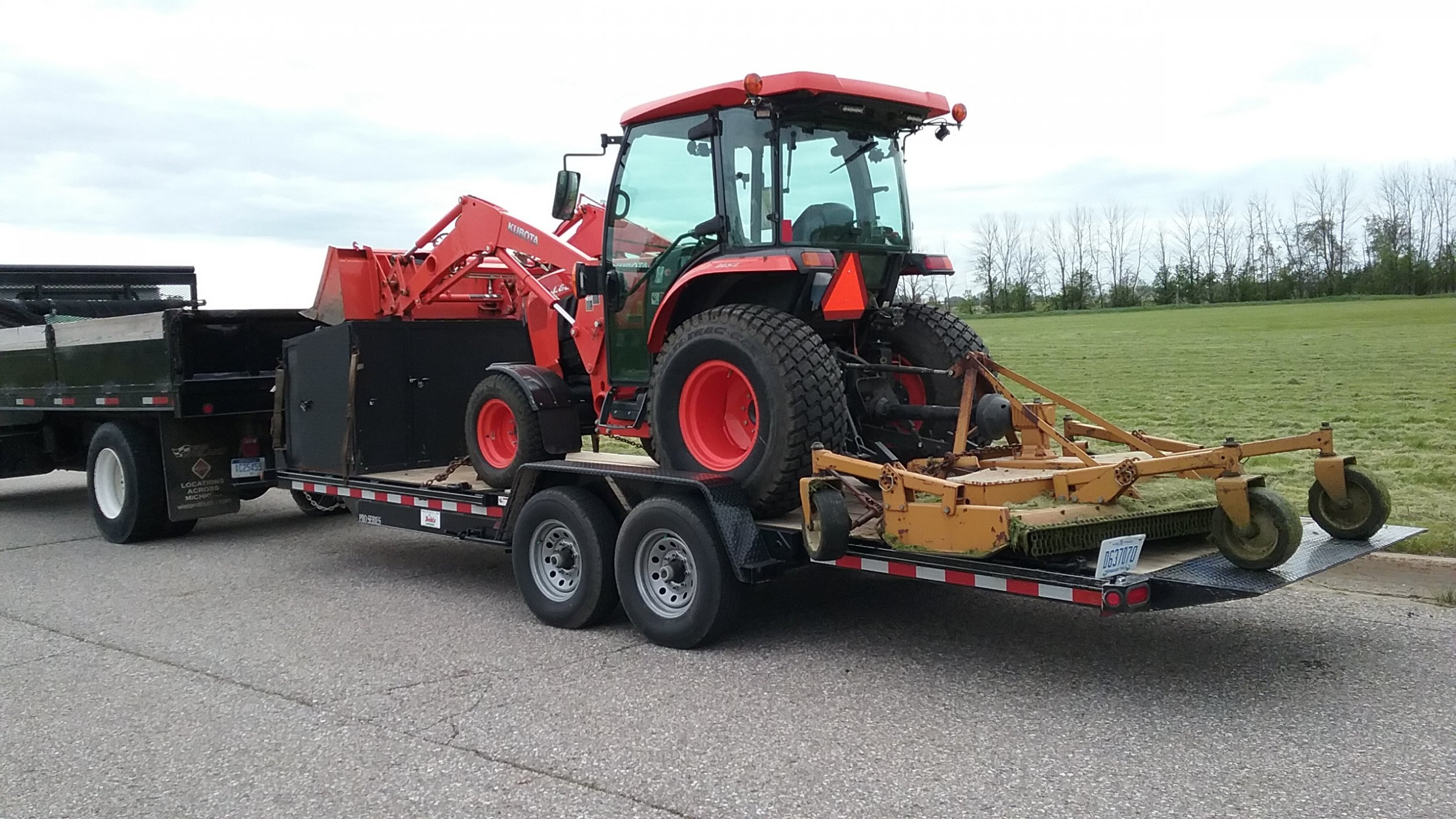

Mine is a 24ft, 8ft stationary 16ft tilt. I went with the 24 because you figure a tractor + FEL + 6ft bush hog is 22-23ft long and you want some room for balancing and tie downs.
IMO, 22ft is the sweet spot for good length but also being able to maneuver. Also, the 24 has quite a bit of tongue weight so consider the payload rating of your truck. My trailer is 4510lbs empty with 980lbs of tongue weight (22% on the tongue).

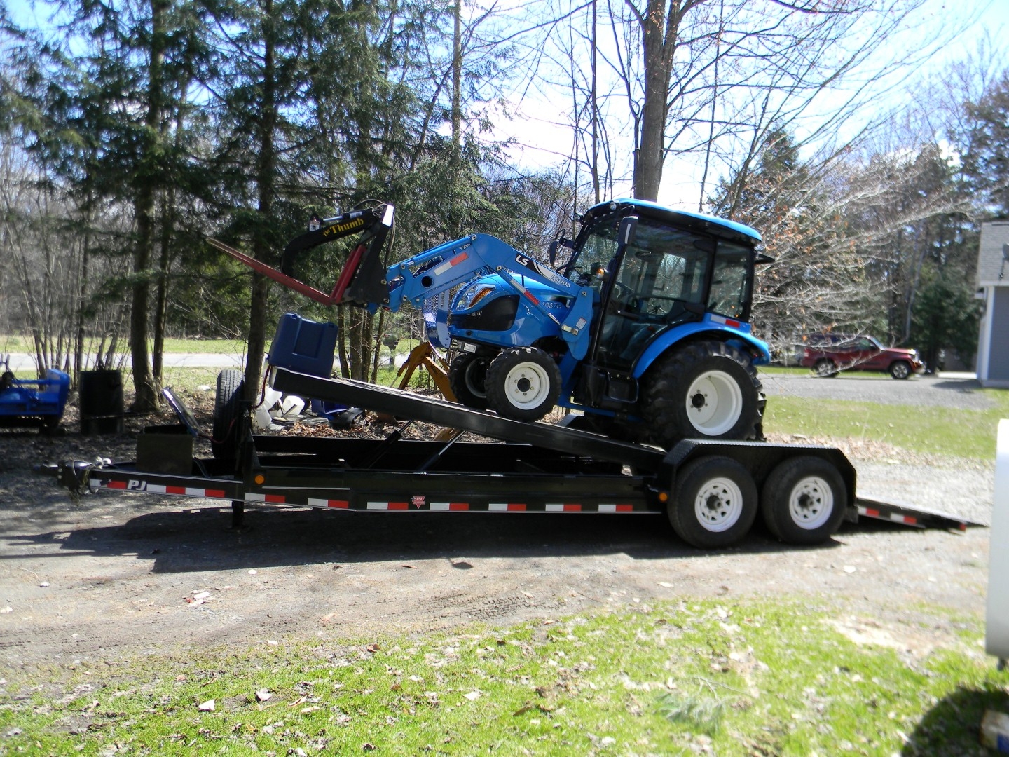

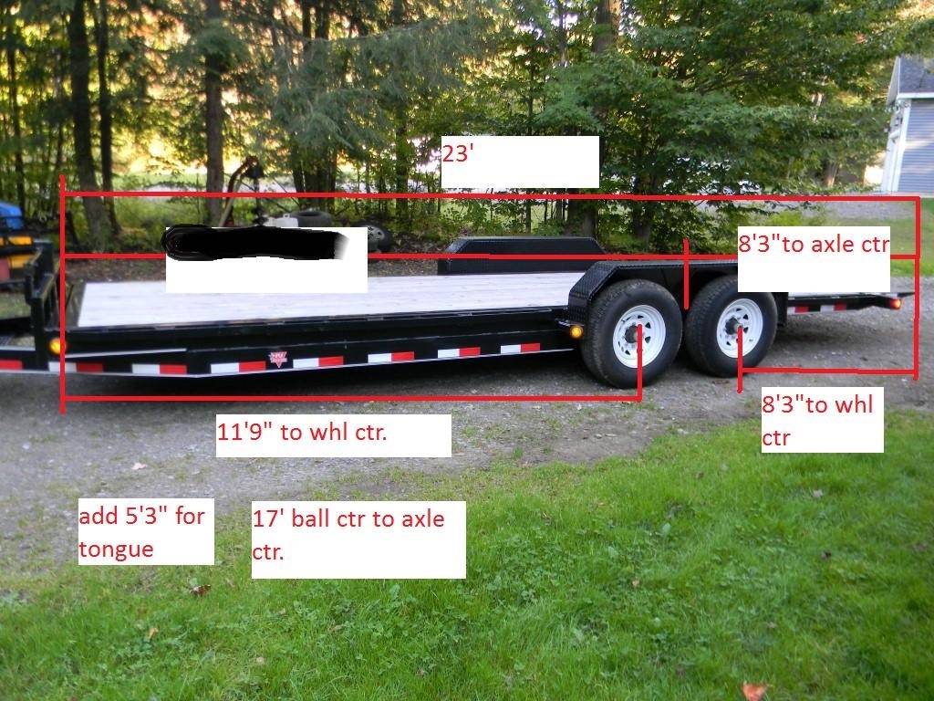

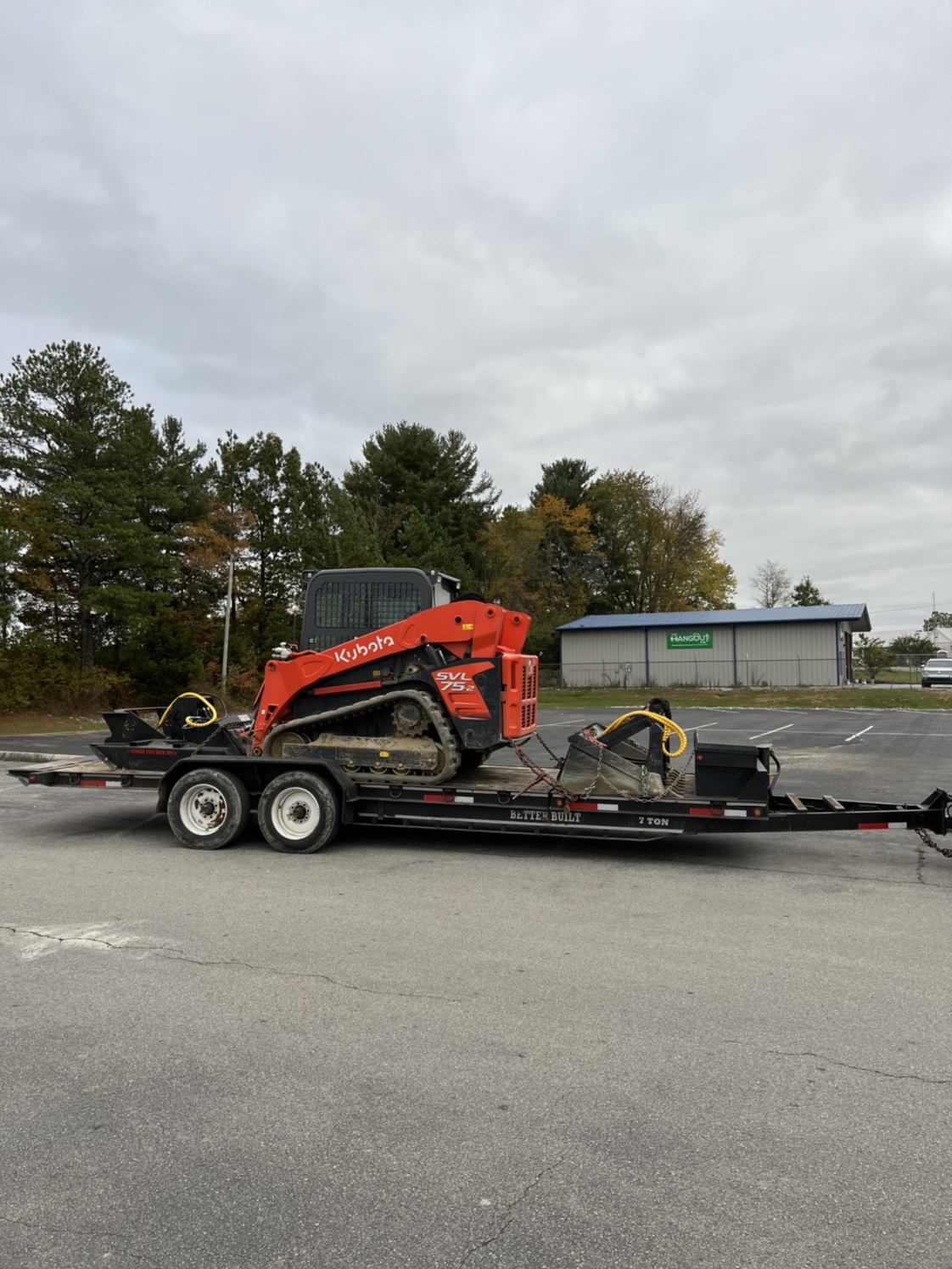

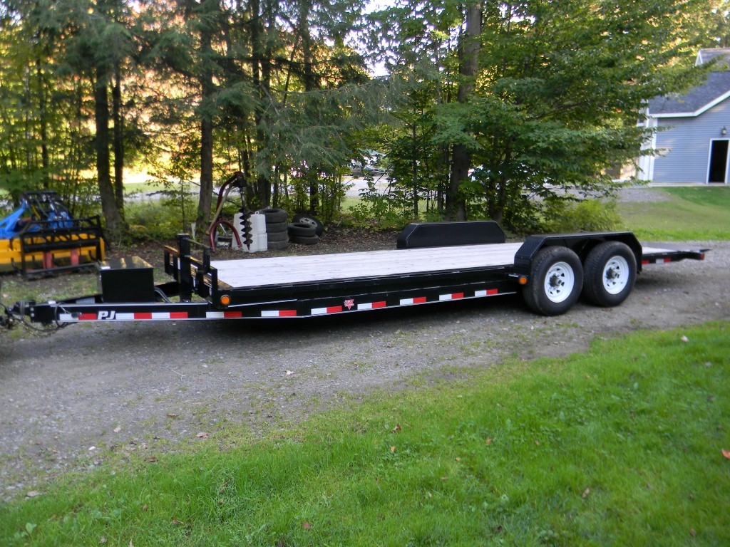

I have a PJ 14K tilt bed model TF 22' (actual just under 24' including tail). I added a winch and made D-rings that drop into the stake pockets. The axles are placed back further than most other brands so its not real long behind them. Weighs just under 4K. Tow with a Chevy 2500HD crew cab 4x4 6.0 gas 4.10 gearsView attachment 799148View attachment 799149View attachment 799152
Nice trailer!!!
I like the limited rear overhang.
I wonder if it would dump loose materials? I seldom need a dump trailer.
/ Trailer question - skid steer #28
Nice trailer!!!
It tilts about 11 degrees before the tail touches the ground so not much would dump off it.

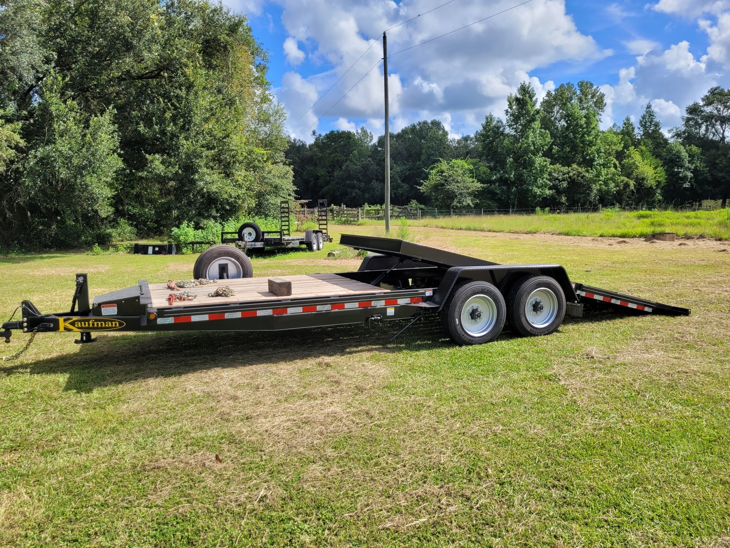

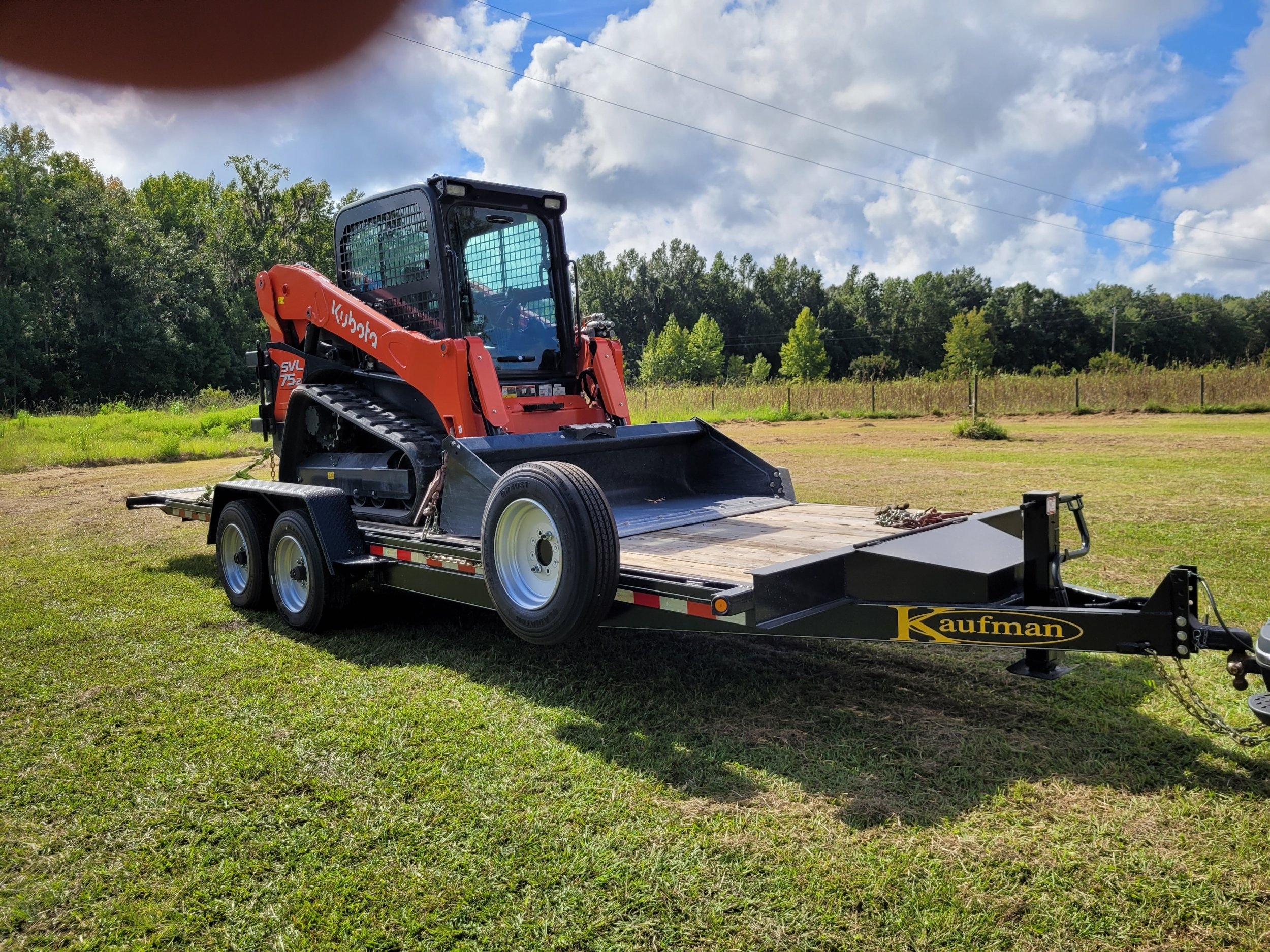

I went out and bought the very trailer that I said in the beginning of this thread that I believe I would look into, 22' Kaufman tilt deck with upgraded 8k axles and 17.5 tires and I am happy to say I don't miss the ramps on my equipment trailer at all.

I went out and bought the very trailer that I said in the beginning of this thread that I believe I would look into, 22' Kaufman tilt deck with upgraded 8k axles and 17.5 tires and I am happy to say I don't miss the ramps on my equipment trailer at all.View attachment 834051View attachment 834052
Real nice. (y)
Smart to get 17.5’s They are super strong tires.
I have dual 17.5’s on my Kaufman and they show no signs of weakness even loaded real heavy.

I swapped 17.5s on mine. They’re better in every aspect than the 16”s I had to start with.

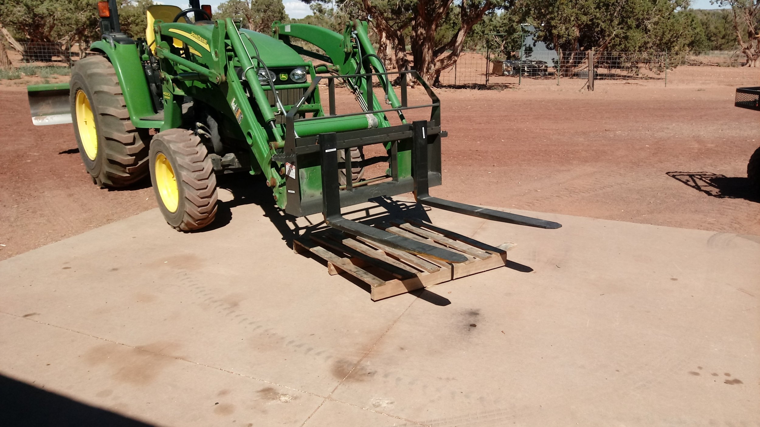

Do you find it difficult to see the tips of your forks at all? I bought a set (42") for my compact tractor, similar is size to yours but find I can't see squat until I get about 2' off the ground. I find myself not using them and always go get my Bobcat if I need forks.

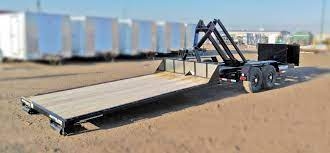

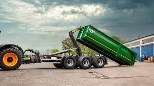

I'd go with a hook lift trailer and get a second flafbed deck
/ Trailer question - skid steer #37
I had a hook lift f750 that we bought new, what a slick unit. Had a "can" and a flatbed. What we found out was for any meaningful load we needed another axle to be legal. While in the truck body place there was a brochure of the same "Stellar" hook on a GN that's been on my radar since
That's a nice trailer pictured above, an actual hook, where I see a lot of the smaller ones using a winch.
/ Trailer question - skid steer #38
Check out some of the nice tri-axel and tandem wheel units
They can be hard to see. I haven’t had too much trouble doing 99% of what I do with them. Forking a pile of brush to move it to a burn spot is easy.
