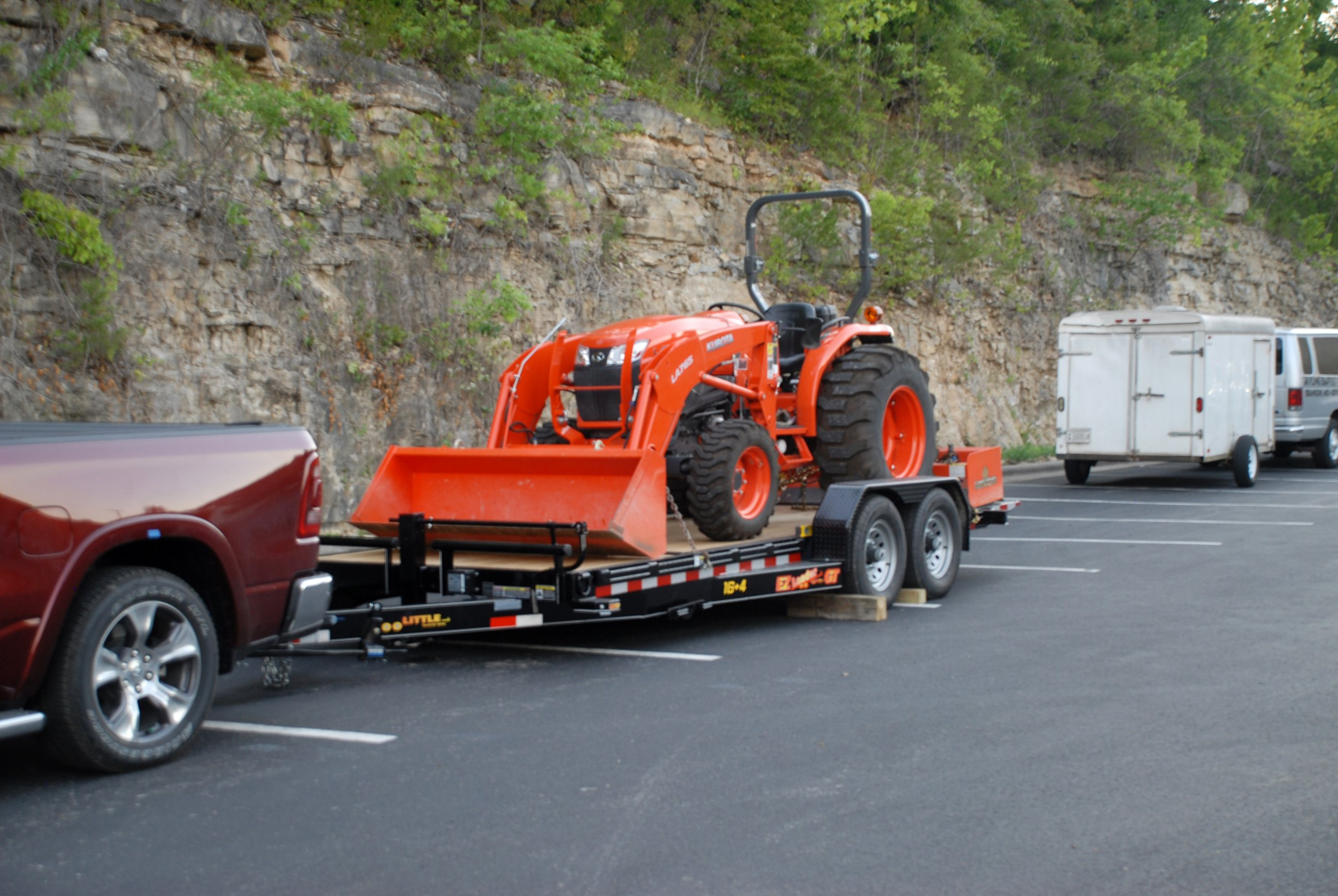

I am glad I got 14K. I would have regretted the 10K and struggled to keep it within weight limits. My trailer is a 14K 20' tilt bed Doolittle EZ Loader. It tracks well both empty and loaded. View attachment 766342
