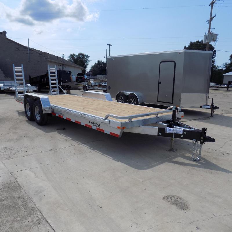

   / Trailer question - is there too light of a load for a 14k trailer? #39
The trailer in question. Becks is a good dealer and Legend makes a good aluminum trailer.
Nice looking trailer. I do like that it is rated 14K and 1400 pounds lighter than my steel trailer. ...Now that statement carries a lot of weight....OH BOY, That might be a PUN. Because it means you can load 1400 more on to it than I can load with my steel. But I personally would ask them about changing to Dexter EZ lube axles with slipper springs.
Considering my tow vehicle is rated at 9800lbs, I probably should stick with the 10k trailer which would cover anything currently I tow.
If the price between 14K and 10K, is close, consider the 14K anyway. 10K are harder to find and the common weights seem to be 7K and 14K. You may find the 10K and 14K priced very close. Then there is "No Loss" in getting a trailer more capable - you may sometime change tow vehicle - Or have a heavy load that could be towed by another truck or vehicle. When I bought my trailer, the 14K was only $300 more than the 10K. But then, that was 2017. I see the SALE price of my trailer has doubled since then - I saw it advertised retail $15K and on sale for $9999.00. That is sad. I paid $5000 for it.
A 14K loaded to capacity "feels" heavy". A 10K loaded to capacity also "feels heavy." A 14K loaded to 10K does not "feel" loaded to capacity or heavy.
Best Wishes.
