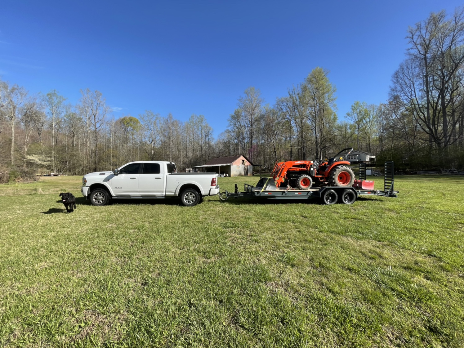

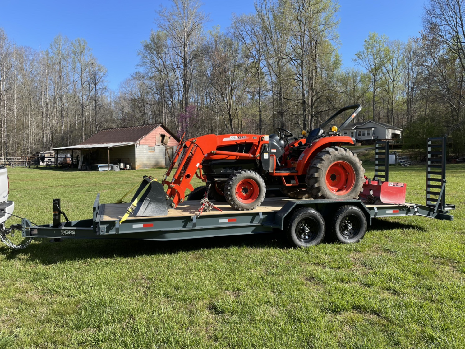

I am in the market for a trailer to haul my tractor, DK40 HST, the longest the tractor will be is almost exactly 22ft with the loader and bush hog, although 98% of the time I wouldn't be hauling it with the bush hog, and with any other attachment I'm only between 17-19ft. I was ORIGINALLY looking for a 20ft 14k but the more I thought about it I figured I'd enjoy the room of a 22ft. I called a local dealer and they actually didn't have a 22 but they do have a 24ft in stock. I haven't gotten a chance to look at the trailer yet (to check for Quality of build) but what is your opinion on a 24ft bumper pull? I will be pulling it with a RAM 2500. It seems like a lot of trailer to me but then again I'd have no worry of needing extra space.
Another question would be, is anyone familiar with Currahee trailers? That is the brand of the trailer (24ft 14k) and this dealer has quoted me almost $600 less for this 24ft than another dealer had quoted me for a 22ft GPS brand trailer.
I know that better quality comes at higher prices and I haven't gone to look at either trailer (neither dealer is super close to me and of course they are in opposite directions from me), just curious if anyone on here was familiar with either the Currahee or GPS Brand(s)
No, I don't feel like reading the other 123 posts on this topic. I offer a couple of comments for whatever they may be worth to you, the OP:
1) Your tractor is about 11 ft long and weighs around 3800 lbs. So why on earth would you be considering trailers 24 ft long !? They may outweigh the tractor. Planning to haul two at the same time? Ha!
2) The loader on one end and the hog on the other end can very readily be made to hang over a couple of feet or so. Of course you MIGHT have in mind heading off future needs for longer objects BUT in lieu of that (even with that) I recommend:
-- something equivalent of a Pequea 1018 deckover trailer
- short beavertail helps a lot loading, etc.
- 12,000lb GVW is overkill for you but it can be bought SHOWN AS 10,000lb which avoids all sorts of needless insurance, licensing and other bull crap excessive attention
- the deckover gives you way better flexibility for future wide loads and oddball loading configurations. Fender models are a PITA.
- there are many good brands competitive in this type trailer. Kind of a sweet spot in the industry. Very solid, readily avail in most parts of the country, etc.
- Think in terms of around a $6000 price tag.
3) Brakes on one axle would be perfectly adequate but both axles are nice to have. PA requires 2 axle I think but that while buying. It is not like they are going to stop you along the road and see how many you have.
4) A 24 ft trailer is nothing but a pain for poor maneuverability and space unless you have some (yet to mention) reason to go that long. There is absolutely no excuse for going to a gooseneck based on what you describe.
