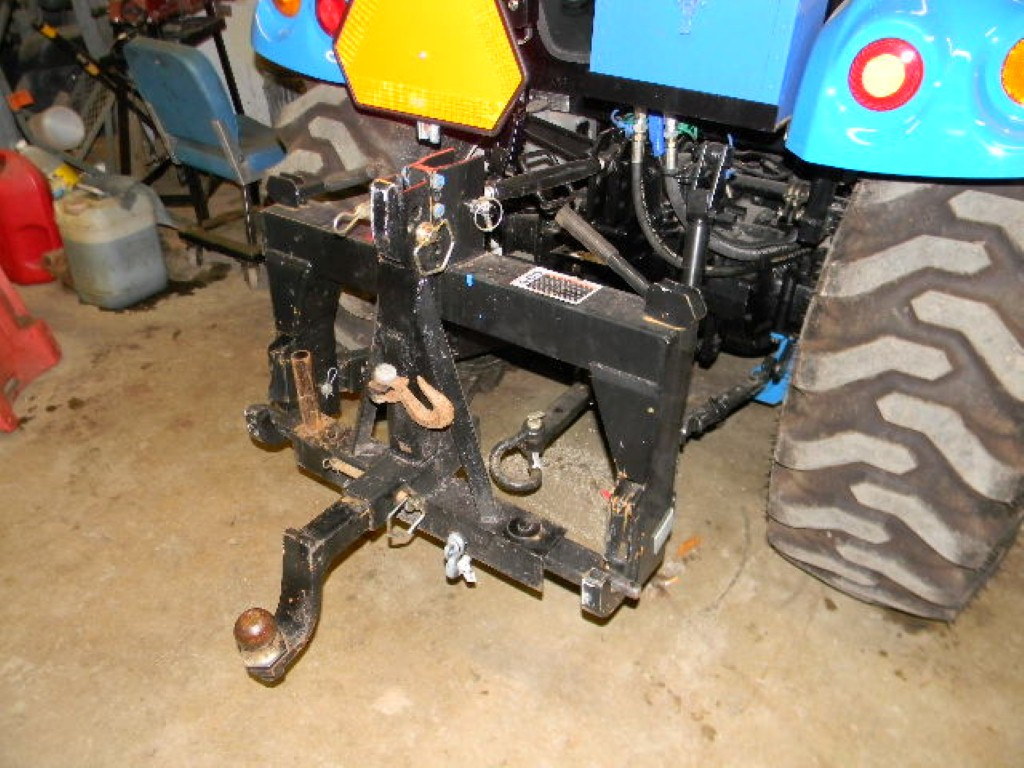

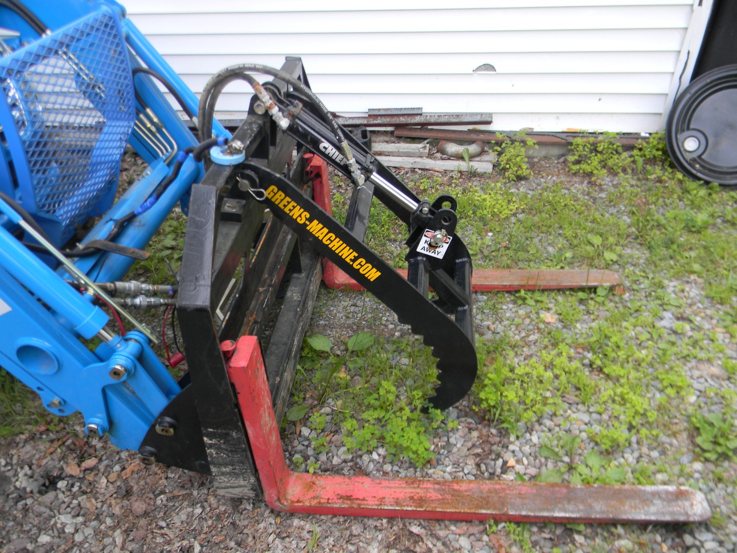

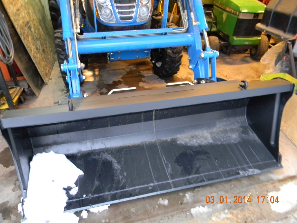

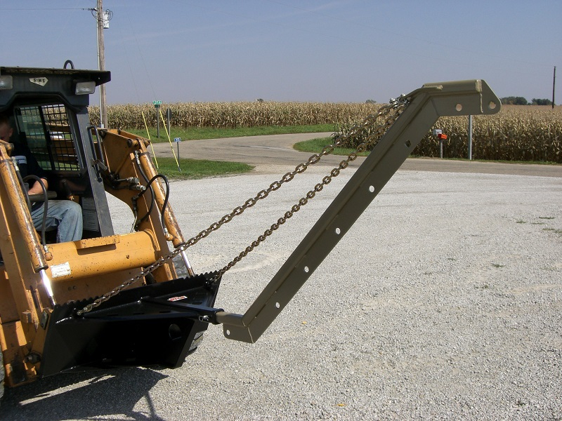

I made a trailer mover to attach to my 3 pt quick hitch. Works very well. I don't have a gooseneck trailer so didn't make it with a ball on top.
For lifting things I usually use my forks or I can lift with the bucket by hanging a chain between two hooks welded to my bucket.
Thanks for the feedback! I too use my bucket and\or fork attachment currently but it's gotten to the point I've ran into situations repeatedly where I have issues and have to rig it up and make it work... which is fine, but at this point I'm thinking I need to save time and be a bit safer :D

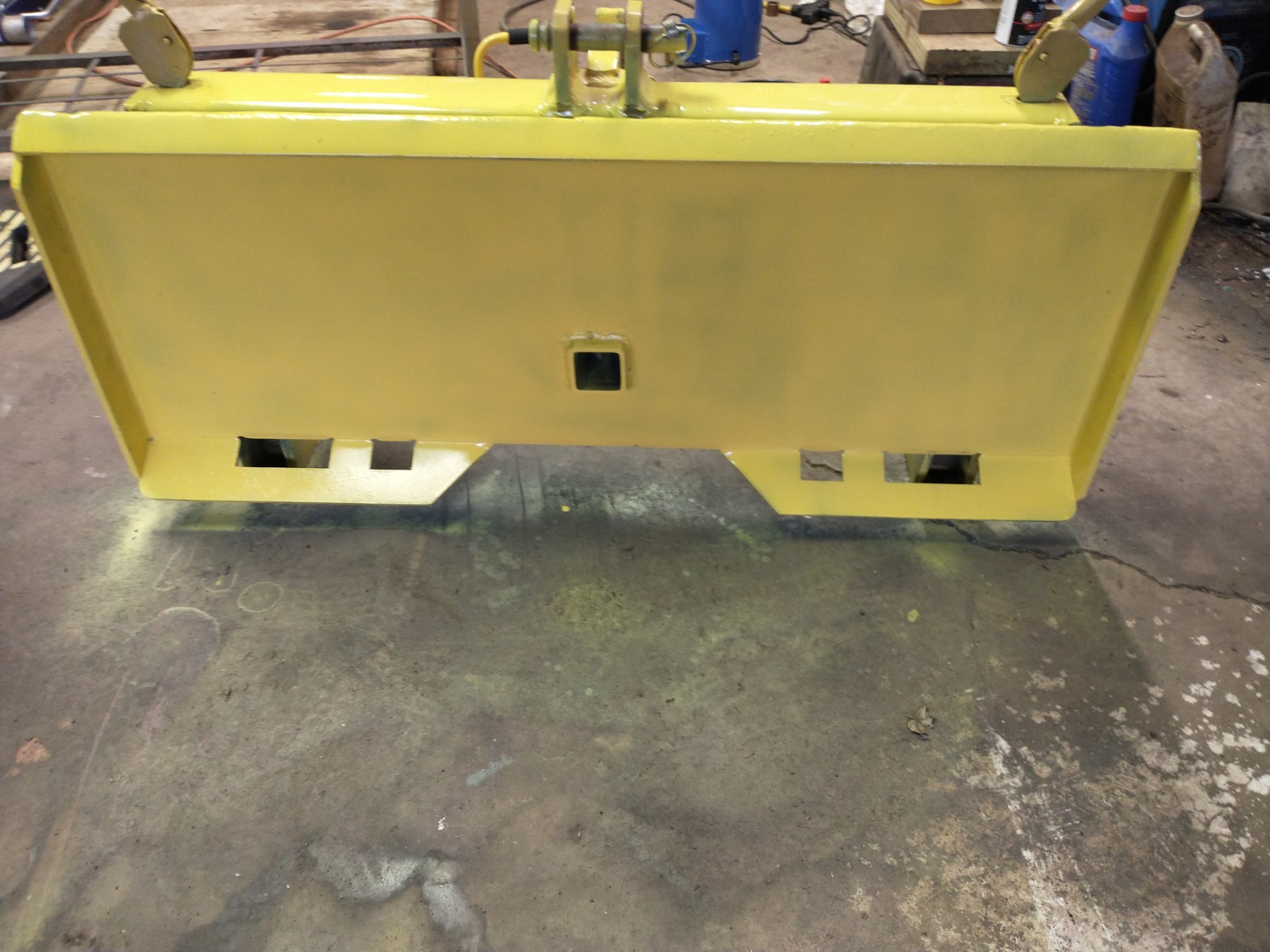

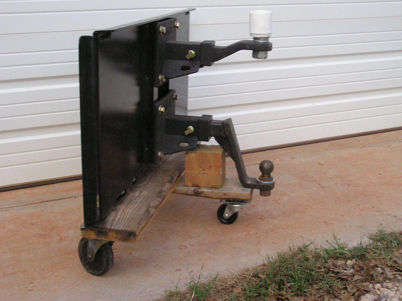

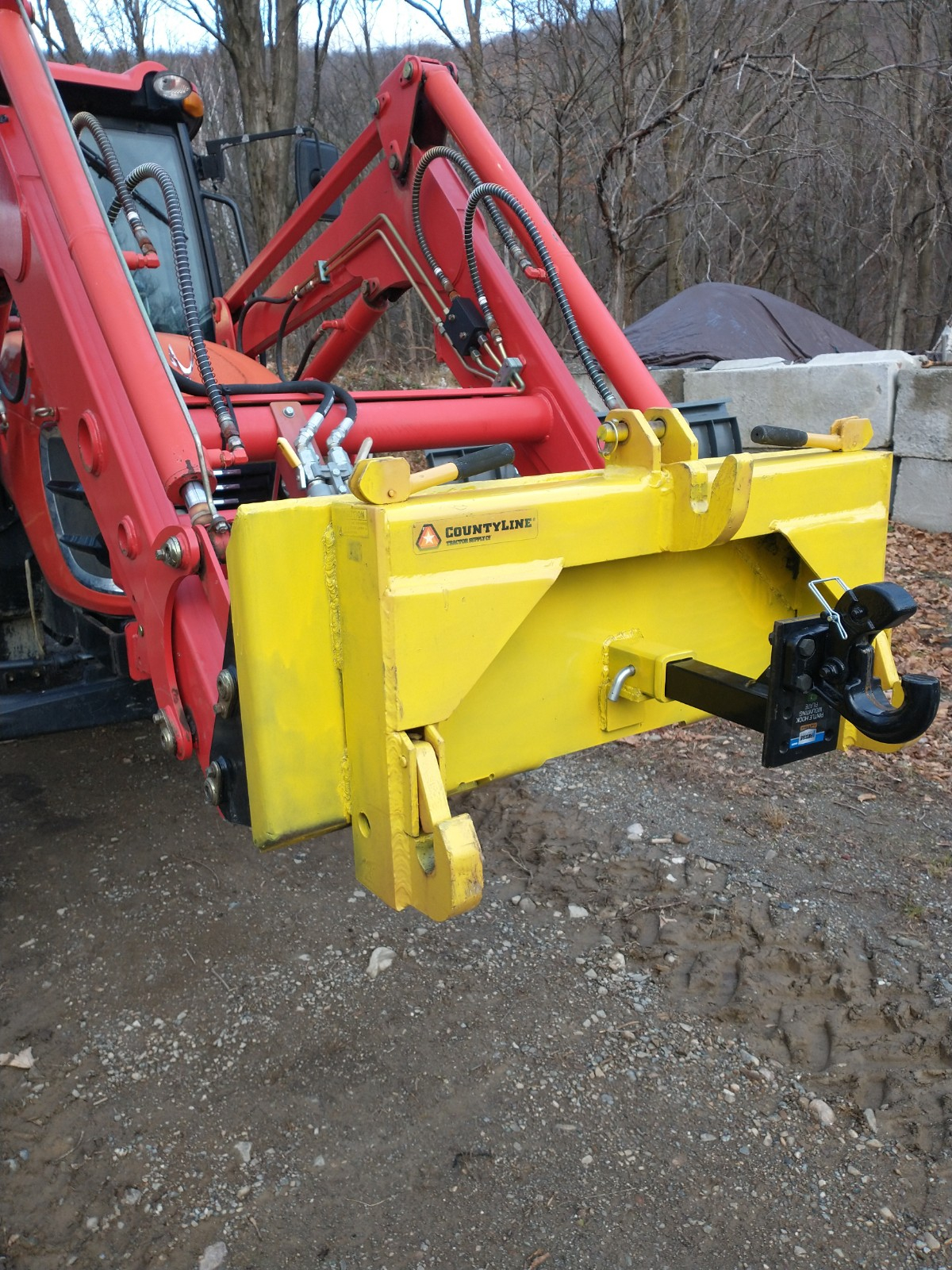

I have a SSQA plate with a cat 2 quick hitch and a 2" receiver in it;

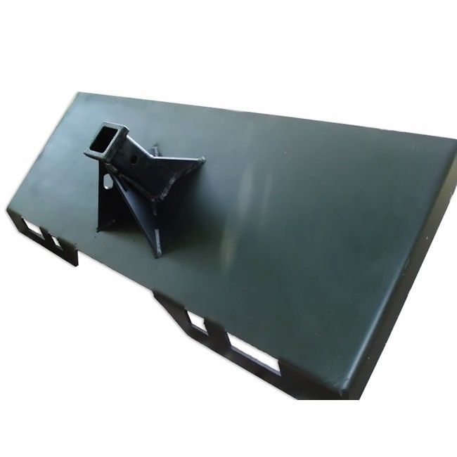

I didn't make it, I bought it. It works great for moving trailers around. I have multiple ball mounts for it. I use a pintle hook mount with slings to move some stuff around.

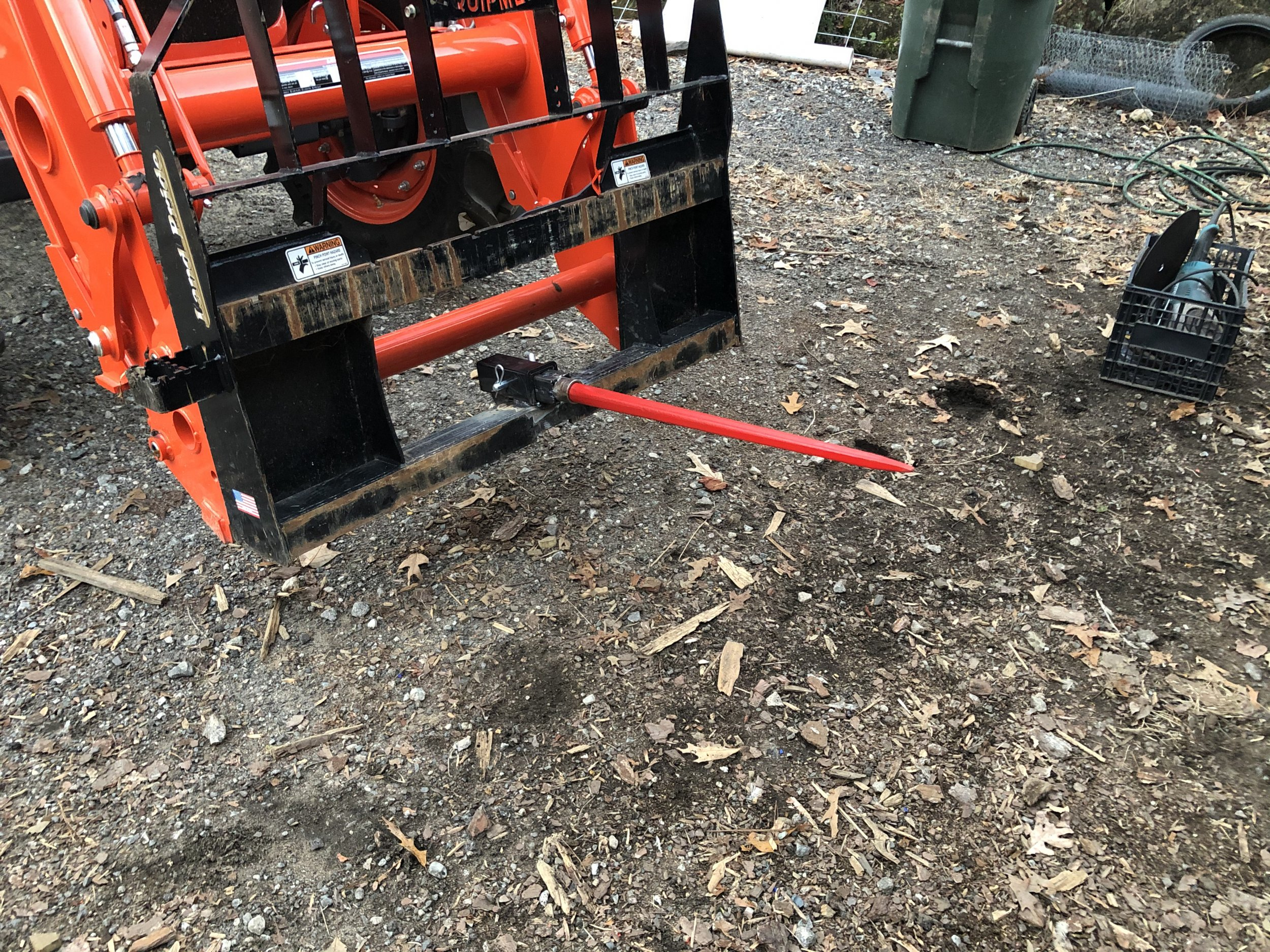

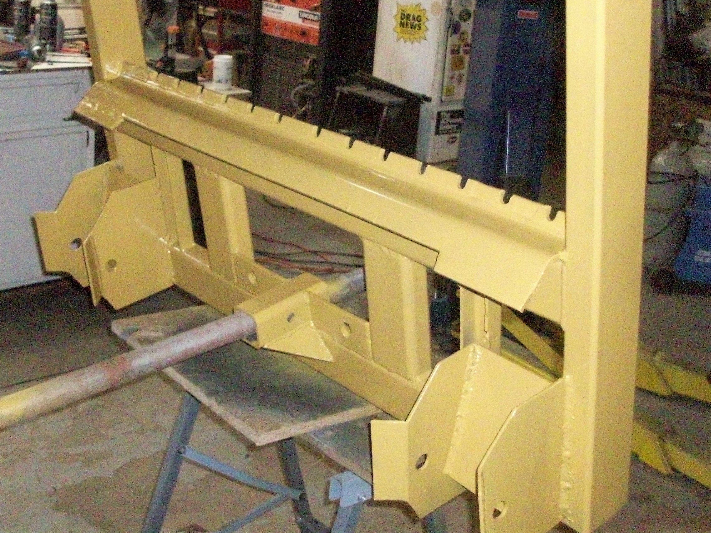

I added a receiver to an old New Holland skid steer forks mount
I left the rear vertical tubing and have ideas for a single easy mount log grapple and or a pole lift -maybe,
works for moving trailers so far also put a hole in the 3rd (spare) fork for moving/lifting things
Also mounted my 12k HF winch on a receiver insert but have not tried it on this fork mount yet
also planning a fifth wheel trailer hitch lift for this
