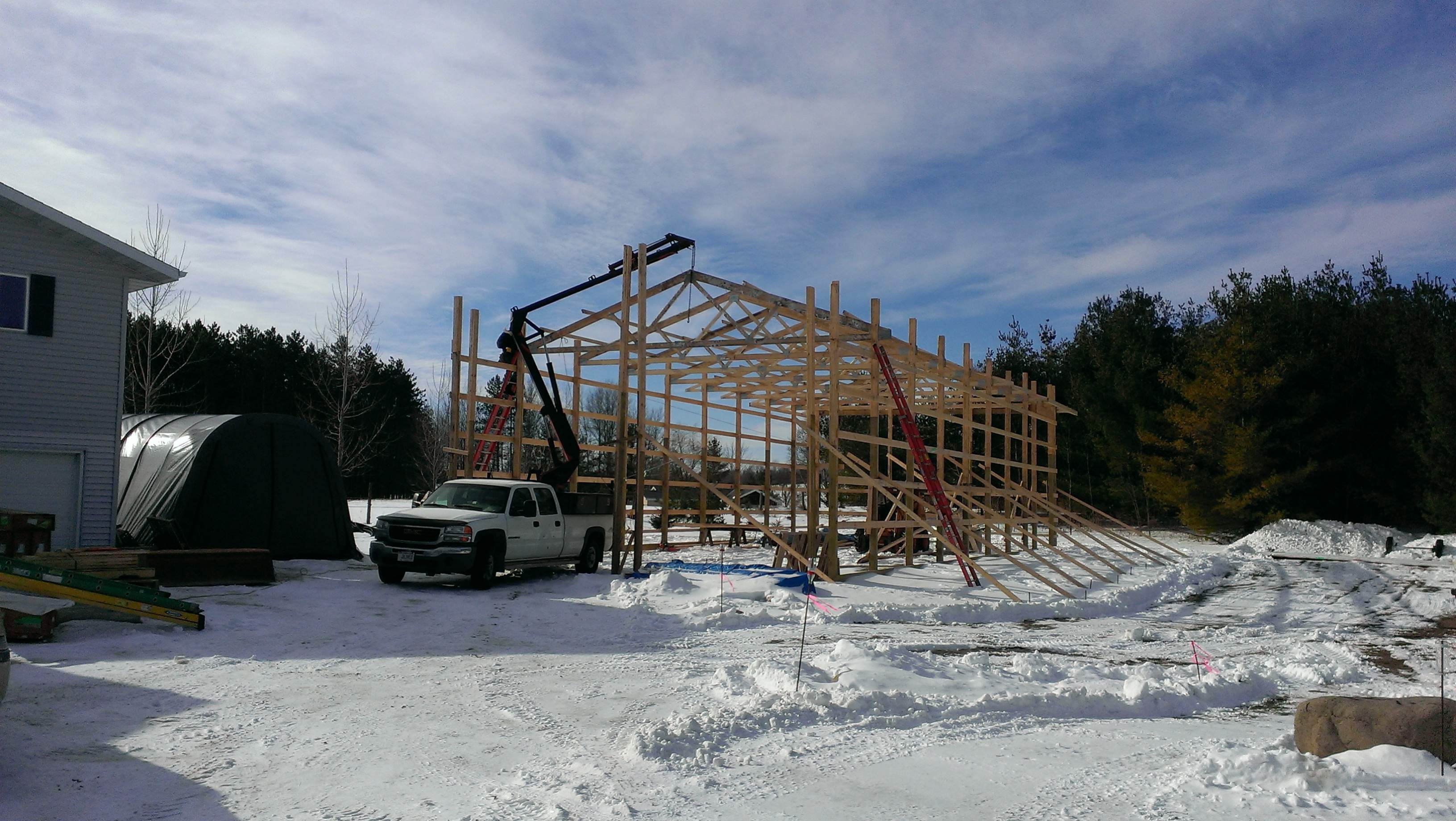

This is how the guy that built my pole building did it. Makes thing more mobile that using tractor. He powers it off 110, drags extension cord around or uses generator. work real well. allowed him to build pole building by himself.

/ Trailer for this project? #13
The above fab it up and put it in your pick up. The guy that did my pole barn has both he uses the one in his pick up more because it it more model. Also, second truck is a pain, to maintain and insure. He has it set up so it slides into rails and then pins it. he says take about 1/2 hour to remove. Only time he removes it is when he uses his 5th wheel. He didn't go with trailer because he wanted something he could move around when putting up the building. he also likes it in the pick up because he can still haul his skid steer or tool trailer. It is the third pick up it has been in.

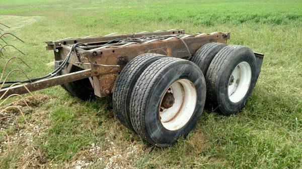

Trailer Axles 500 bucks
image is form above link
ya.. just skimming CL... and happened to remember about your thread. small little trailer. weld up some out riggers. add a tongue to it. and away you go.
though i would imagine you could find a better trailer out there. *shrugs* just looked nice and compact.
