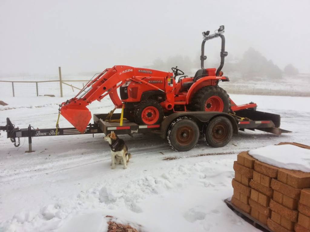

I wouldnt go for anything under 18'. My L3200 was about the same size & only fit my 16' tilting deck trailer because of the really long tongue. Even if 16' is enough to fit the machine on, you need some room to move it around & balance the hitch weight properly.
I'd go with a pair of 5k axles over 3k. It's better to have a bit excess capacity if needed than not enough. You are going to be looking at 3k lbs for the trailer itself then 3, maybe 3.5k for the machine. You'd be within 500-1000lbs of the limit. My tilting deck was overkill at 14klbs & heavy steel deck (made for a compact but heavy skidsteer I guess). It weighed 4k lbs.

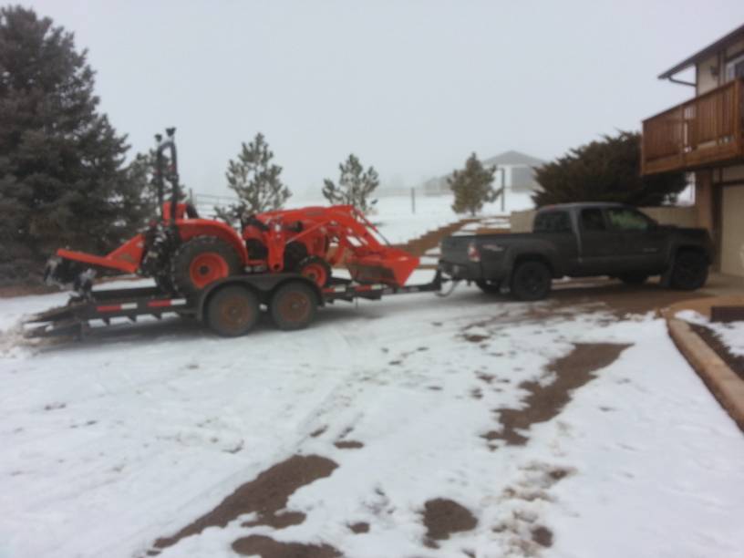

A f150 should be fine, they are rated 9-11k or so for towing. I pulled the 7k load in the photos with my Tacoma (rated to tow 6.5k). It did it, but was a bit sketchy. I promptly got a beater F250 for hauling. IMG_20140209_110007.jpegIMG_20140209_103755.jpeg
