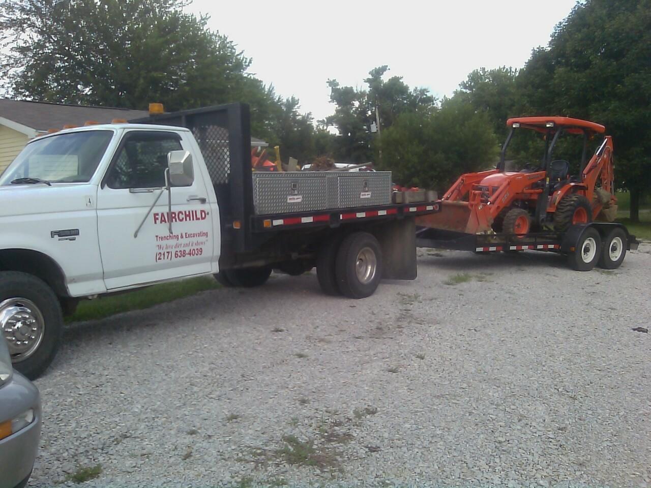

I use a 16 foot trailer with 2 6k axles most of the time and its a nice fit but no room for attachments but usually put them on the back of the truck its a 12 foot flat bed. My favorite is 30 foot gooseneck but its a little big to get around town with. We also haul it on a 22 foot 14,000 lbs with the trencher on the front and the tractor backed on but it is not balance very well. I would look at 14-16 dump with 6k axles then you would have best of both worlds.

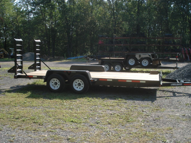

How about this Bri-Mar 18' 7K for $2,900 (these are usually 3,595 but I need to make room for winter!)
This is one of the top made trailer manufactures out there today.
Has brakes on all wheels.
5' stand up ramps with dog legs.
This is one of our best selling equipment trailers out there.

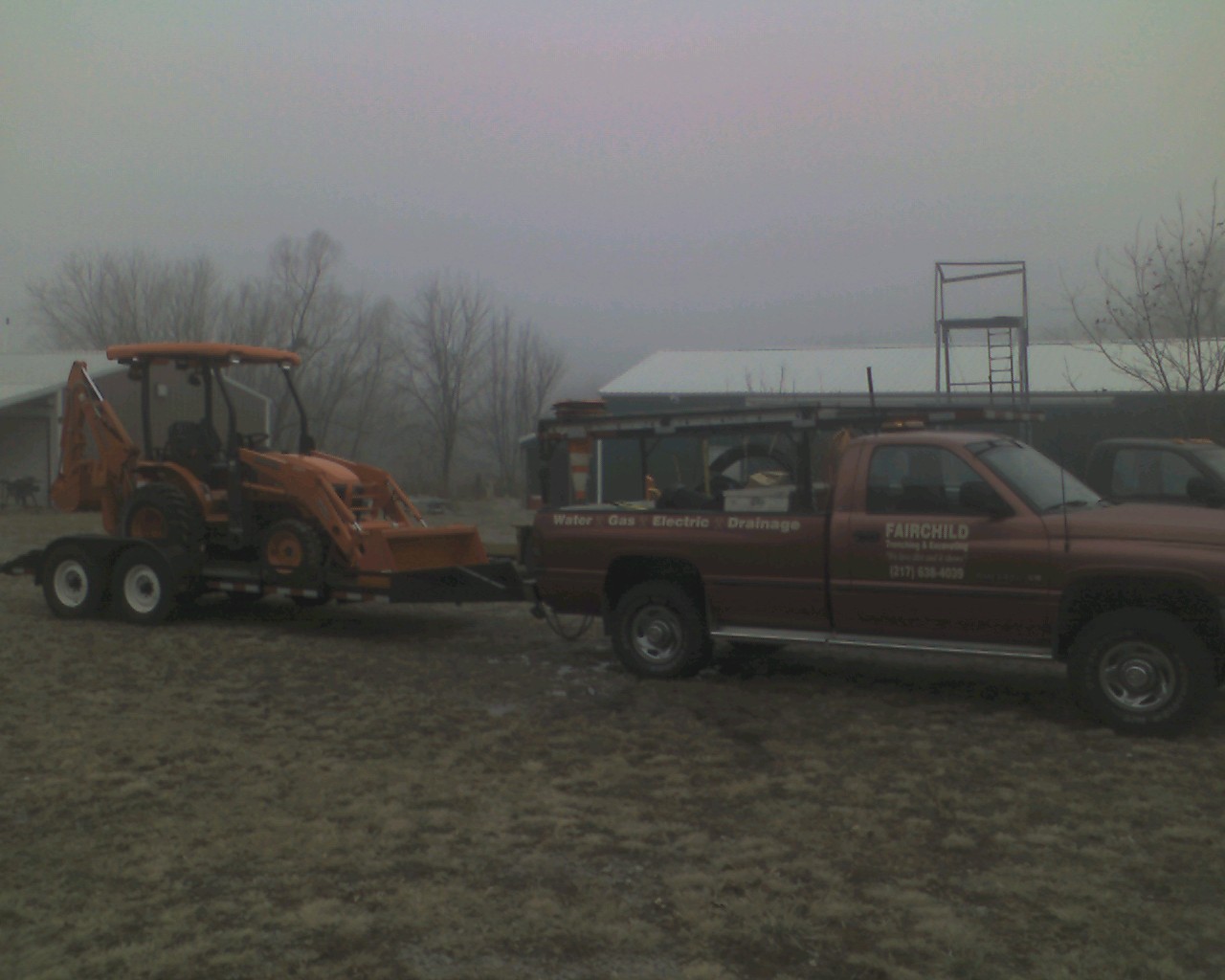

When you say a 14'-16' dump, do you mean a tilt bed trailer? Will it fit on a 14'?. When you transport, do you rest the BH bucket down on the trailer or is it ok to use the pin and hook locking devices installed on the tractor?
I would get a 14 foot dump bed not a tilt but they are pricey:thumbsup:. I could get mine on a 14 foot if that was all I had. I have had to haul it on a 12 foot but front bucket was hanging over and so was the backhoe.
On a 16' trailer I don't have room to put the hoe down on the trailer so I leave it secured on with the factory saftey holder, as I do on all the trailers come to think of it I have never put the hoe down on the trailer when hauling, and it get hauled daily and we have not had any issues yet.
With a anything 16 foot and under you will not have any room to adjust your weight and with a rough cut mower on the back it really hangs out there on the small trailers.
And yes you need brakes on all axles no matter what size trailer you put it on. Even pulling it with the F450 I need the trailer brakes to slow it down.

What size trailer is that in the picture?
Its a 16 foot with 2 6k axles with brakes on both. The axles are a little far to the back, so it puts pleanty of weight on the truck. Its more like a 75/25 instead of the normal 60/40. It weights 2300lbs or so and pulls great.
