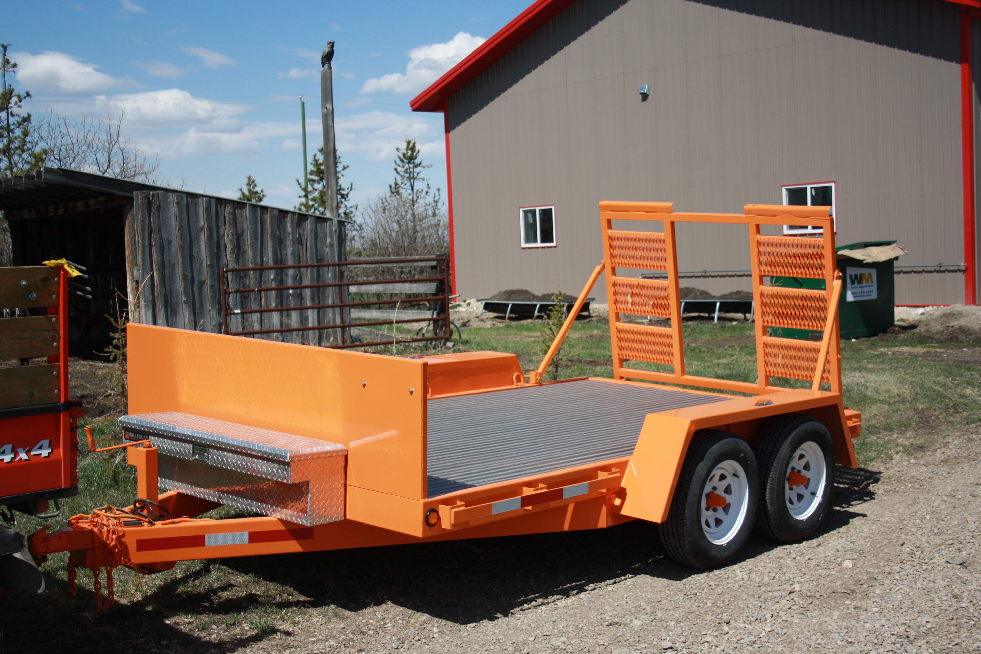

Wow Looks:thumbsup: NICE:thumbsup:

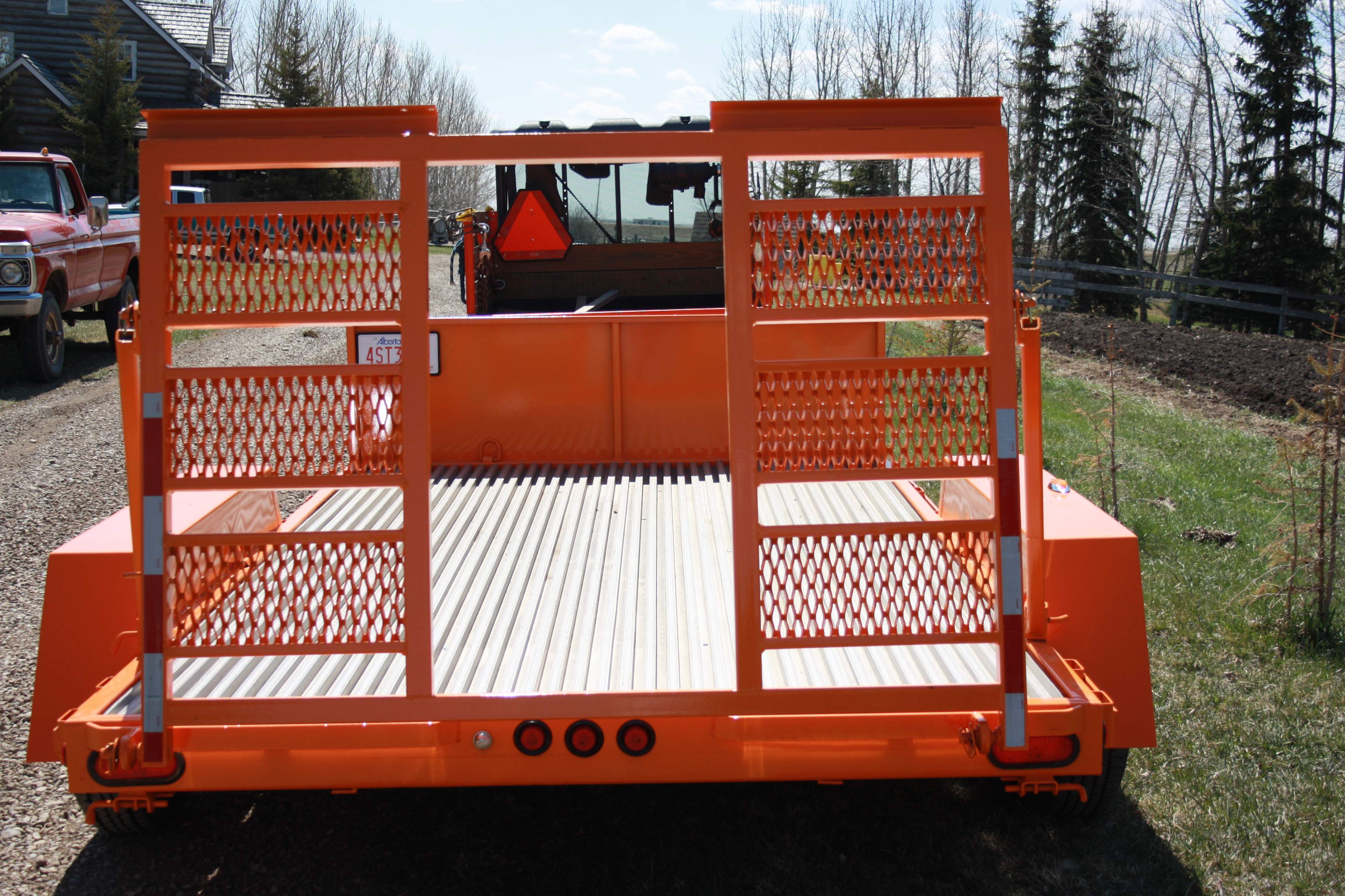

I did my part for re-cycling and managed to get a hold of some flooring from and old Hi-way van reefer trailer, the biggest part was separating it from the hardwood crossmembers and the urethane foam that was used to insulate and seal it all up, once that was cleaned up however it certainly went onto the trailer just fine, some heavy duty sheet metal deck screws and all done. It is very strong and will never rust or rot
Cheers
Roger
