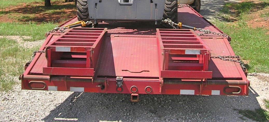

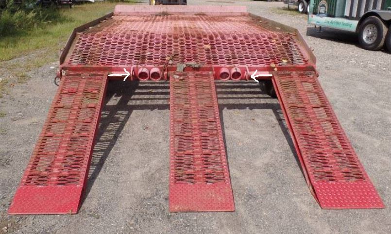

It would look like this but not a 50/50 ramp......View attachment 650826
I bet those ramps are only 3' wide, but that would be OK, I really dont need a ramp in the center 2'.
4' wide even better.
Thinking these ramps are made by each individual trailer manufacturer, they arent something you can buy from a catalog?

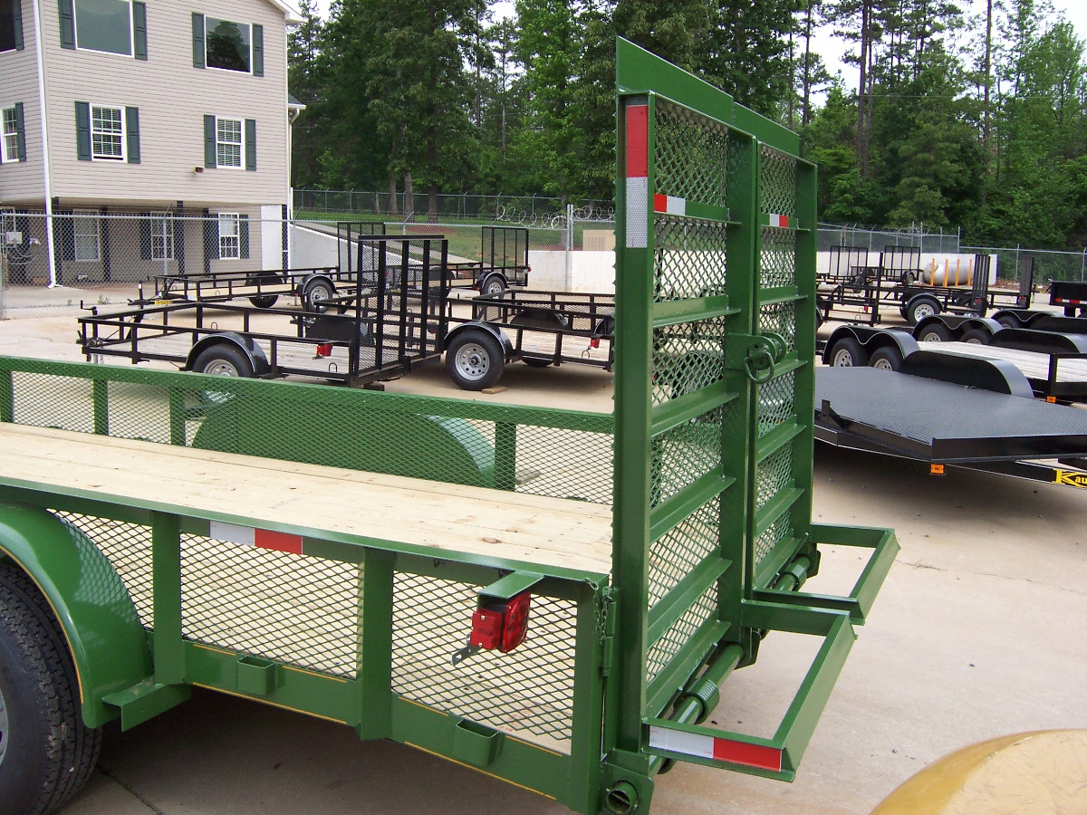

/ Trailer customization suggestions #54
A welding shop could copy the picture but they are from Kaufman Trailer I was going to by trailers from them..

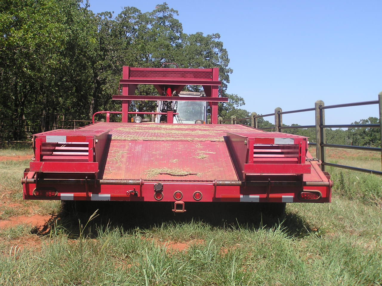

Hey dem skins is in good shape!
Gotta be a deck over for round bales, can’t have fenders and side railllllsssss!

The outside ramps will slide in a little closer:
The ramps on my trailer slide sideways a lot:
