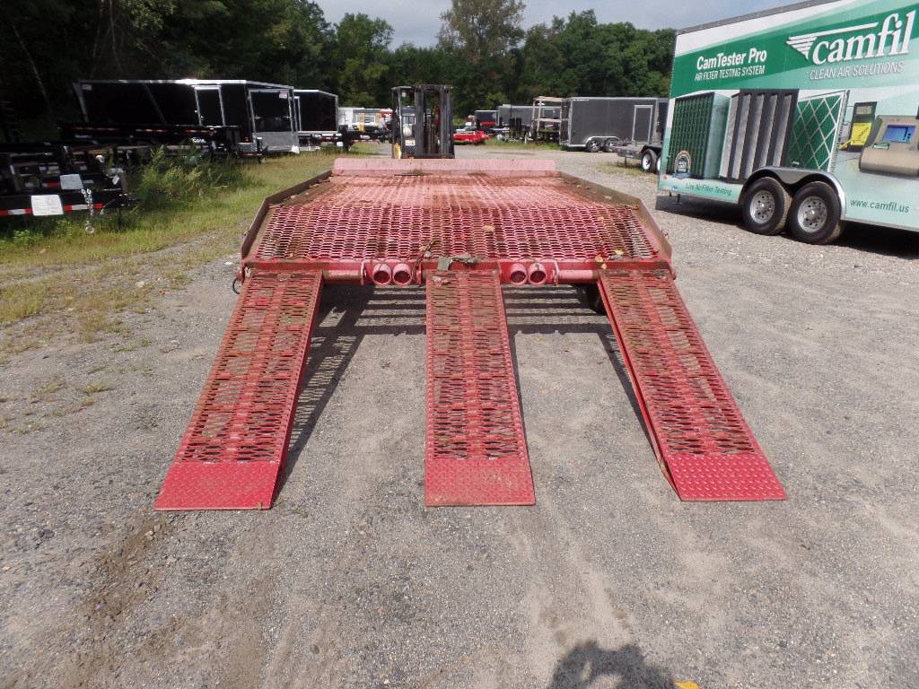

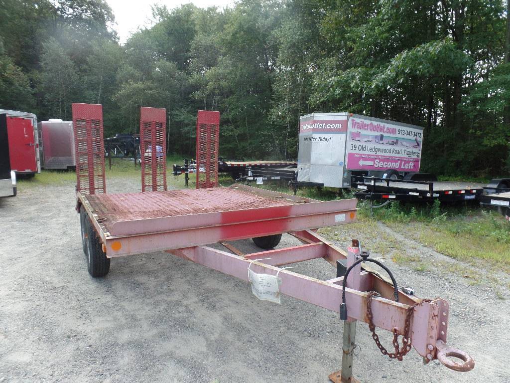

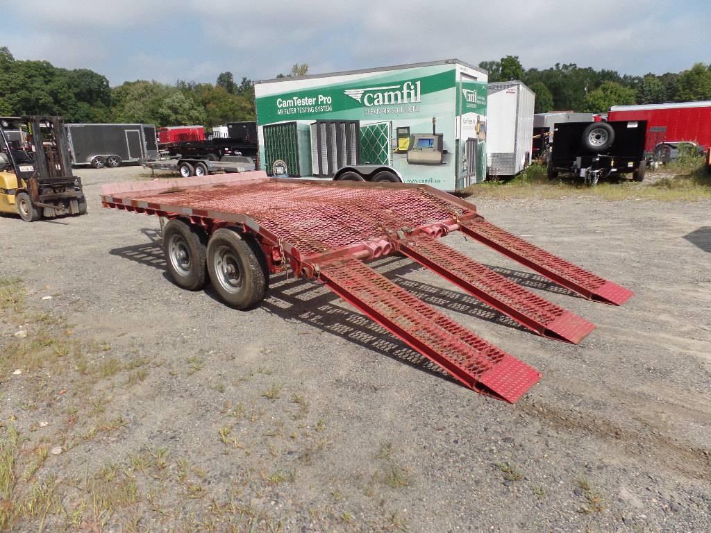

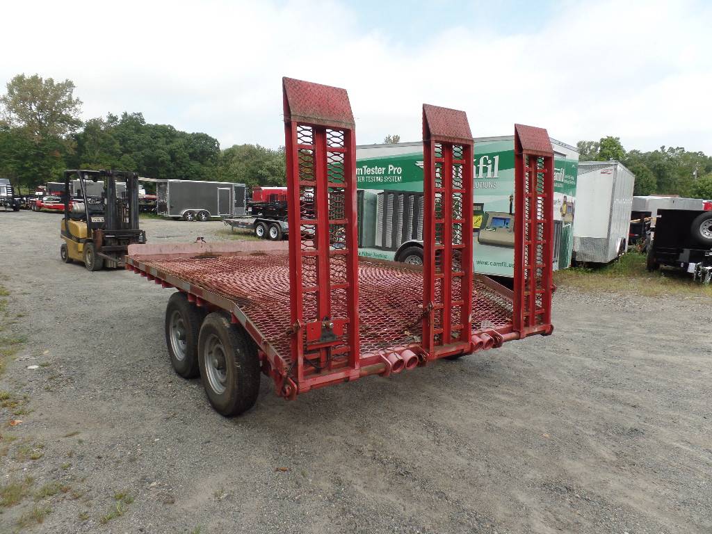

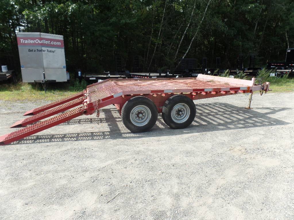

I want to buy this trailer.
It meets all my light duty needs (I think lol).
Its a short (10 foot flat and 2.5 foot beaver tail), bumper pull, deck over (101” wide) with nice GVWR (12,000 pounds). I like the steel deck. It looks stout.
The problem is the ramps. I like the ramps, but they dont narrow-in enough for my zero turn. UNLESS I want to load “ off center “ like on the right and center ramp, or left and center ramp.
I'd like to remove all 3 ramps and replace them with one, wide, reinforced ramp with a spring assist, because the ramp will get very heavy. Reason why is because I'd like to carry either my zero turn or a mid size skiddy on it. I can also carry 6 round bales for my smaller customer deliveries. OR, would one redesign the tube on which the ramps mount as a single clean tube which 2 of the ramps can be infinitely adjusted? (I would eliminate the center ramp)
1. Can such a ramp be purchased, or is it a custom fab job?
I can get the trailer for under 2K. The lights would also need to be moved and replaced, but that doesn't look difficult.
Suggestions?

You are probably going to need a much longer ramp than the current ramp length to get a zero turn mower up on that deckover.
/ Trailer customization suggestions #4
I would cut of the lights and ramps. Move lights to the outside of the rear and use the two wide ramps inside the new light locations. Sell the third ramp.

I would re evaluate the lights and then move the pivots for the outside ramps closer to the center so you could move them narrower.
It looks like the ramps are welded to the pivots. That’s another problem.
The dovetail peak is going to cause the problem not the ramps.

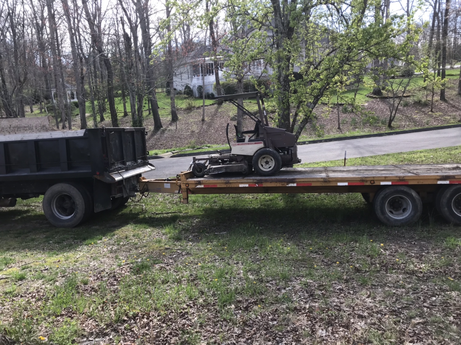

I’ve put my Grasshopper on my deck over. It’s steeper than I’d prefer, my backhoe drags the ground loading it. My deck drags across the dovetail and yours is quite a bit steeper. My ramps aren’t that long but my trailer has a 5’ dovetail.

Skinny wheel and a welder should sort the ramp issues, what I'd be concerned with is the load distribution with a skidsteer. When one is backed on there, the center of load is going to be 2.5 - 3 feet ahead of the front axle.

If you're going to make one big ramp, I would work on connecting all three ramps together with pieces of angle and then run a continuous strip of flat across the top and bottom in at least 4 places.
You have enough clearance underneath, for a lift assist spring, I would look at the spring style that uses a trailer spring mounted underneath the trailer and sticks out the back a little bit to provide spring lift assist for the ramps.
Then you don't have to mess with the lights or the mounting brackets and you can still have something that is the full width of the trailer driving up the ramps.
