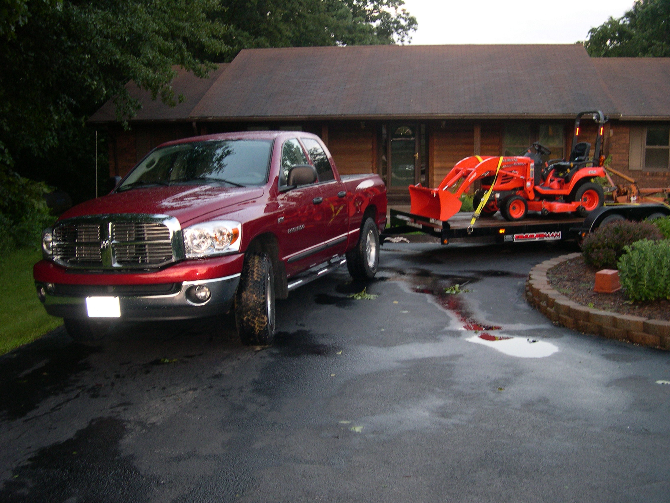

With my FEL and BH on BX, it takes up the WHOLE 16ft trailer. With your Honda being able to tow 4500, and maybe be able to add distributing bars, you can add another 200-500lbs to your total towing weight- (but not legally if cop ever pull you over and go by door sticker weight) . My s10 blazer is rated at 5k and with BX combo with trailer is a nice match. Just make sure you don't add alot of implement or materials to tow with your Honda so you can stay under the 4500lb limit.
Since you have a very light duty truck, you WILL NEED trailer brakes to help stopping. With Bx24+loader=2027lbs plus weight of trailer let's say 1k plus feul and chains you are going to be just right at the tow weight of your Honda. They do have 10,14, dual Axel trailers if you feel 16 is too much. I suggest you go out and attach your FEL and measure from tip of bucket to back of BX and maybe add your implements . You are going to find that 10ft is too small- 14 is the smallest size you should go with, and 16 is good average for versatility.

When I went to buy my trailer I thought I wanted a 14'. Seller had 16's in stock and said he'd get me a 14' (dual axle by the way). I asked price of each. He said same price for either one. Bought the 16' and glad I did because I ended up trading to bigger size tractor and now back down to smaller but same trailer has worked through all my trades. Brakes are better and safer, I'm not denying that. If you have doubts or worries, get the brakes but i don't have brakes on mine and have never had a problem. Just my opinion for those that say brakes are required (not speaking about legal requirements of your state) to be able to use the trailer to transport your tractor. A used dual axle 16' with brakes can probably be bought for about the same price as a new 16' dual axle without brakes if money is an issue but you just have to have brakes. Money no issue, get new, 16' dual axle with brakes.

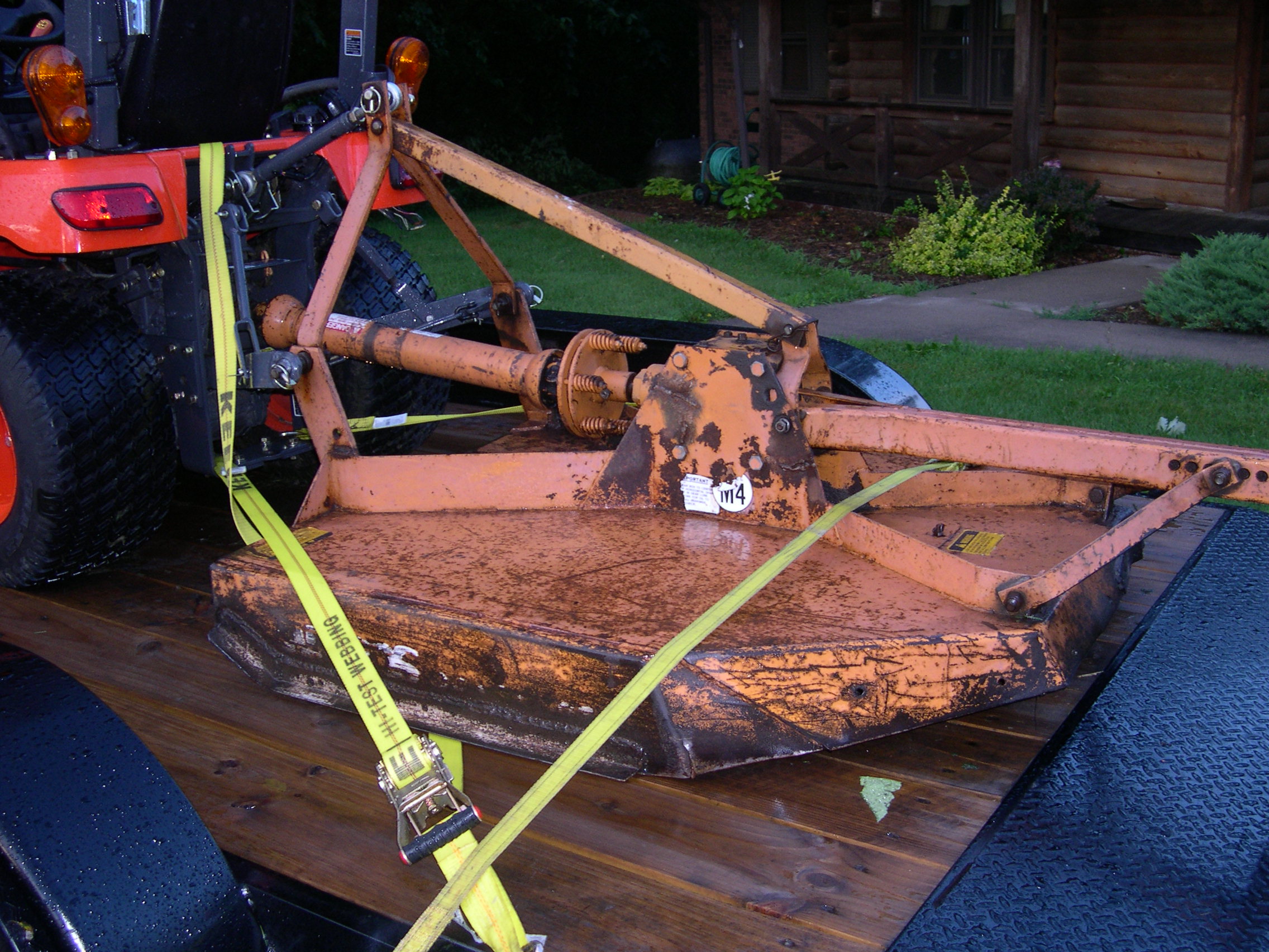

I just measured and tractor with FEL is 11 feet, so 12 feet is a requirement if i want to move the FEL around. 13 feet or 14 is needed if i want to moved the chipper as well and 16 feet if I wanted the rear blade moved attached.
So, I guess this project got bigger. :)

9*I use a single axle 6x12 Carry On trailer most of the time for my BX though I have a couple of dual axle sixteen footers and a car hauler.
9*You ought to be using the 16 footers.
Almost forgot.
10*My nephew has a BX2360 and uses my 16' dual axle trailer to pull his and he has a Toyota SUV.

For my Massey GC2600, which I figured I might trailer a few times a year, I was in the same predicament. Single or double axle, aluminum or steel. Steel was quickly ruled out, I've yet seen one after a few years which didn't look like a bucket of rust. I ended up with all all aluminum landscape/utility 6x12 (aluminum floor as well) with a single 3,000 pound axle. The trailer tare is only 600 pounds so can carry about the same as a 3500# axle steel trailer and much easier to move around the yard by hand if need be (the same size steel trailer weighs in at around 1100#'s). I worried a little about the floor getting banged up with rocks but think I'll get a rubber mat for it which will help with that.
13*My tractor with loader weighs around 2100#, on the trailer the tires are barely deflecting and it tows excellent plus there's room for more weight such as my boxblade or mower deck.
