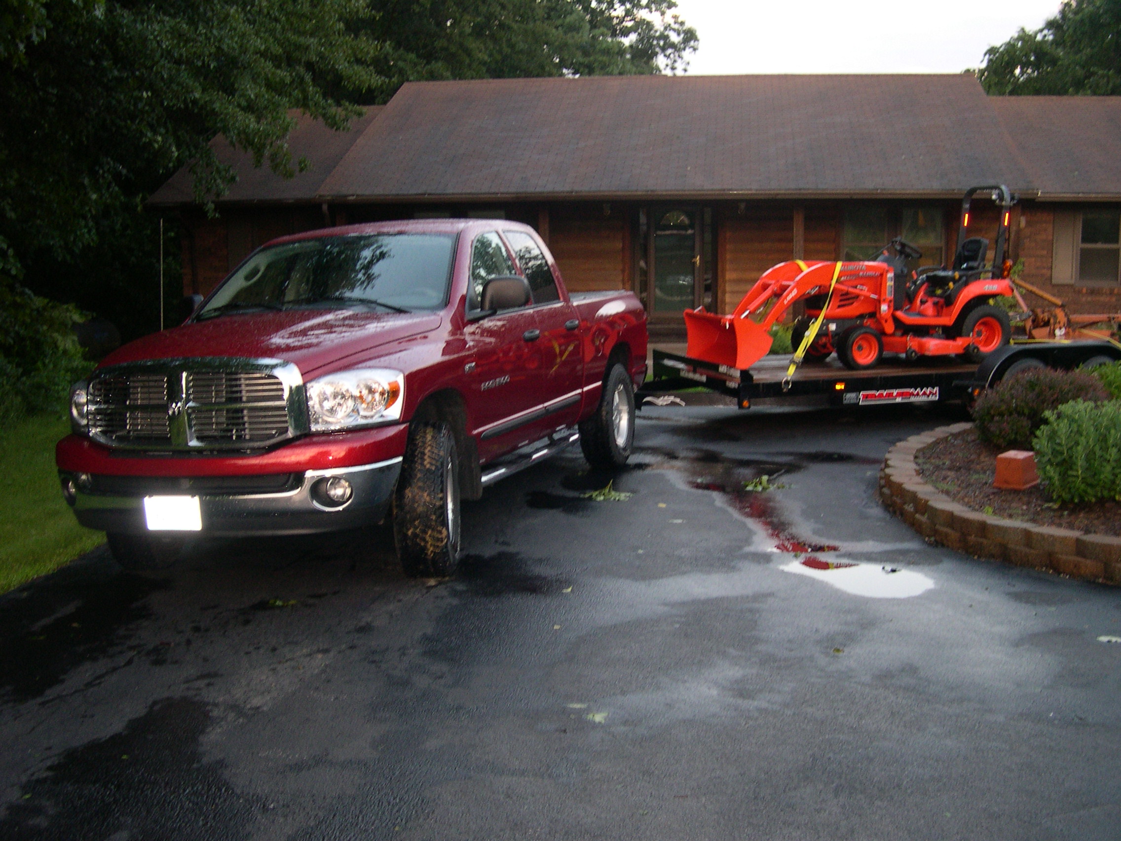

I also have a car hauler type trailer for my BX. Its a 16' deck with a 2' dovetail. With just the BX on it, it looks huge. With the FEL on it and a brush hog on the back, it fills it up in a hurry. There might be other things you could use the trailer for? The biggest problem with a bigger trailer is do you have a place to store it and can you turn it around on your property.

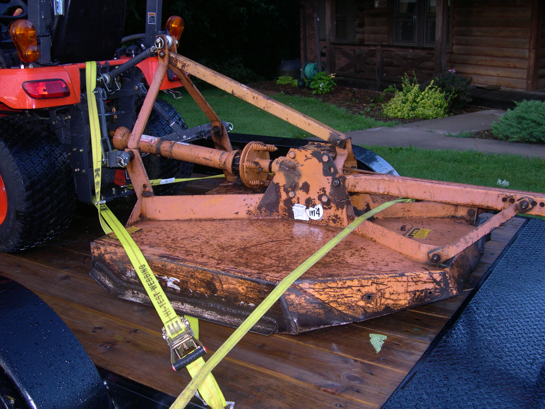

Here is a couple of pictures of my BX on my trailer with the FEL and brush hog attached. Not great pictures, but you can see how close the hog is to hanging off the back end. The dove tail on mine is metal, and I don't like it, very slippery.
