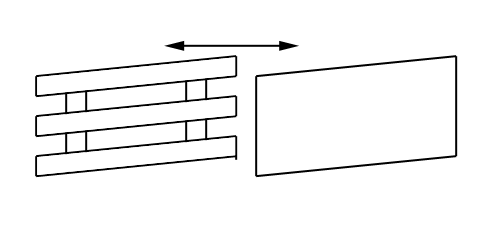

In another discussion I was looking for a trailer. In the end I have decided that I would be better off if I just build it myself. I'm going to use a Harbor Freight 1720# frame. There are many examples of doing this out there so I have a lot of inspiration. Also a lot of tips on issues and things that need to be improved like the grounding issues.
Anyway, I am going to build railings using cedar because it is lighter weight than other materials but still sturdy, unless someone can tell me of something lighter I can use that will still be sturdy. The railings will be 32 inches high form the trailer bed because I am going to use plywood to enclose it when I need to haul something like stone. A single sheet of plywood will cut nicely to fit this height.
Here's the part where I am looking for ideas...
I would like to be able to easily and quickly attach and detach the plywood from the railings.
I'm not exactly sure how to accomplish this. I have some ideas on how this might be done but I want to see what others think. I could do it with carriage bolts but that would be a real pita if I wanted to take them off.
The panels would need to attach securely so that they could not come loose and should also be tight enough to help prevent any warping and yet be attached in a way that would let me "unhook" them easily. It would also be nice if it didn't look like crap.
I'm thinking of some kind of clamp or bracket but can't seem to find anything... more than likely because I'd need to know what it would be called to find it.
Any ideas?

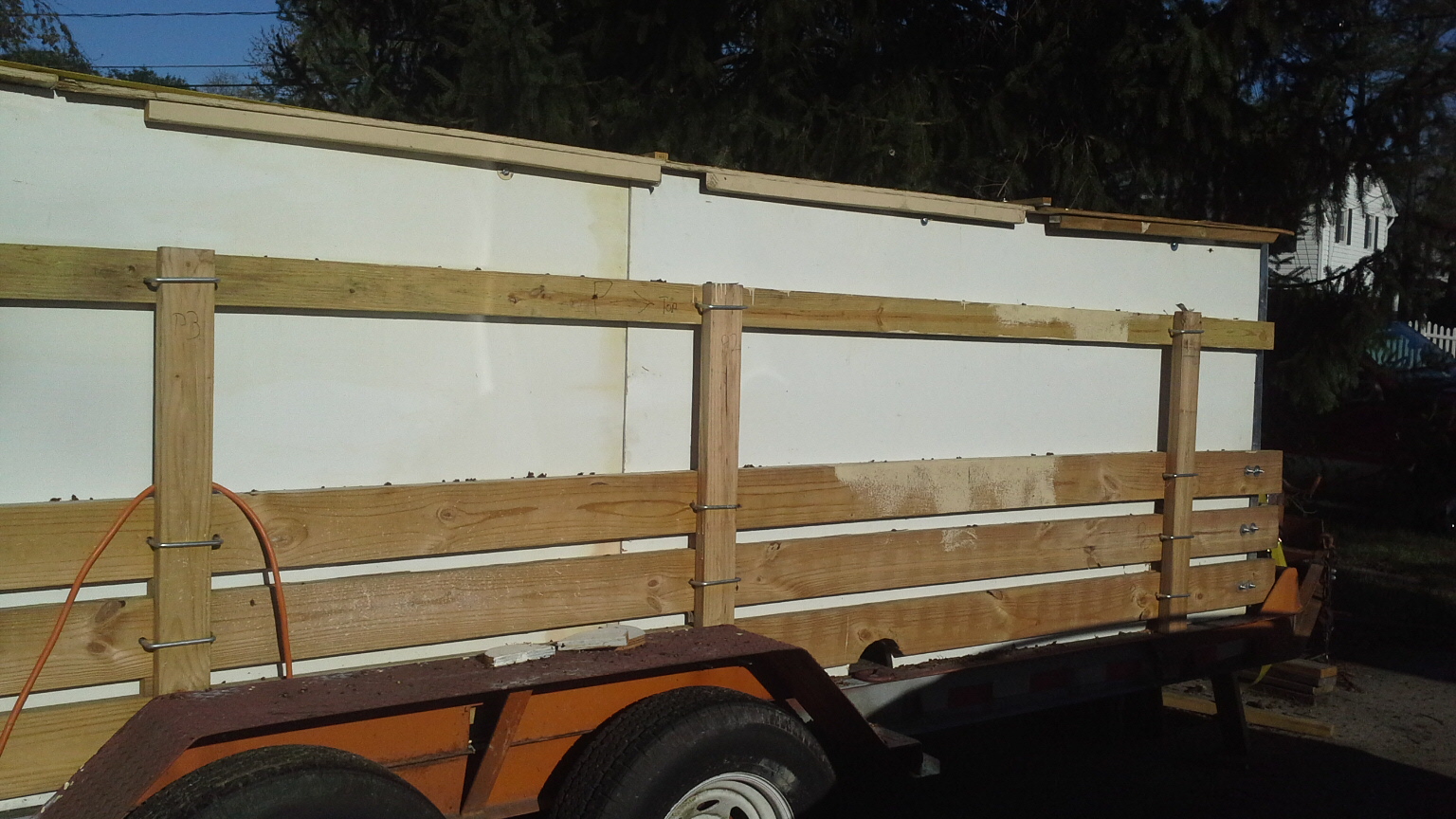

For fastening Plywood to slats I've used flat ubolts. flat ubolt
And for assembly/disassembly I use an extra deep 7/16 socket on my DeWalt 20vMax drill.

Going to be honest here, the only reason I was going to make the sides 32 inches was because a 4x8 sheet of plywood would be extremely easy to cut up to fit the size of the trailer.
The comment by @jaxs really made me think about how deep this thing really needs to be. I seriously doubt that I will ever need that kind of depth. I can just make the sides a lot shorter. A single 1x12 board would give me plenty of depth to haul anything that I'm likely to haul. Means less materials and less weight reducing the load capacity of the trailer.
If I ever need something taller I can simply build a second set of rails.
This is why I posted my question, to get someone to make me think about things that I had not thought about.
