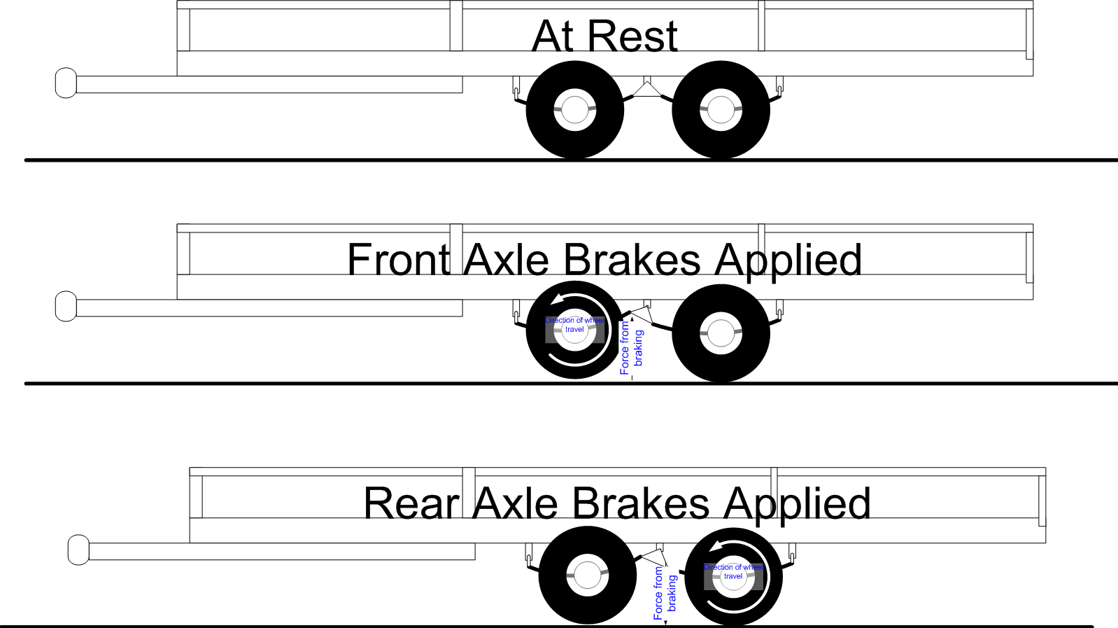

Attached is a diagram of a dual axle trailer at rest, with front brakes applied and with rear brakes applied, it shows the forces applied to the equalizer and the result of said forces.

I agree with you on the not all loads needing brakes, but I disagree on the importance of different equalizers (as long as the front and back arms are the same length), as I understand it (and someone correct me if I missed something) if a trailer has dual axles with leaf springs and an equalizer between them, the weight on both axles will the the same when the trailer is loaded and stopped, if there is more weight on the front the front axle will be pushed down more than the back, this will cause the front spring to push up on the front of the equalizer which will push down on the back of the equalizer, causing the back spring (and by extension the back axle) to take an equal share of the weight, this continues until you run out of travel on the equalizer at which point the load becomes unbalanced.
Aaron Z
Can you perhaps use those same drawings for dual axle with brakes on all wheels, and explain which axle will cause the brakes to grab and lock, and why? My thoughts have been that the equalizers serve to equalize or compensate for irregular surfaces, such as a pot hole or a rock or bump, etc. In the normal trailer situation, the front axle already has more weighI on it due to the 10% tongue weight, and I am thinking that the load shifts fwd, even more in a braking situation. How much weight is shifted to the back axle is up to conjecture. No one seems to know. It would be neat to see a trailer being pulled down the road with a video camera looking at the wheels and springs to actually see what happens to the wheels, when a hard braking situation occurs, and which set of brakes will lock up.
The question might be is. if the equalizers are designed to equalize the load on the frame, do they also equalizer the braking force on the axles. Some people say some grab, and others say never.
/ Trailer axle/tire question #49
Aaron Z
Ok - from this picture, it would explain the front axel lockup esp when its unladen and said trailer has WD bars installed. The rear axel is the same height as front so when the braking force is applied, it appears the front rotates and LIFTS the front axel up just a hair and it would seem it locks up due to the fact there is less pressure on the road. Now this doesnt seem to happen when loaded. perhaps there should have been some sort of a cutoff switch to ONE of the axels brakes so its doesnt seem to lock up when its in unladen mode. Why do you think some manufacters put brakes up front? 80/20 weight rule and the torsion of the equalizer ? ( looks like we gonna argue on this till we are blue in the face.:rolleyes:)
it will act the same as the drawing with rear brakes, but the effect will be more pronounced as both axles will be moving in harmony (the front of the equalizer being pushed up by the front spring and the back being pushed down by the back spring)
they cannot equalize braking force on the axles, the diagrams I did above show that when the brakes are applied on either or both axles the front axle will be lighter than the rear one, the is due to the face that the equalizer is a lever, and it will act as a lever until it breaks.
as for grabbing or not that depends on how the brakes are adjusted (tensioned), where your brake controller is set (how much juice you are sending to the magnets) and how good the wiring to the brakes is.
Aaron Z

Aaron, Thanks, good explanation.
My thinking is that if the front axle is lighter due to spring action, and if the same current is sent to all electro magnets, then the axle with the lighter load will grab first because of the least resistance. So a question might be how do you set the brakes for the best braking force. If you set it just before lockup, which would probably the front, then the rear brakes will not be set correctly. You would think someone would have come up with a variable resistor in the front axle brakes , adjusted to match the braking force of the rear brakes, or a pulsed brake system similar to anti-lock brakes.
