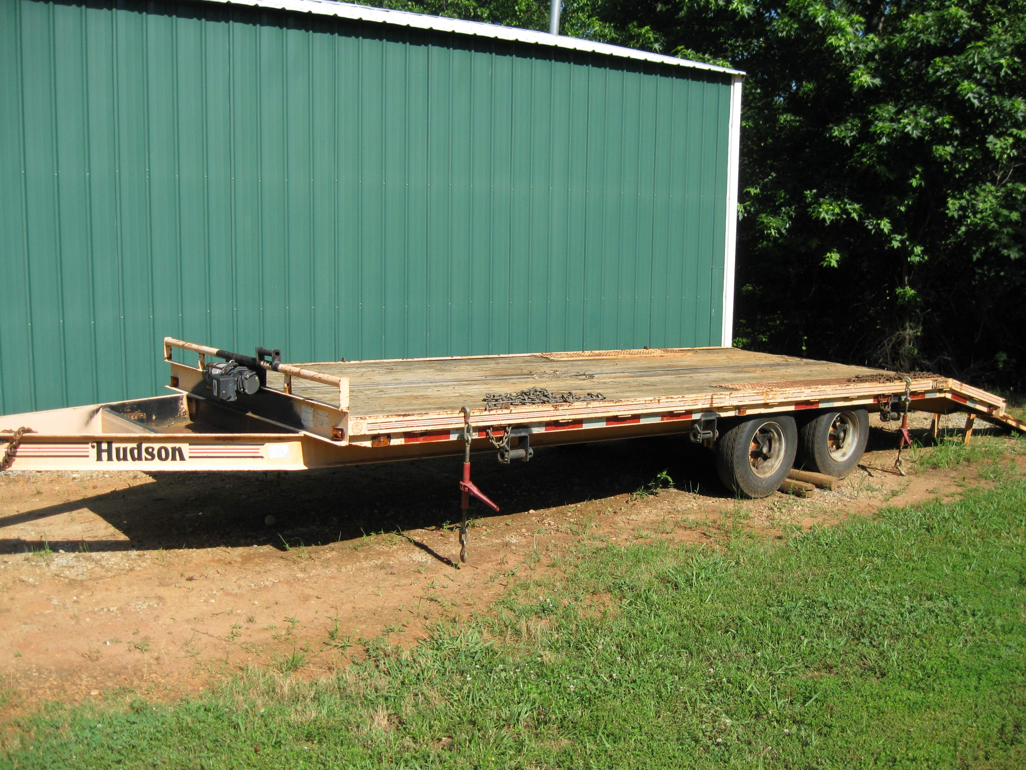

My experience is with slipper type springs and the 8-14.5 bias tires. I have not had any problems in the 12 years owning this trailer. I estimate the trailer has at least 35k miles on it and the usual load weighs around 12k pounds.
:eek: According to most everyone here, you've got a horrible problem with your trailer. The dreaded "mobile home axles". How in the world does your setup even work ? :p
