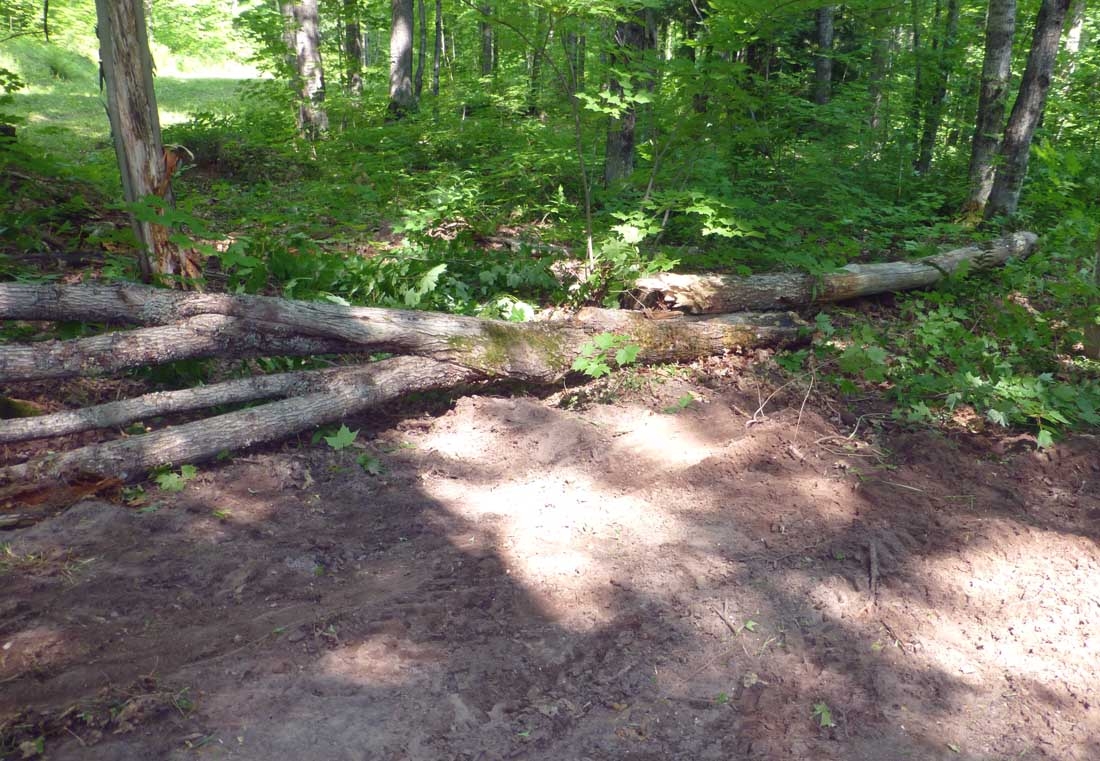

No I don't. I thought I'd need to winch some logs around but I didn't need to. Seems I could have doubled the towing effort with this machine from what I did today. View attachment 811164
Like everything, the cost adds up, but a couple of snatch blocks or recovery rings with some rope would make it possible to pull some trees like these off into the woods while keeping your UTV firmly on the trail.
   / trail clearing technique and tools #986
That makes sense. It's not that you need more pulling power, but you can redirect the pull.

It's not something I have typically done myself in the past, but I'm developing an appreciation for the guys who have figured out how to move logs in areas of very limited access using rope and pulley setups. I have a trail that is blocked by downed trees. There's no way to access it safely with a tractor, but now I'm thinking I may be able to get them off the trail using a pulley setup to create mechanical advantage.

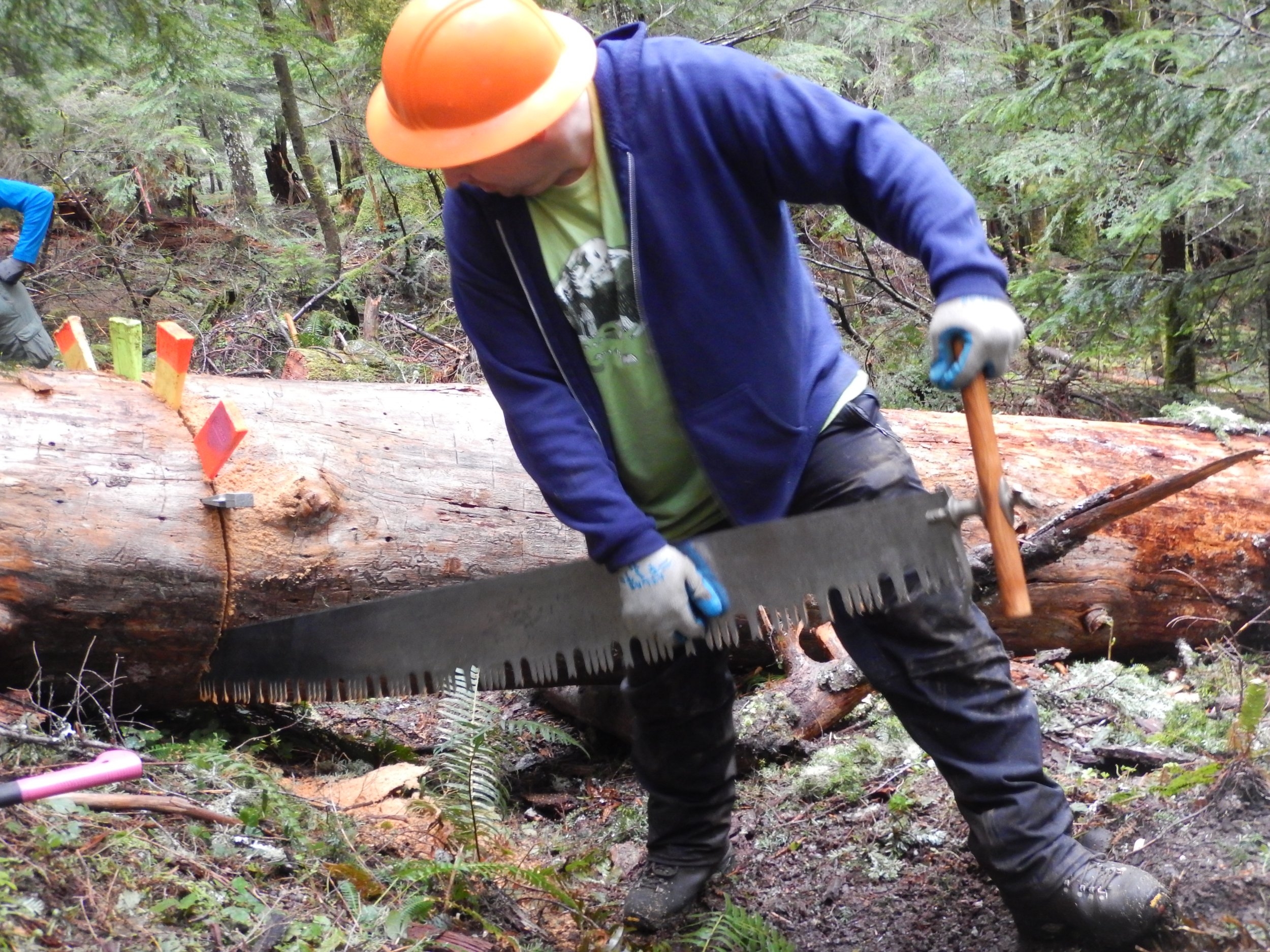

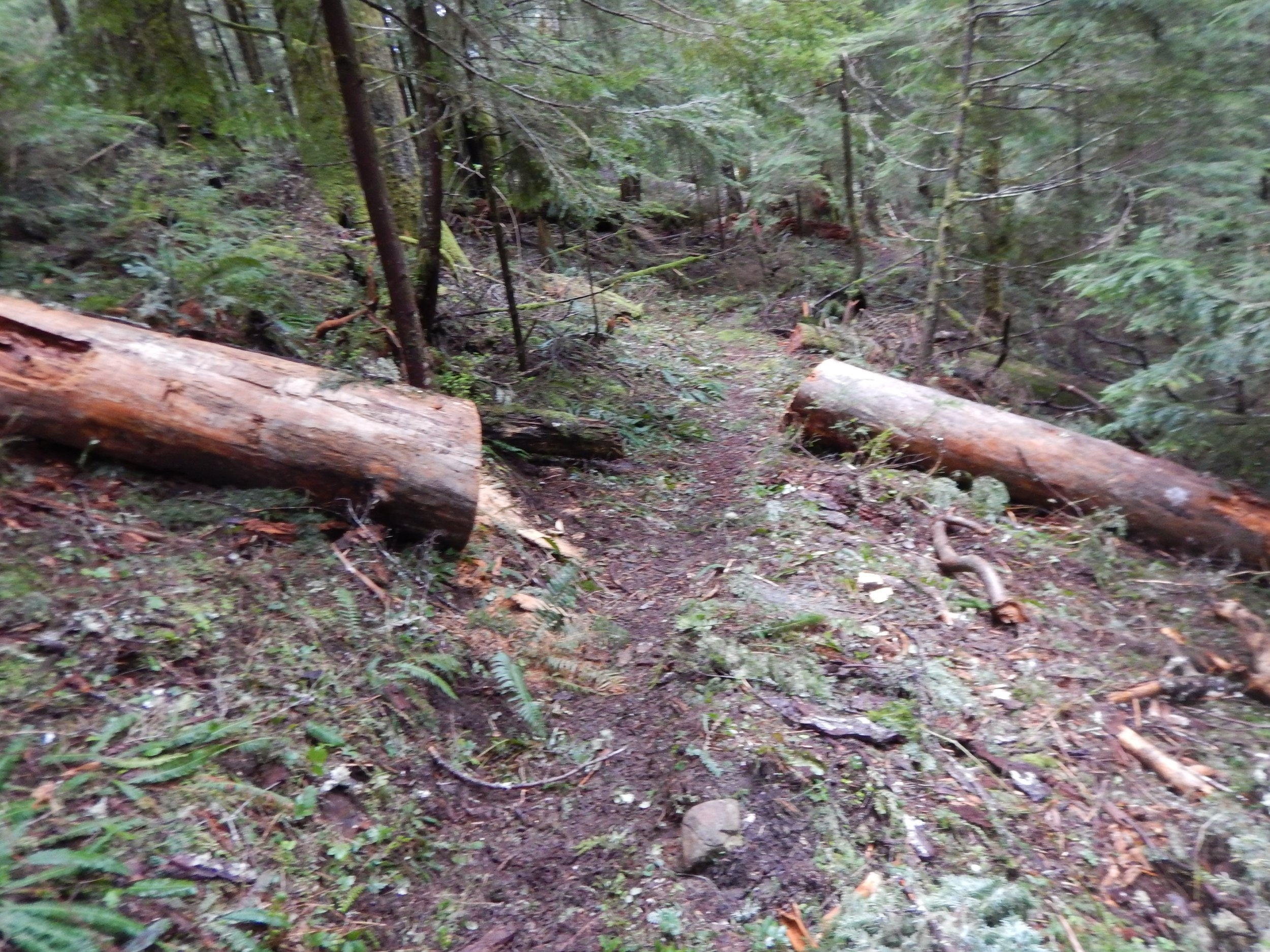

Earlier in this thread I mentioned some work I helped with on trails in Wilderness areas in the Cascade range where only human powered equipment was allowed. A technique they used to roll massive old growth logs off the trails was to take some webbing (probably 30-50 feet?) and wrap it around the logs. Probably 3-4 wraps over top of each other so it would bind on itself. Then, from a safe position, they would get 2-3 people on the tail end of the strap and pull on it like a pull cord of a lawnmower. This would start the log rolling and move it right off the trail. It helps if you can use slope/gravity to your advantage to get it rolling.
One needs to be very careful when doing this of course. They guy coordinating the work would sit for 5+ min and just look at the situation before doing anything. He was looking for hazards, the way a tree might twist or pop as it was being cut, escape routes, overhead dangers, etc. "Look up, Look down, look all around" was his mantra. Then he would set up the situation (be it a cut of a log, or movement of a log, etc). Then he would sit again and assess the situation one last time before acting.
We were moving logs 3-4 feet thick and 10+ feet long with 100% human power with this technique.
In the photo below, we made one cut on the log on the uphill side, then used the webbing technique to roll the downhill side away and clear of the trail.
