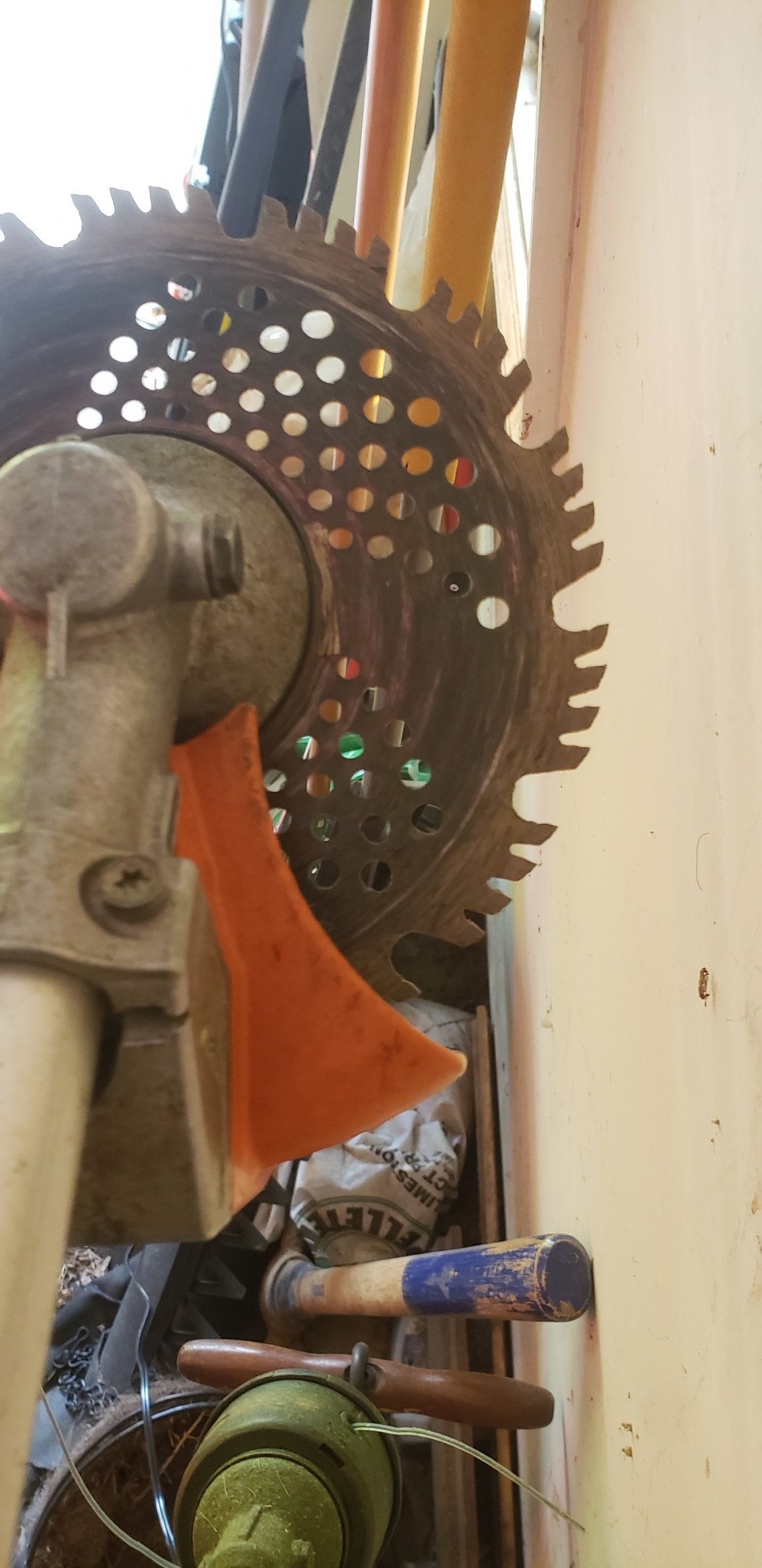

New accessorie or working attachments for the Stihl KM 131R kombi. Please note, I've not yet got to use this steel saw like end. As stated earlier, this will be sharpened with the same round files as our 3/8 chains.View attachment 799815View attachment 799816
Is it on down-side-up? I have it in my head that these spin counterclockwise when viewed from this angle.

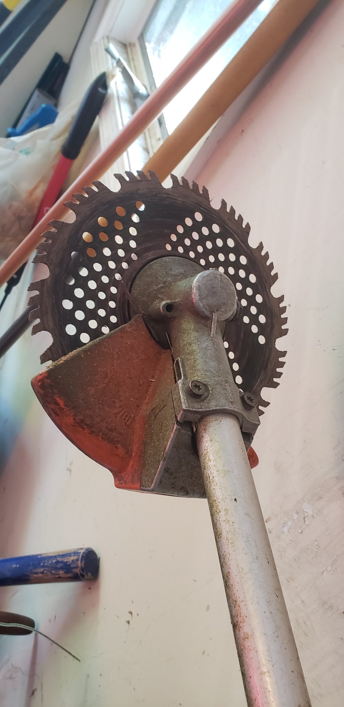

Smaller metal brushcutting shield on FS110

That large grass cutting shield will take a beating plowing through brush with a metal blade. The blade itself has an arrow for direction of rotation. In your second picture, note that your teeth are facing the opposite direction from the picture kenmbz posted.
Seems that some pictures get reversed when posted. Don't ask me why. Ken's blade looks backwards to me.
