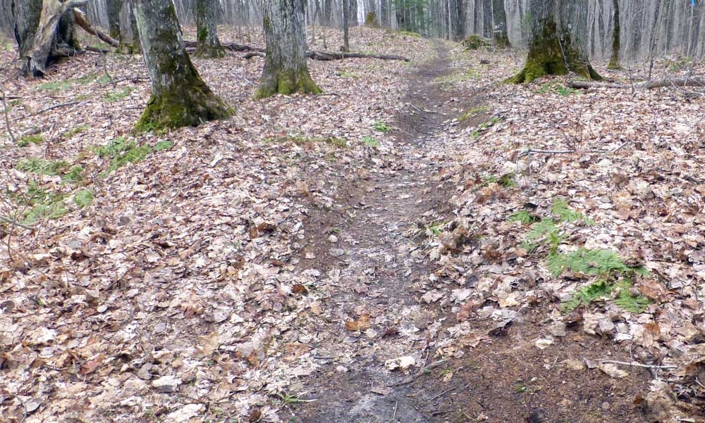

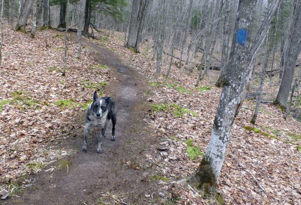

Yesterday I blew off our trails. Before and after pics or forwards and backwards view. :p

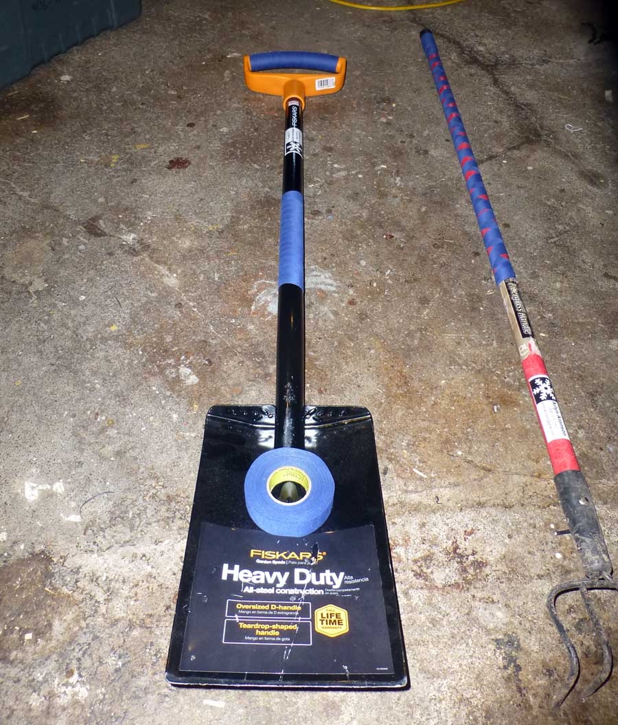

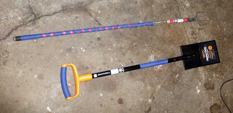

For anyone who looses tools, we ID ours and install blue hockey stick tape on help them stand out. Blue is not a natural color in nature and this tape makes them easier to hold onto. Gee I love this stuff! (y) You can't see these very well but we have a little ID stickers with our name and number on it. People have returned tool to us so we put these on everything.
