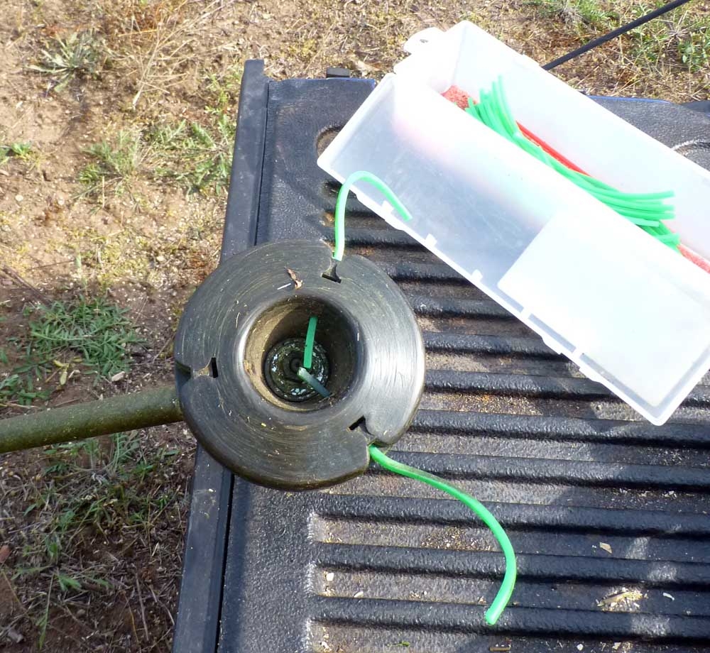

OK, I've tested a bunch of wet string against dry ones while in the same head and they don't hold up any better.. In fact, the wet ones are breaking off about twice as fast as the dry one. That means I'd replace the wet stored ones twice, while the dry one was still in use. By wet, they've been under water for days before use. Oh well.

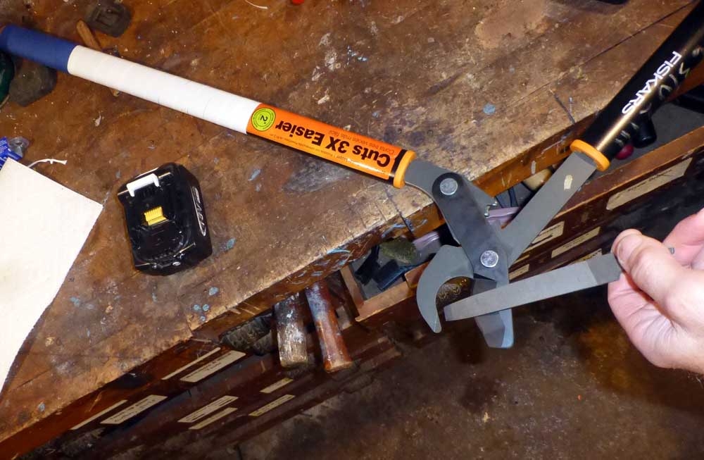

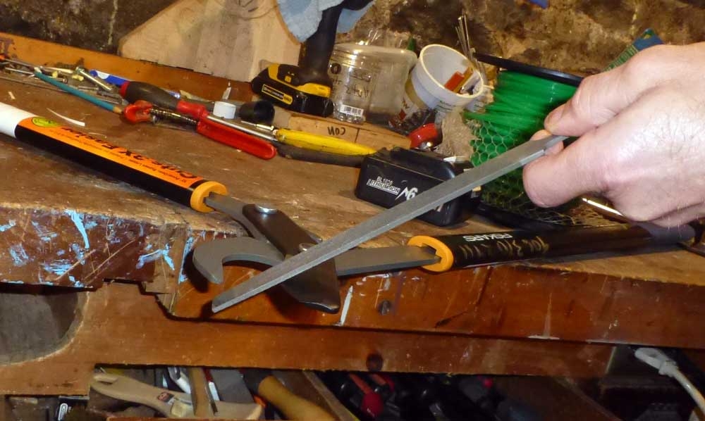

As promised earlier, here is how to sharpen by-pass loppers via ******* file. We were at some conference years ago and was taught this. Open the lopper up far and lay them on a counter as seen in the below photo.
Take your file and file downwards matching the original bevel angle. I hold one handle down with my other hand.
ya, its that simple. We oil the pivots and make sure the blade bolts are snug. These will cut like new after that.

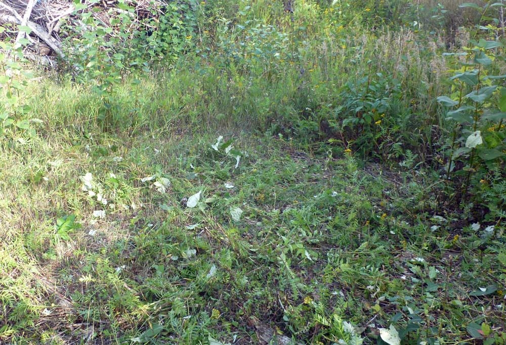

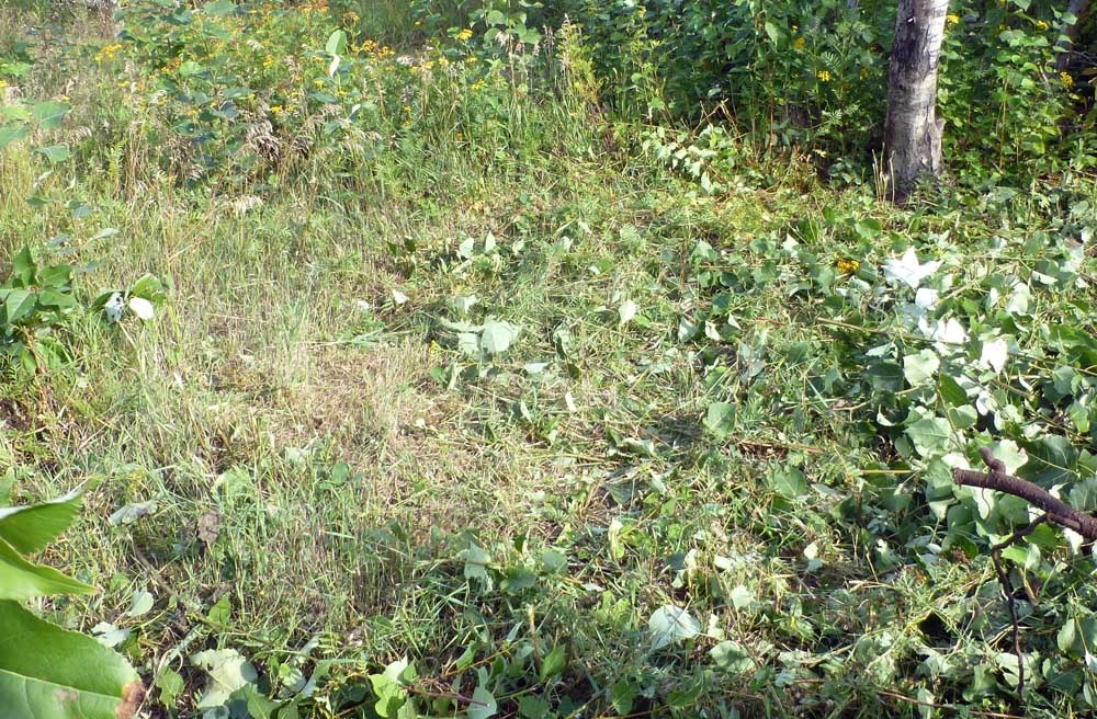

Here is the brush/grass I was cutting for the string test. In the top photo is the string head by Echo we use which comes with adapters for different shaft sizes and should fit whatever machine you have. Yes there are tree shots coming up in it that .155 string will take out to a certain point anyway. This is what we are normally cutting here..
