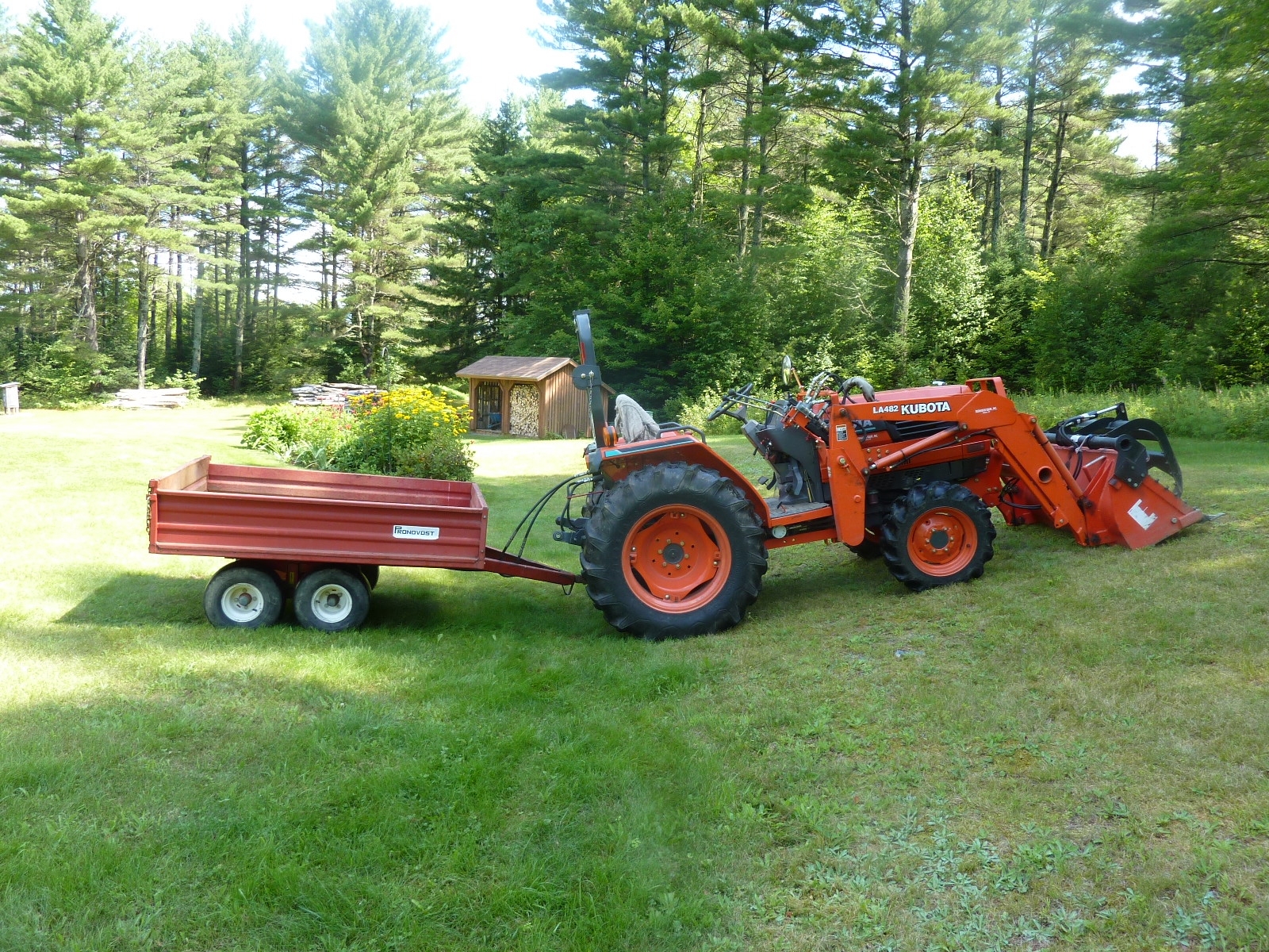

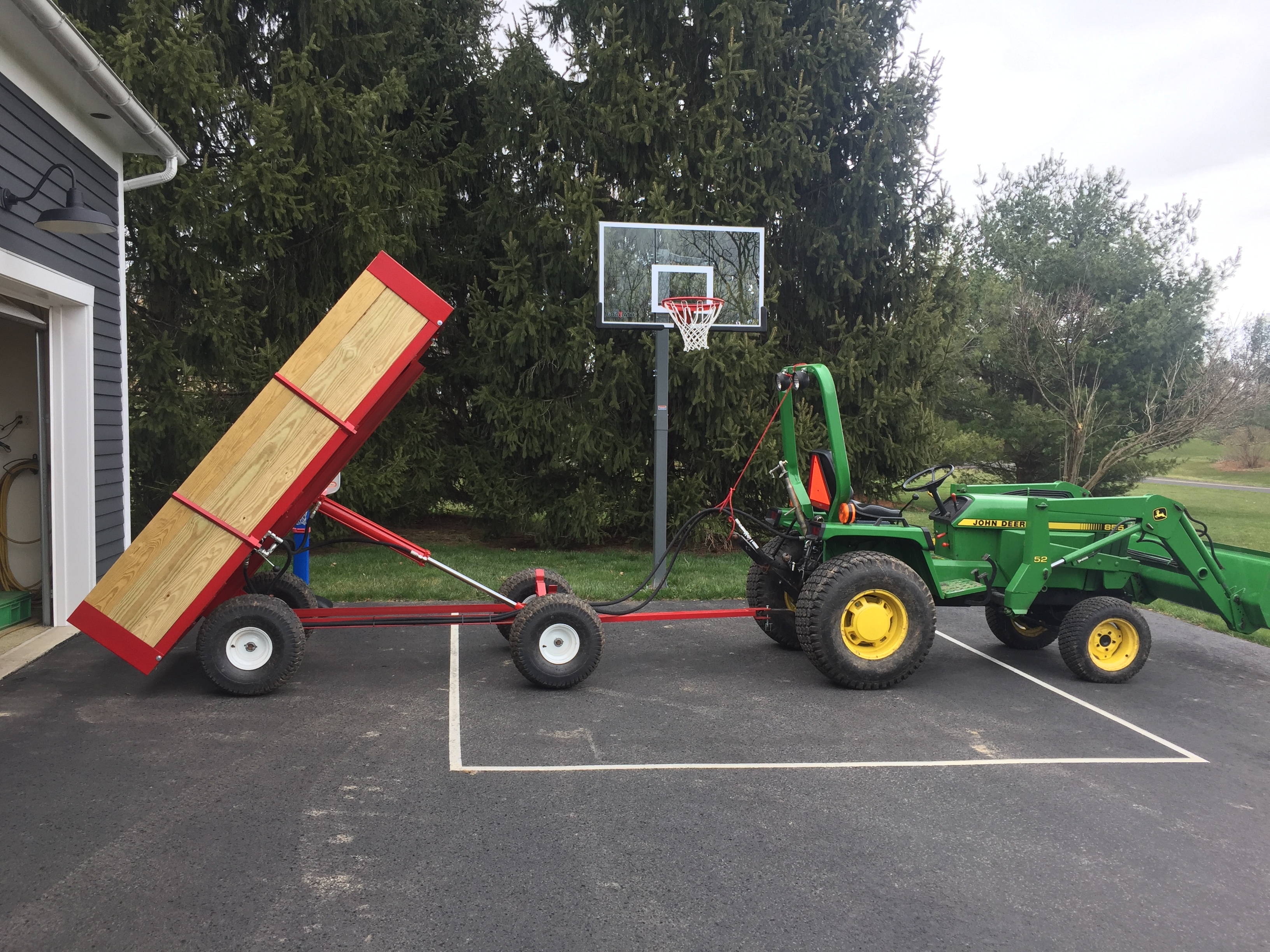

What trailer is that? or did you make it yourself?
They're made by Country Manufacturing, and I believe that particular model is rated 2 tons.

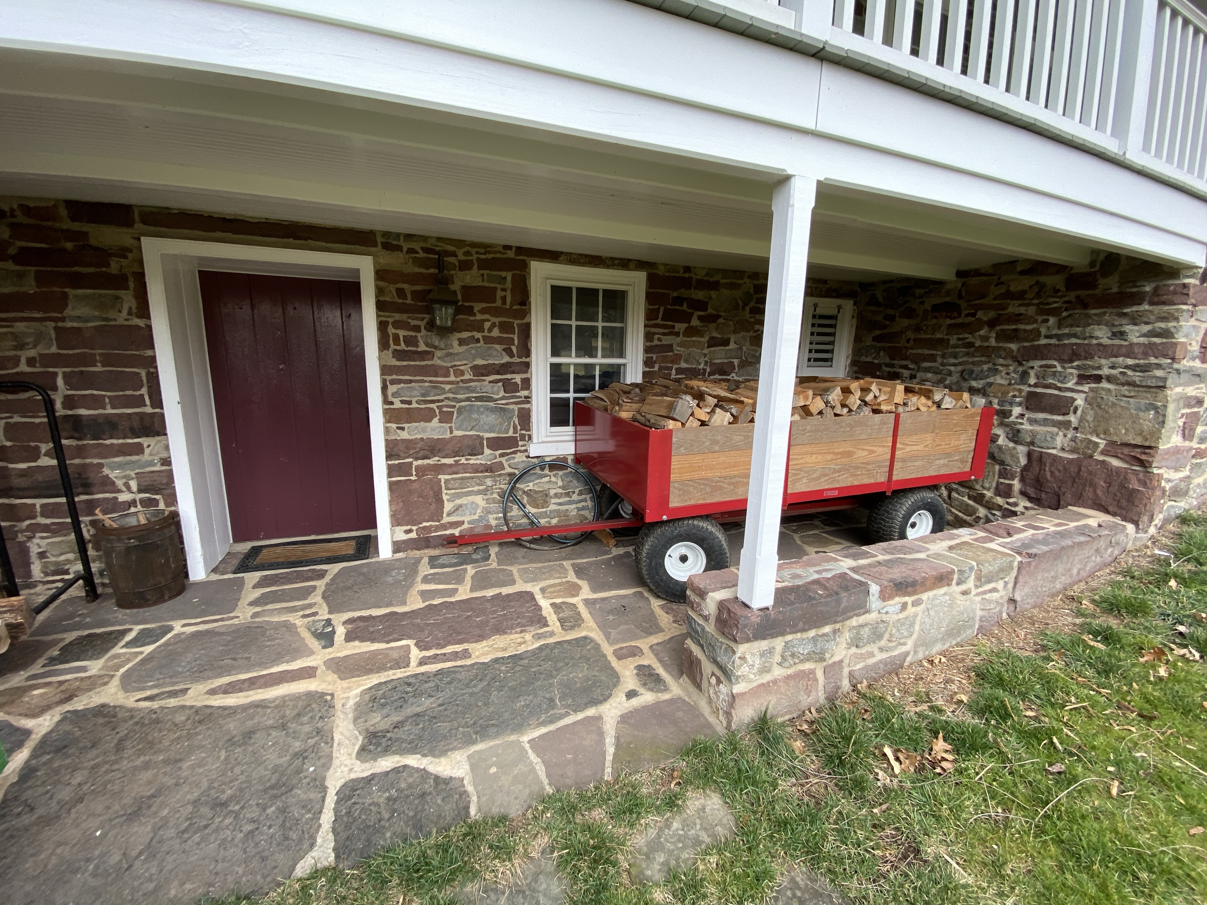

I have the wagon version of the same:
I park that wagon on the patio outside my basement door, and fetch wood from it 3x per day. When it's empty, I drive it down to the wood lot, refill it from a shed, and then park it loaded outside the basement door again.

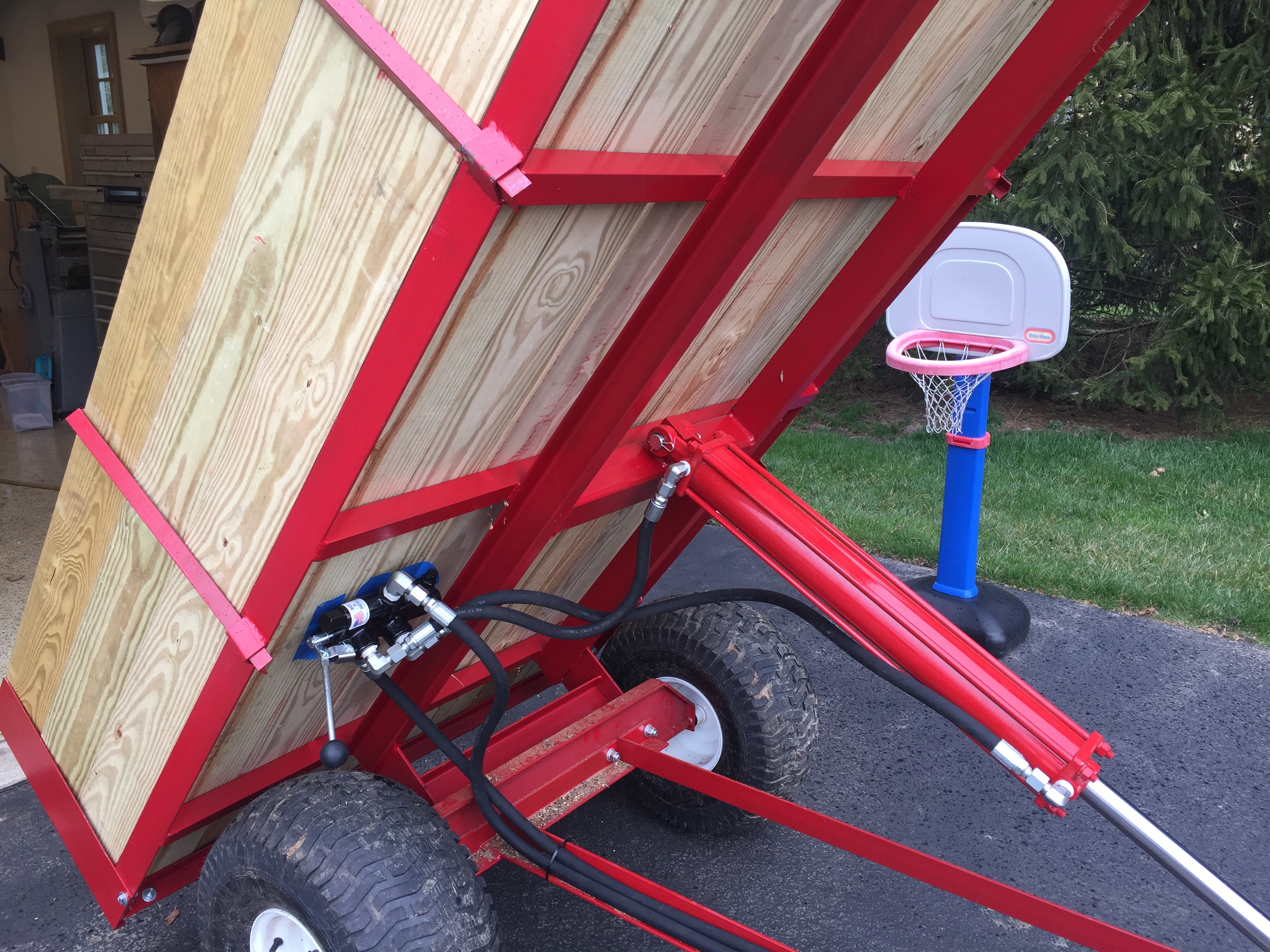

Real handy, is they can be easily converted to dump, which I did with mine back when I used it for moving lots of mulch and dirt:

Very slick dumping addition Mr. Winterdeere! Looks like it may be running off a rear remote? Are there 2 valves in your circuit, original operating the rear remote on the tractor and the one mounted on the wagon?

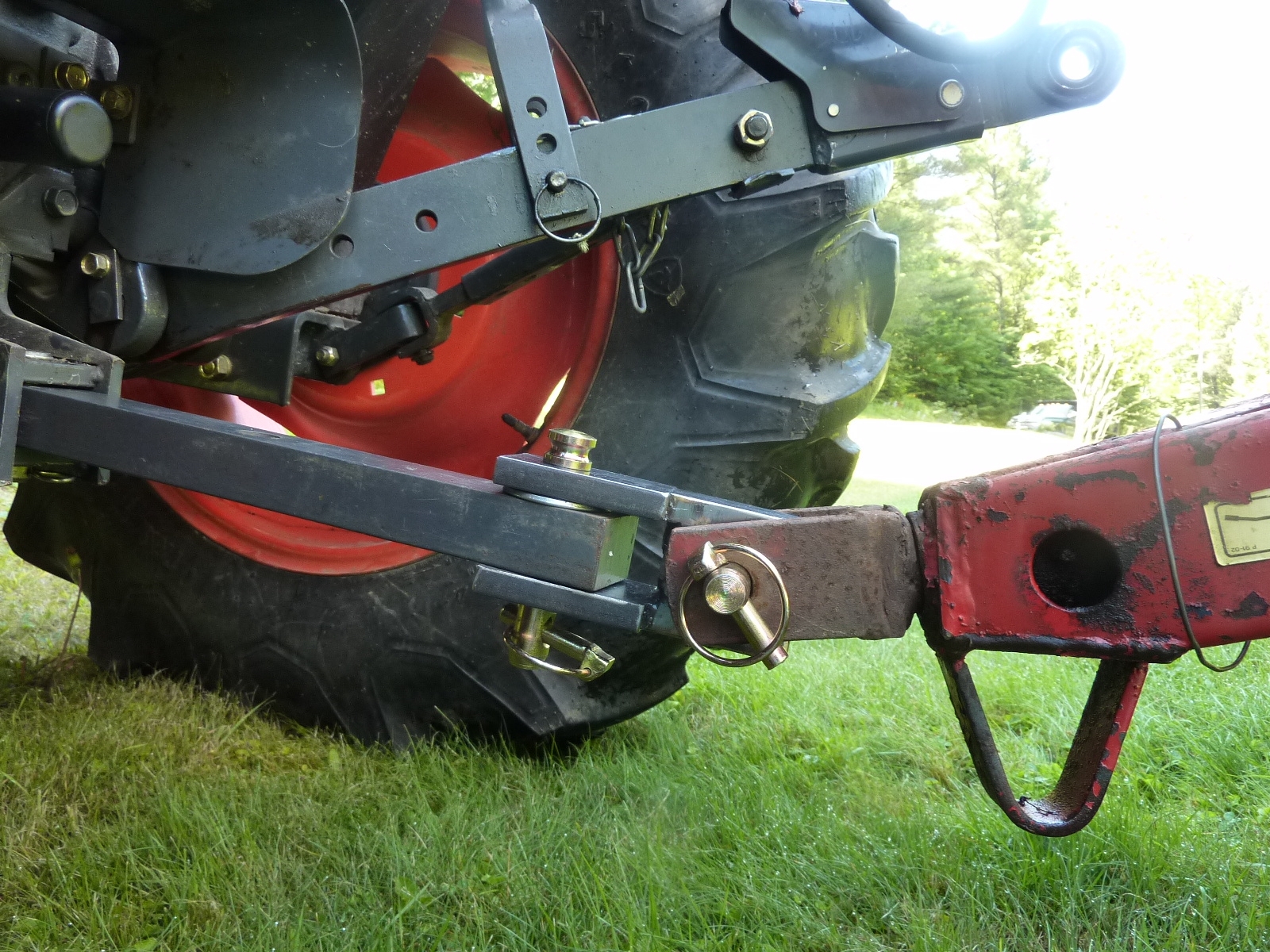

Those are nice trailers but if you are going to use a trailer in the woods or on rough terrain you will want a different type hitch. My trailer has a rotating hitch to allow rolling motion between the tractor and trailer but even that was not enough to prevent serious binding which would lead to damage. I had to add a piece to allow vertical motion also.
The easy solution for this problem is to use a Pental hitch. Just food for thought.
If I were plumbing it today, I might consider going that route, as my present tractor has a rear remote channel. But at the time I assembled this, my tractor only had Power Beyond, which is a live loop between hydro pump and transmission. So, I used a typical live-center log-splitter valve.
Honestly, the way I did it is probably more convenient, if you have a live loop feed (eg. Power Beyond) on your tractor, since standing at the tailgate while dumping is better than way forward and blind at the tractor.
Nope, only valve is on the wagon.

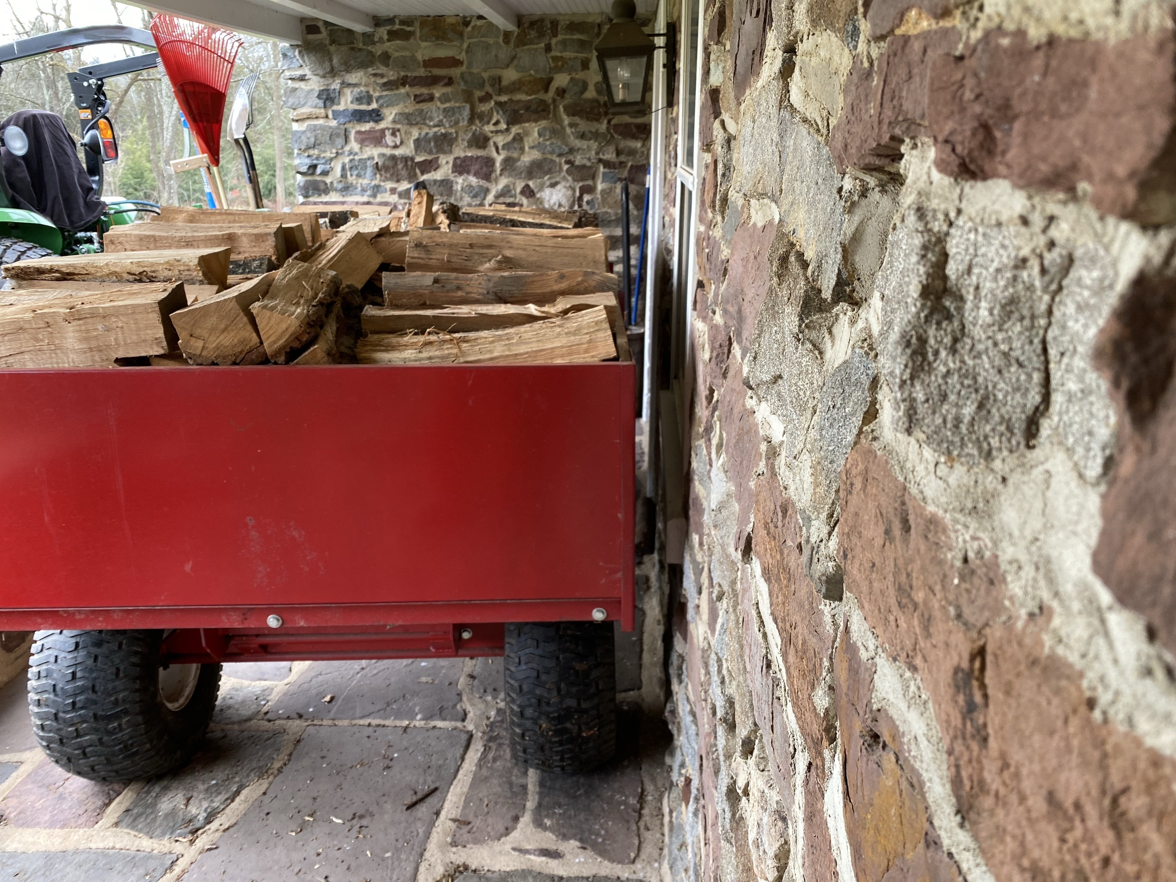

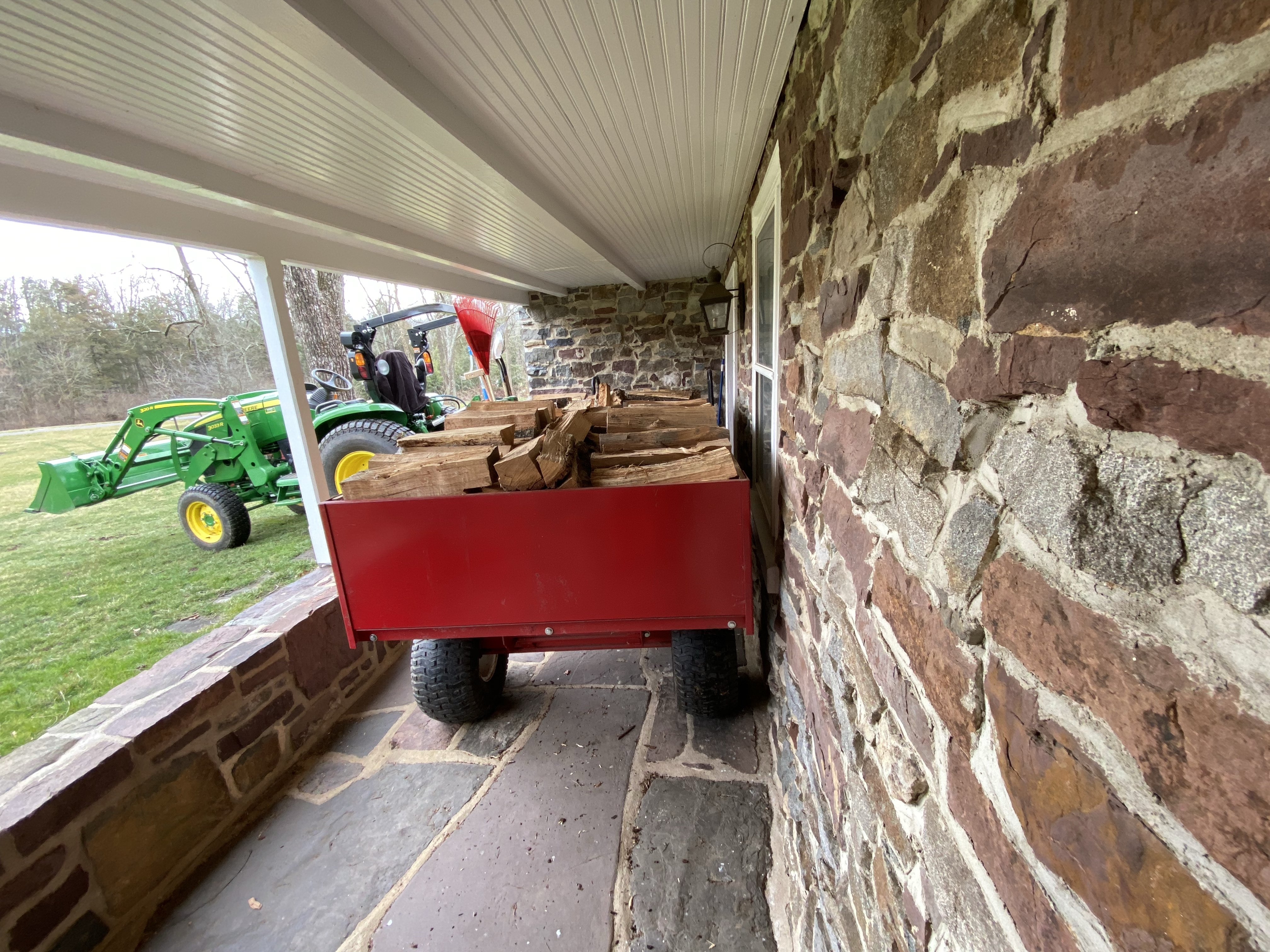

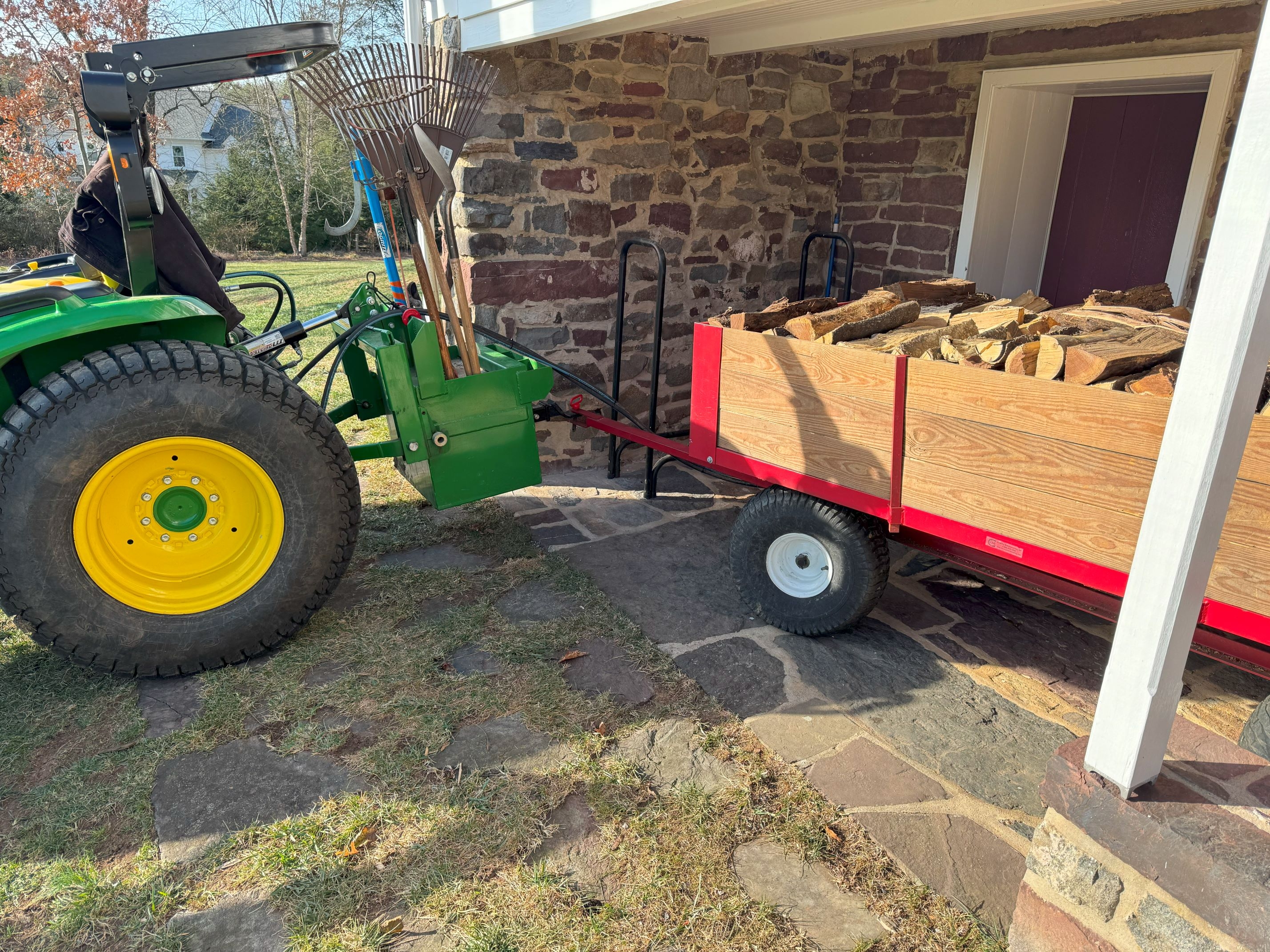

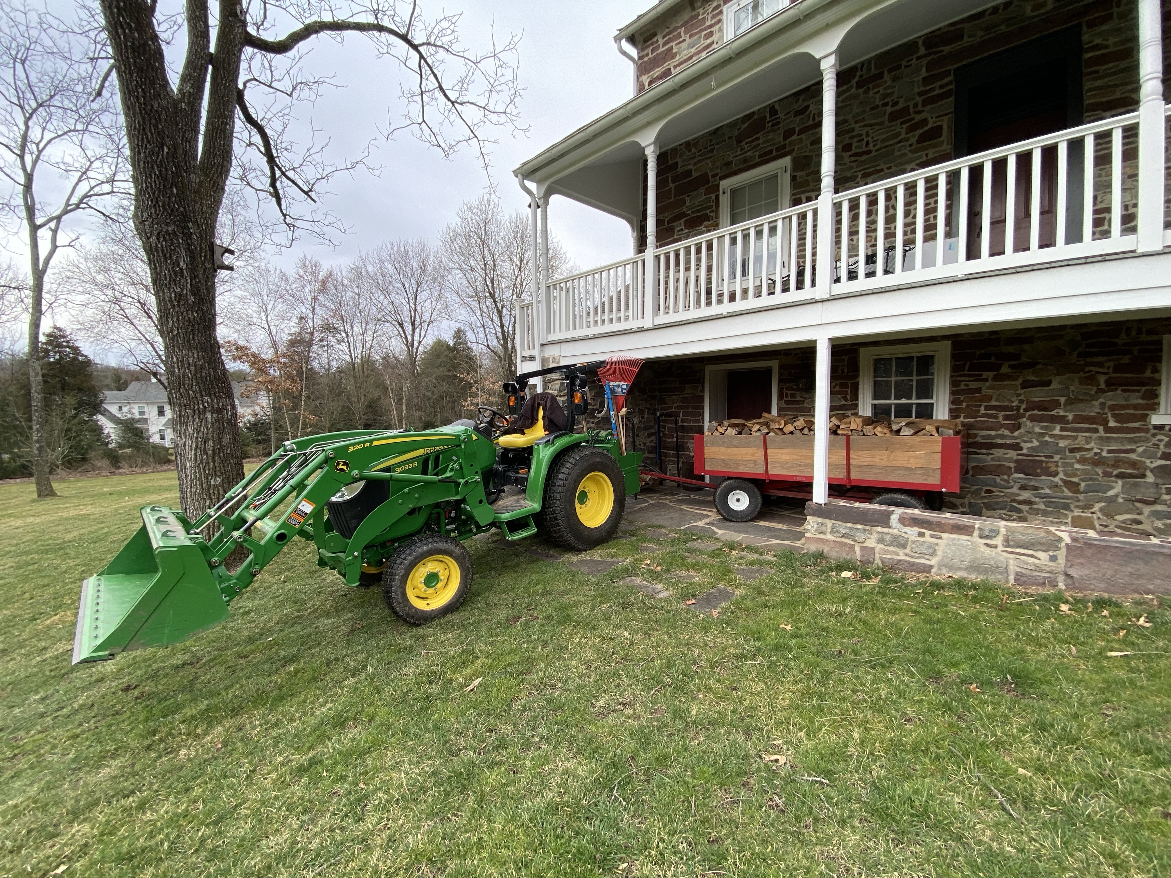

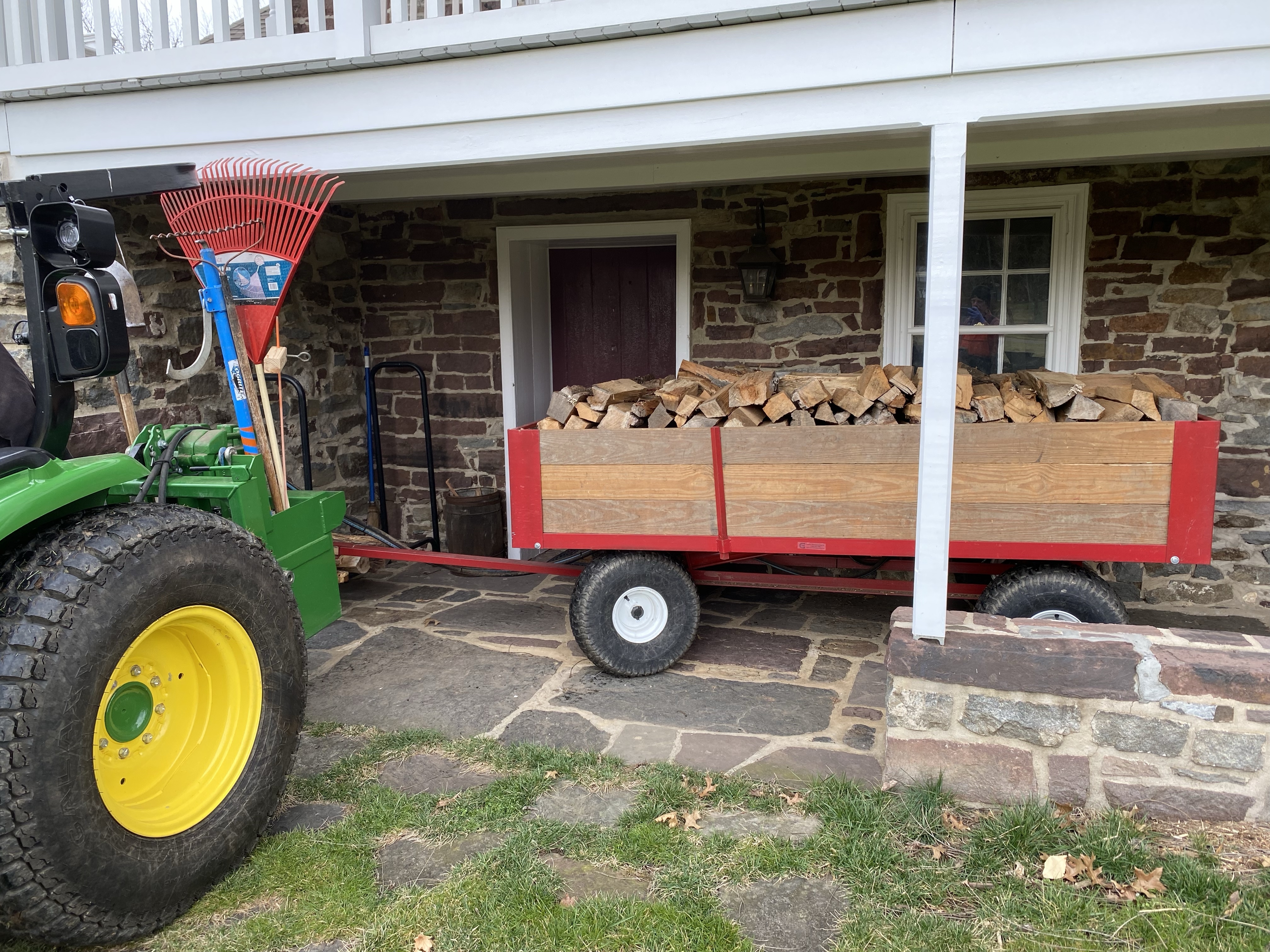

Seems like maybe the short wheelbase might act more like a tractor trailer in turning (skidding tires) , where the wagon version is steerable with the front axel?
My wagon is steerable, and very highly so. Look at the way I jackknife it into position at the house, and miss that window sill by a mere fraction of an inch! You can't do that with a regular fixed-axle trailer.
Guessing the shorter wheelbase might have a tighter turning radius, conducive for winding woods trails? (Is this accurate?)
I had worried about that myself, as maneuvering my wood lot is tight. But I've found this steerable trailer is actually better, because it follows exactly in the tractor's wheel marks, rather than having to swing wide just to avoid the trailer cutting the inside corner. My damn loader forks stick so far out in front, heck even the bucket does, that "swinging wide" just isn't an option in my storage area.
Are there additional benefits or trade-offs of one vs. the other for woods and farm type activities?
The reason I bought the steerable wagon configuration is that I wanted to put 4000 lb. of wood in the wagon and just park it. I didn't want to be dealing with the danger of the thing going wheelie as my family unloaded wood from it in less than perfect fashion, while it's sitting un-hooked on the patio. Since then, I've found many other uses for it, like filling it with dirt from a dig site, and leaving it parked full of dirt while I work on various underground utilities around the yard.
gg
Your hitch is definitely better than mine, if going on extreme side-roll angles. But my drawbar is hinged two ways back at the wagon (up/down + side/side), and easily goes from below grade to chest height with no binding. For side roll, they just made the receiver super-loose, like a 2"+ opening for a 3/4" or 1" drawbar thickness, and with a 5/8" pin hole. So with a 5/8" pin in my drawbar with 1" or 1-1/4" hole, it can roll side-side more than my comfort factor will allow, which has been good enough for my needs.
I'll try to remember to get a photo, the next time it's hooked up. Like I said, yours is definitely better at the hitch, but what I have has always worked perfectly fine for my less-extreme articulation needs.

You were nice enough to send me pictures a few years ago of that extra pivot. I copied it for the hitch on my forwarding trailer, which was getting some damage from driving through ditches and over rough terrain. Mine did not come out as good as yours, but it does work: no more binding.
View attachment 2073873 View attachment 2073876
View attachment 2073874 View attachment 2073875
WD, Man that is good backing up! It must take quite a bit of practice to be able to do that! Without scraping any of the house. I'm pretty sure I "couldn't" do it!
