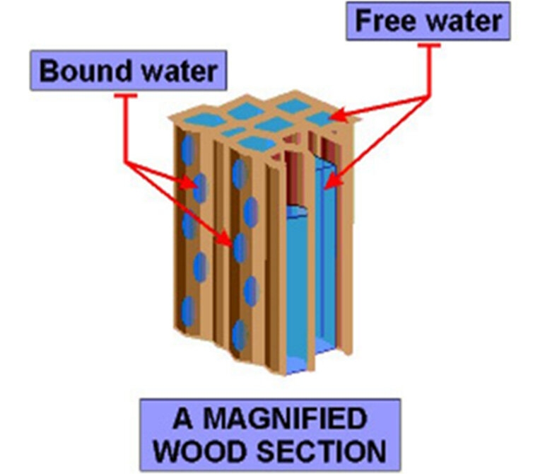

Wood contains free water (within cells) and bound water (within the cell walls). It only takes a few weeks or months for free water to escape, but months to years for bound water to escape. Wood will rapidly dry to around 30%, then very slowly dry to the equilibrium moisture content.

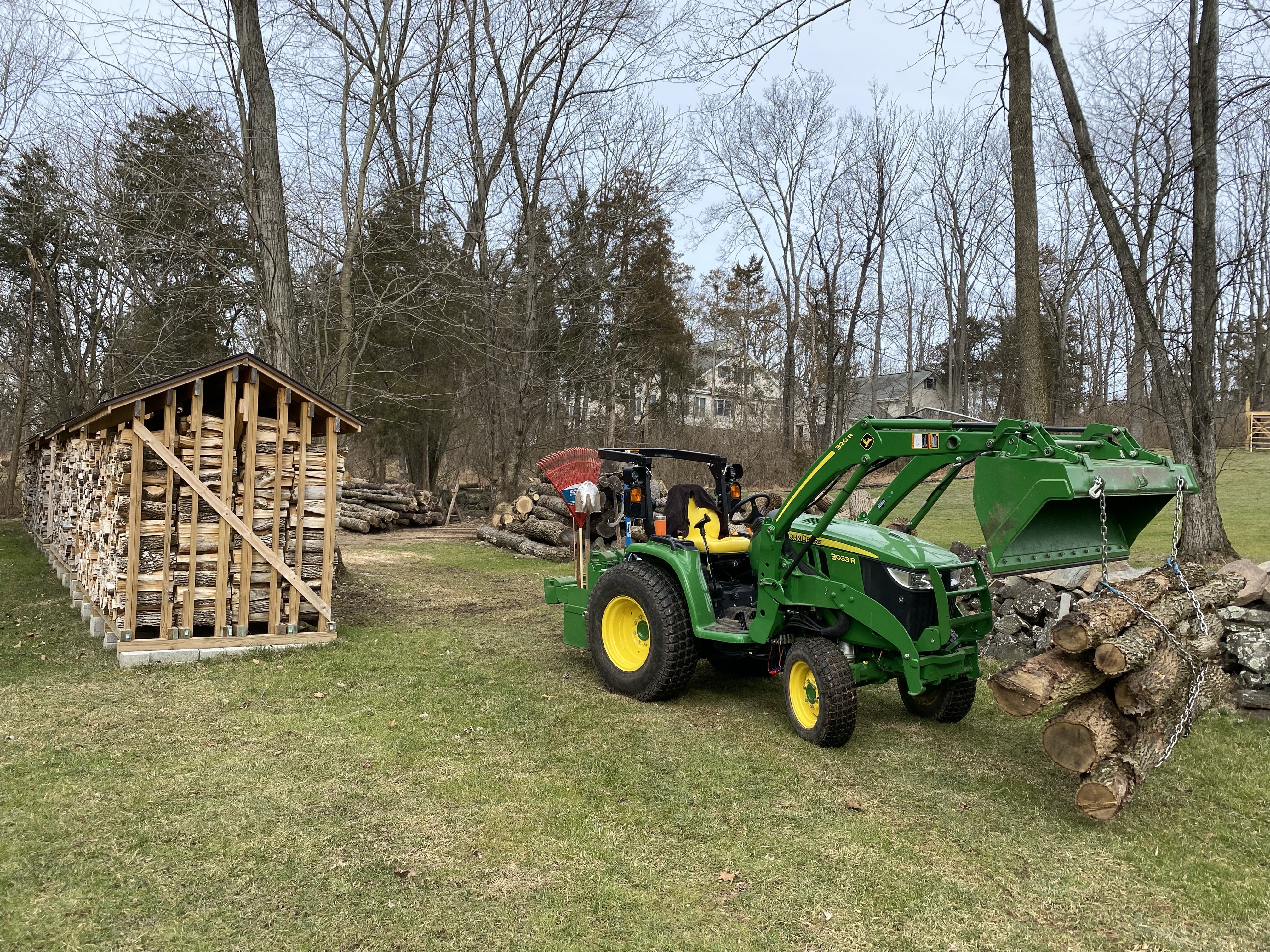

Agreed. My "sheds" are a roof only, open on all four sides. But they're 4-rows deep, and being open on both faces, that means there's an inner row on each side that doesn't get the sun and wind of the outer rows. You can see the arrangement of the rows in my shed in this old photo:
Since I'm leaving the wood dry in those sheds 3-4 years before use, it really doesn't matter much, until you get into something like white oak... which is difficult to dry under the most ideal conditions. Last week I was unloading a bay from one of the sheds, where some of the oak on the inner row still felt a bit heavier (i.e. wetter) than the outer row, even after 4 years split and stacked.

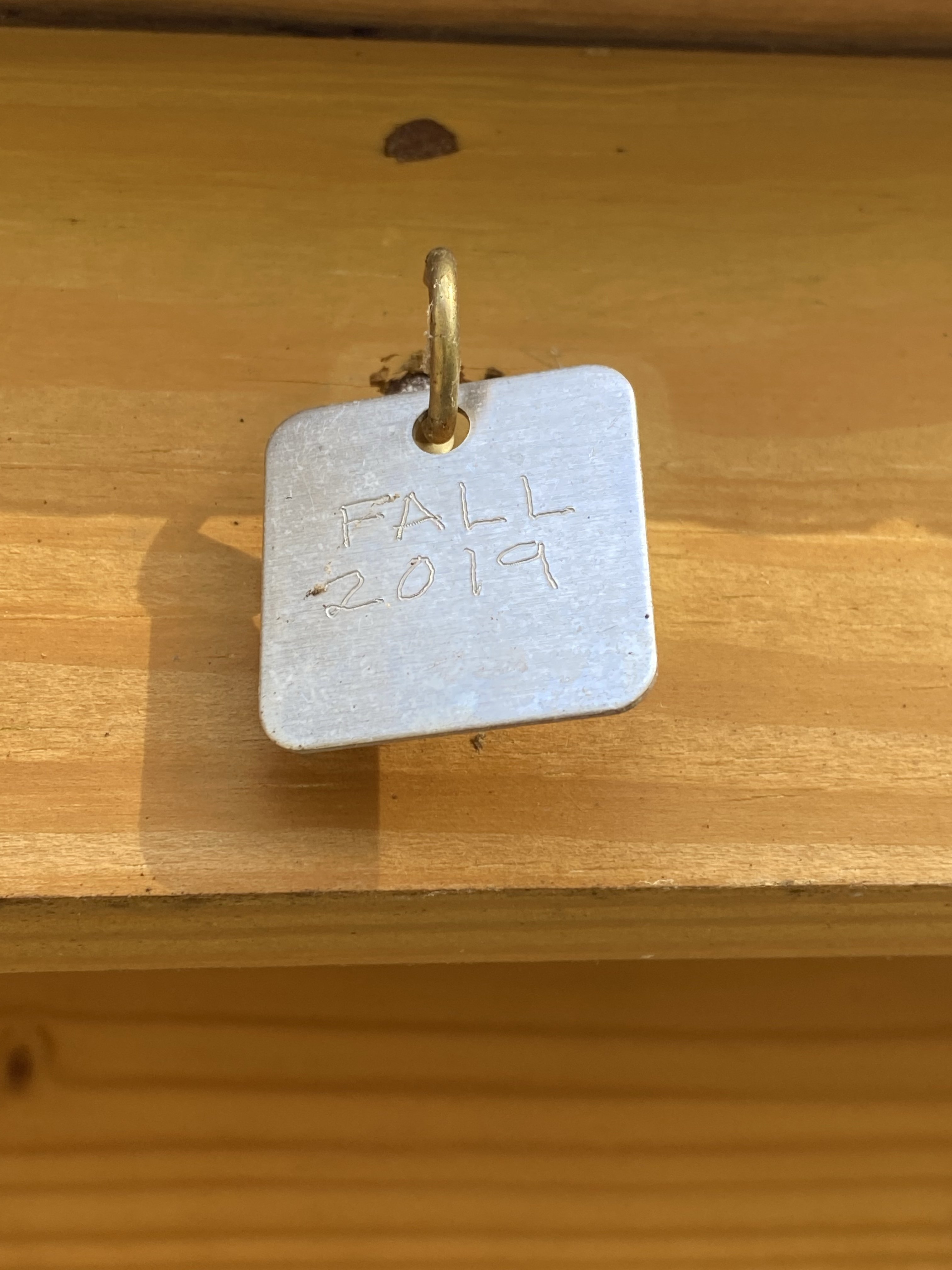

I tag every bay in every shed, so I know exactly when it was split and stacked. I don't track when it was felled, but I always have a backlog of logs (see background of photo above) running 1 - 3 years.

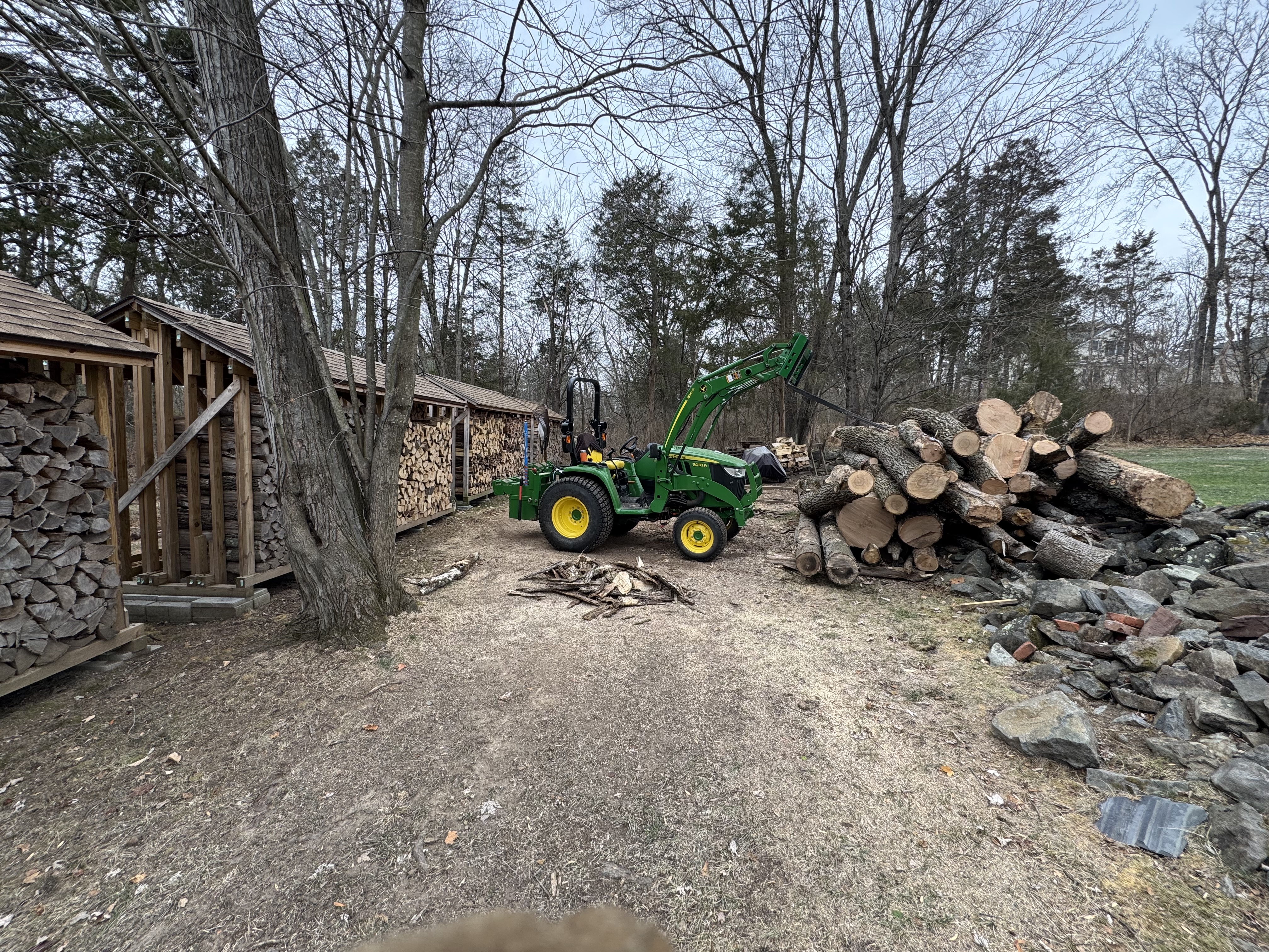

Fetched two trees from two neighbors, this weekend. One larger oak, and one medium ash. Had to scramble both mornings, while ground was frozen, as afternoon sun softened the surface both days.
At one point, I returned home with a load, to find my tall pile had rolled down, thanks to thawing conditions, and had to be piled up all over again:
