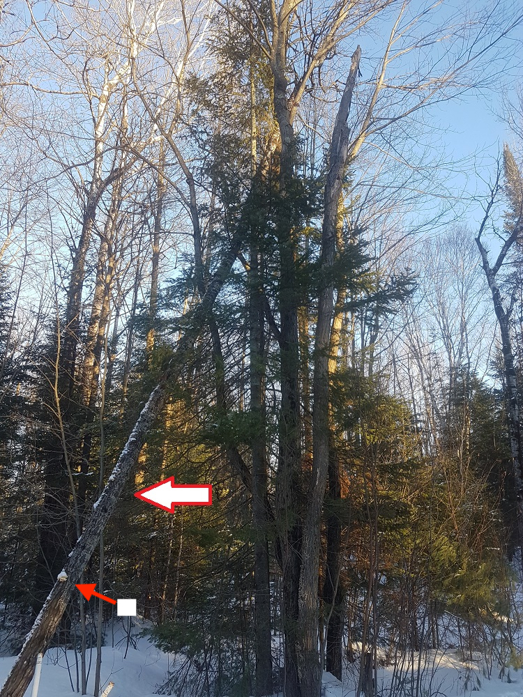

As I said before; that isn't the one which you need to worry about. It's hung in the other trees pretty good, and since it's a poplar will shed it's limbs then slowly deteriorate. The maple looks rotten and has been dead for a while, based on the lack of small limbs and the mushrooms on what's left of the bark. It's also free standing, and can come down in any direction, probably in large chunks.
It will be taken down in due time. Part of clearing some of my property. If it falls now it's now going to hit anything. It's very much like the one I pulled down by hand. Pretty soft.
   / Tractors and wood! Show your pics #19,783
you can hook a long chain to the bottom of the tree to the tractor and slide the bottom out until the tree top falls out of the other tree and slips down it to the ground. If doing that you have to make sure the tree is not wedged in the dirt and the top starts toppling over. I had that happen to me but luckily never hit the tractor.
Other ways is with the power saw but it is to dangerous if you haven done it before. You cut 4 foots junks off the bottom until the bottom actually end up so close to the tree that it is hung in. When cutting these 4 foot chunks of the bottom of the tree you have to cut the underside of the truck or the saw will jam. The tree trunk will fall towards the tree it is hung on as you cut off the 4 foot chunks. Here is the catch.... With the butt end close to the tree that it is hung up in the tree will be leaning towards you and the top will topple back towards you. You have to be ready. I did it many times but it is a dangerous thing to be doing and not recommended unless you have lots of experience doing this sort of thing.
Not enough room to move it once hooked. Part of the problem.
When I built the place I used various methods to take down hung-up trees and sectioning was one of them.
Back when I did this I was daring and much faster. I am neither now.
   / Tractors and wood! Show your pics #19,784
Do pre-cut as high as you can. Take into consideration how healthy that wood actually is. If it's already rotten - cut less than half. If it's nice and "green" you can go till 2/3.
Put the cable around tree where that cut is.
Pull gently, to break the cut. In pic it seams that you can pull it sideways, that remaining tree will not allow the fallen one kill you
Tree should not flip over but stay like it is, and already 1.5 m shorter and 100 kg lighter
Repeat, till you can handle it

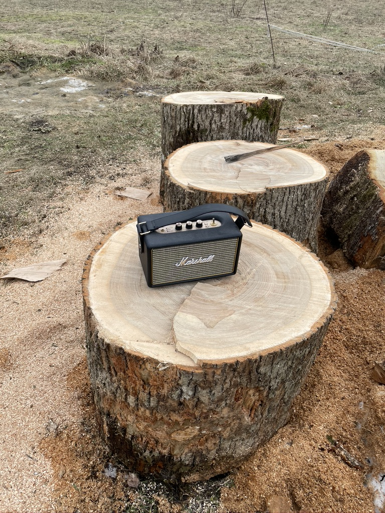

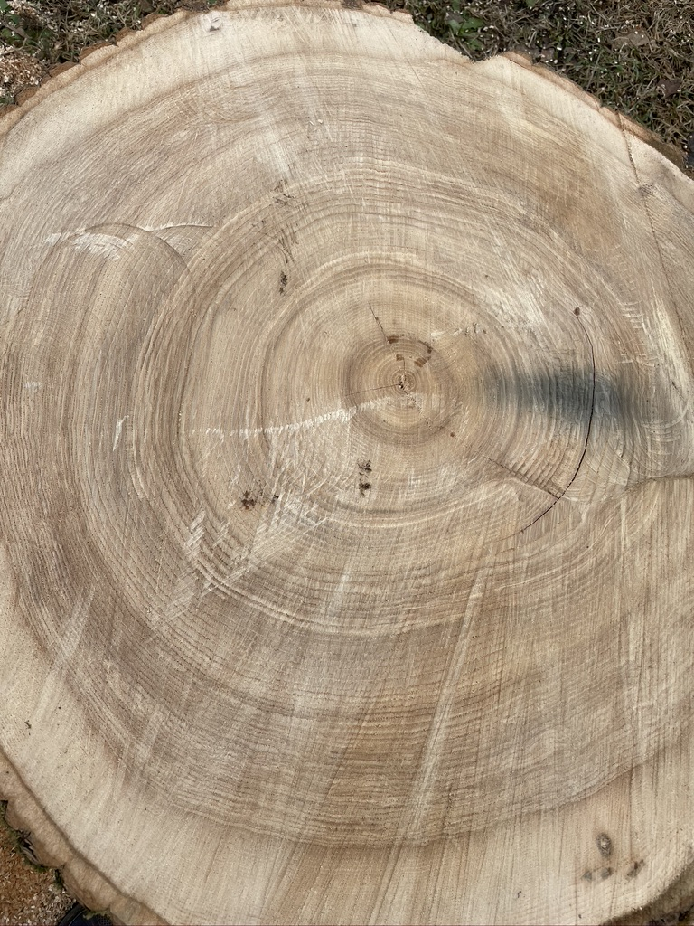

Trying out the new ms462. There is a lot of oak wilt going through the area now. Quite a few are 180yrs old. Interesting when counting the rings, the first 100yrs the things were only 4" dia or so, then take off to 30".
That's a lot of rings to count.
