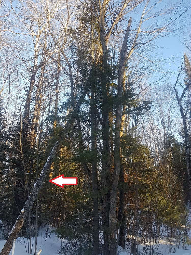

Can someone tell me how to safely take this tree down?
I think trying to use my FEL to move it, either from the top(ish) or bottom, would end badly for me or the tractor, or both.
Can't pull the base away from a distance because there is not enough room (house).
Can't just cut as it stands as far as I know because it could end up anywhere.
I don't really want to take down the stand it is leaning into (piece by piece).
It's broken at the base as far as I can tell.
I'm no expert, or even much of an amateur really.
It's about 8 to 10 inches diameter
   / Tractors and wood! Show your pics #19,767
The problem I see isn't the tree you are concerned with. First you need to notice and deal with that dead maple just to the right of it.
There is a reason why those are called "Widowmakers".
If you aren't comfortable doing it you should call a fully insured professional. The price might seem high at first, but it's always cheaper than a funeral.
Edit; I wouldn't even consider hooking onto it with your tractor, unless you will be at least as far away as the tree is tall. (One reason that I like my winch.)

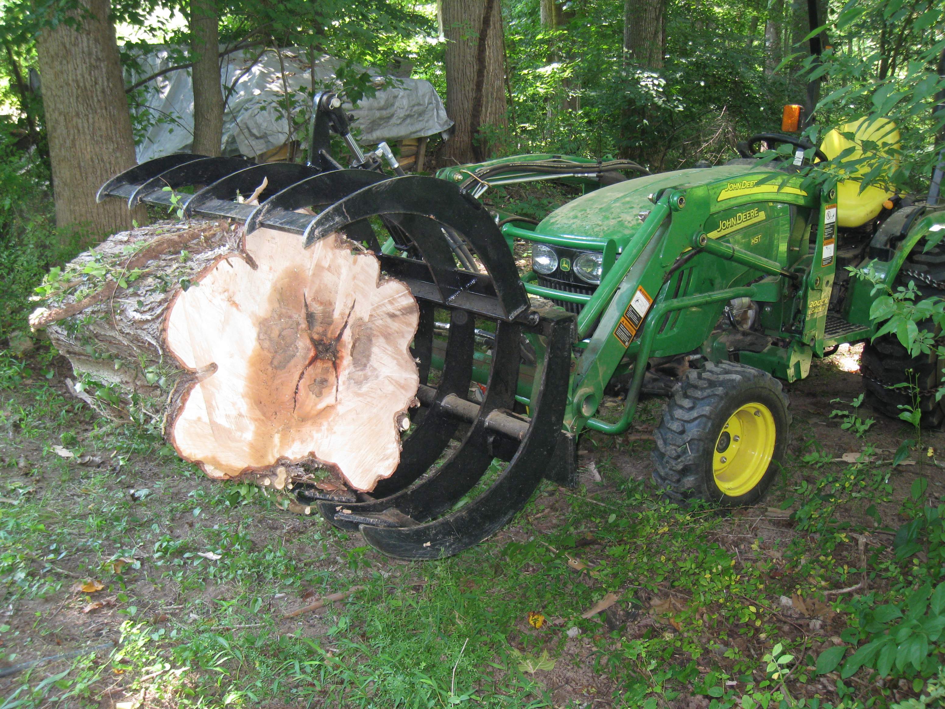

Hauling cut pieces to the splitter on a very hot summer day.View attachment 360410
Man I wish I had a grapple. I have forks but it doesn't really cut it with bush. I have to pile my brush is tight piles in order for me to pick it up.
   / Tractors and wood! Show your pics #19,769
One TBN member touts the value of grapple thumbs on his forks. I don't know if that would work for you or not.

If you think it will slide out of tree's it's wedged in, then at your house you might have a good anchor point (like another tree of good size) that a directional pulley could be attached to.
Then you should be able to pull in another direction.
I don't know if you were considering using cable or rope, but if it were me I'd be using 1/2" static rescue rope, a 4" diameter (minimum) pulley rated for the rope, and connection hardware that's also rated for the rope (all with a safety factor figured in).
I have these items available for me to use, others might have 5/16" or 3/8" cable.
