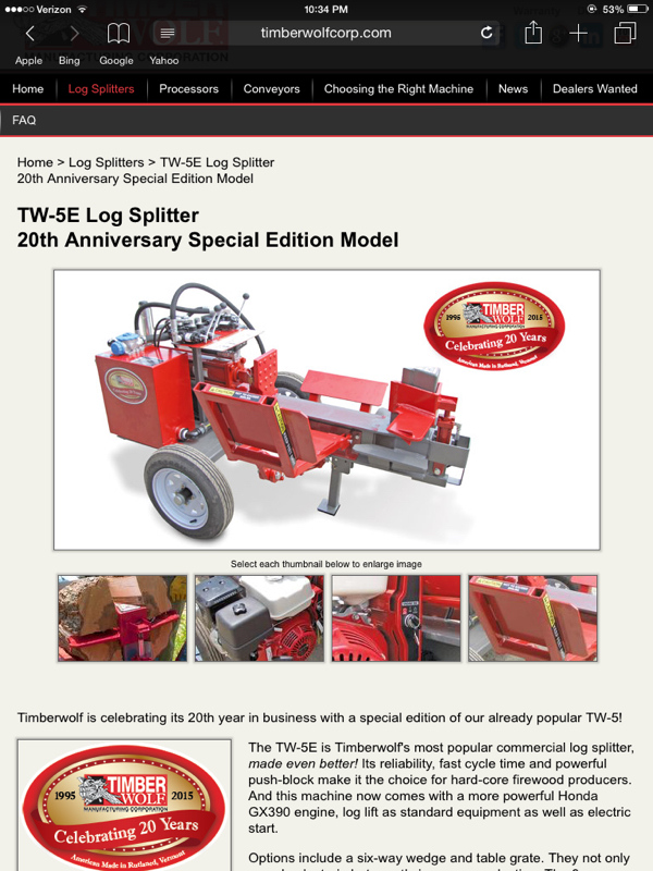

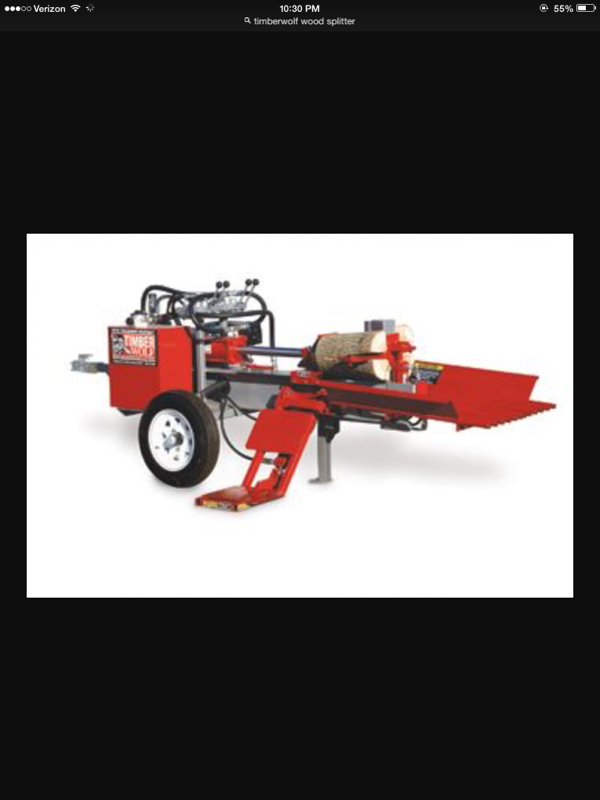

Why don't you build a log lifter? After my wood splitter was stolen I'm going to have to build one. The plan is a horizontal only with a log lifter, wedge on the end of the beam, and a large table to catch the split pieces. Here's about what I have in mind. image-3761013816.jpg image-421006399.jpg They claim a 10 second cycle time with 22 gpm which is acceptable to me. My other splitter did 13 seconds. I wished it was faster, but it wasn't that bad. I plan on building a self driving unit with a lawn mower conversion. I'll probably end of scrapping that idea in favor of a self driving unit propelled with the lawn rear end and powered with the lawn mower engine which is a 18 hp Briggs&Stratton vanguard. I don't want to power it with my loader tractor because it needs to move wood. I could power it with the B7200, but it'll probably be sold in the feature.
