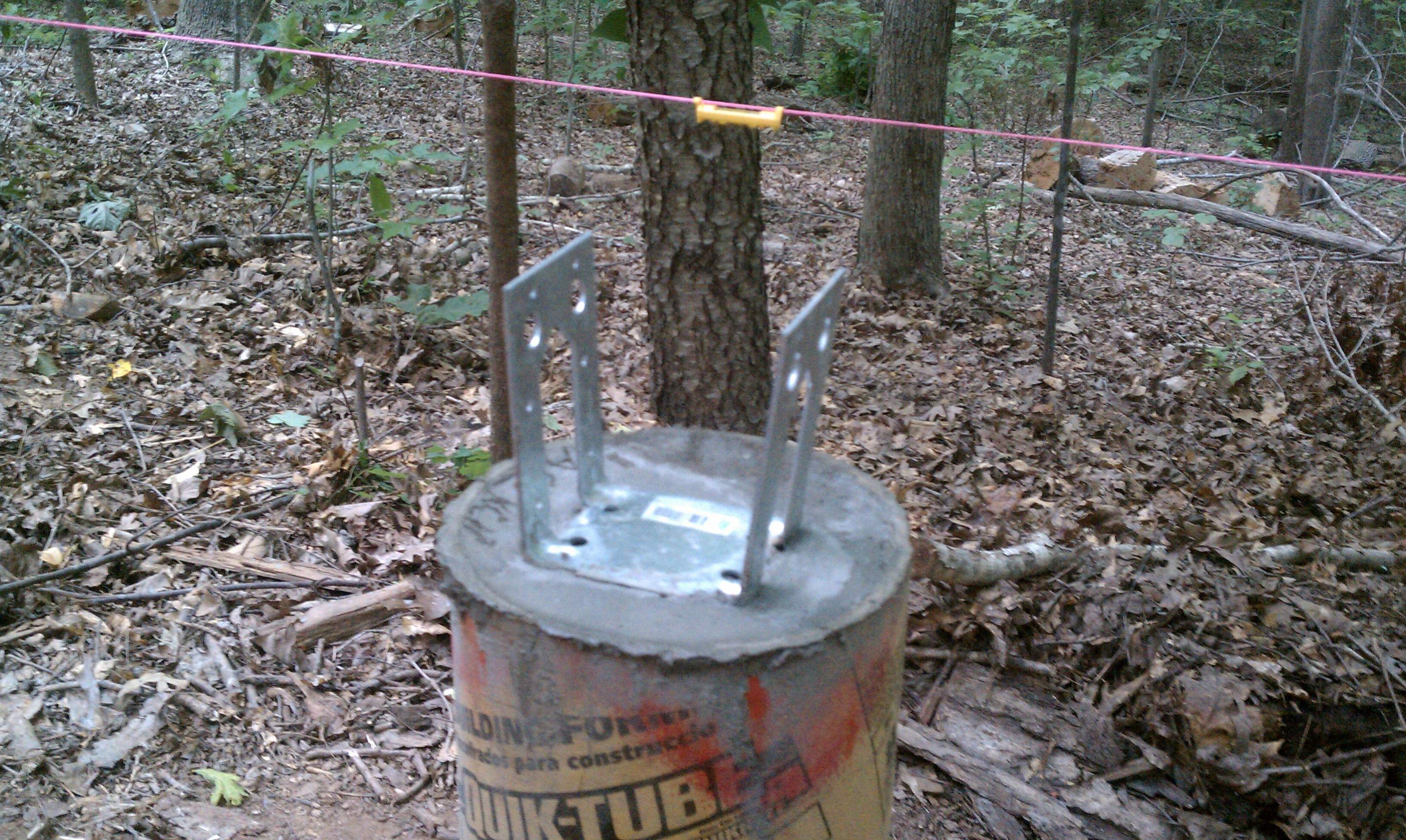

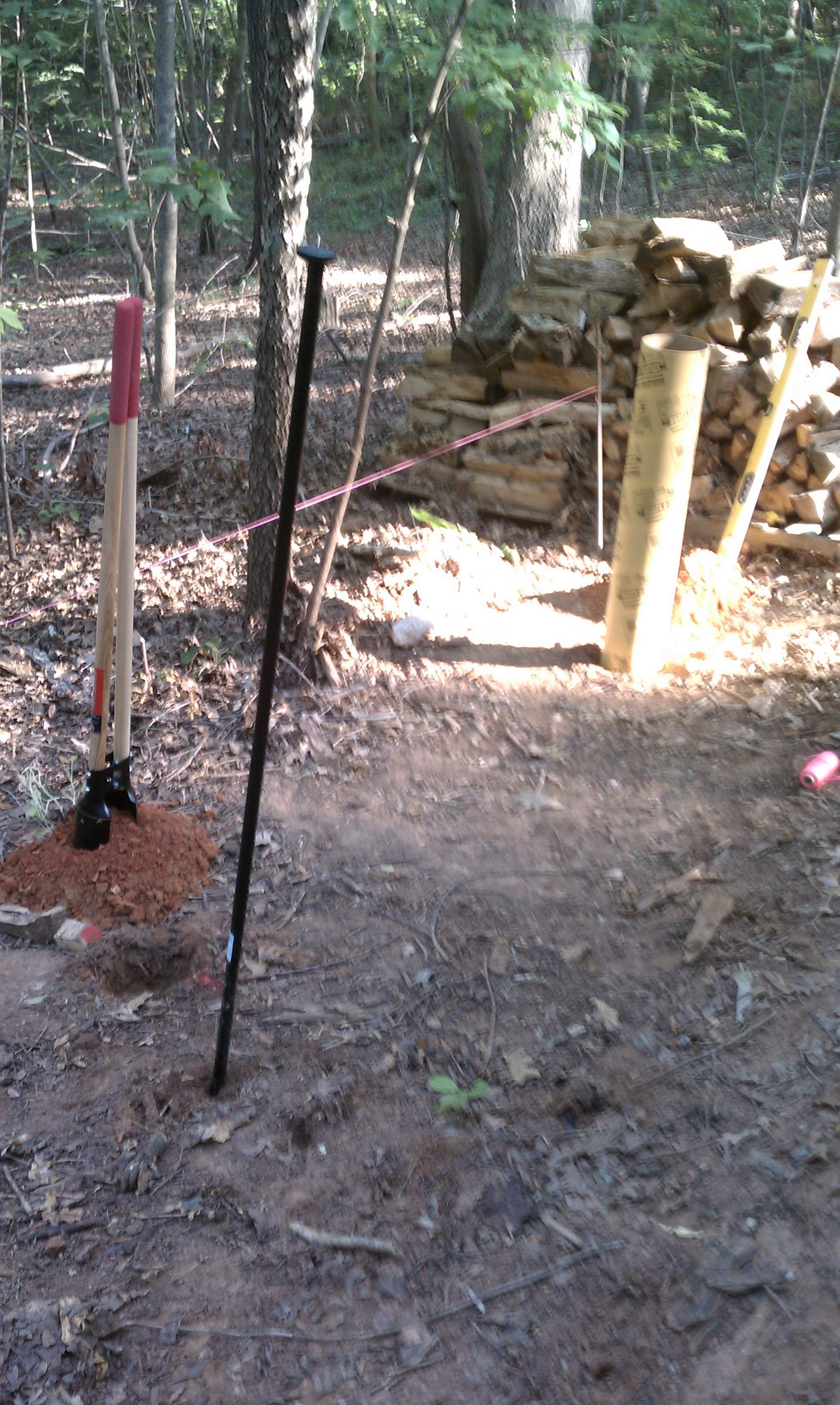

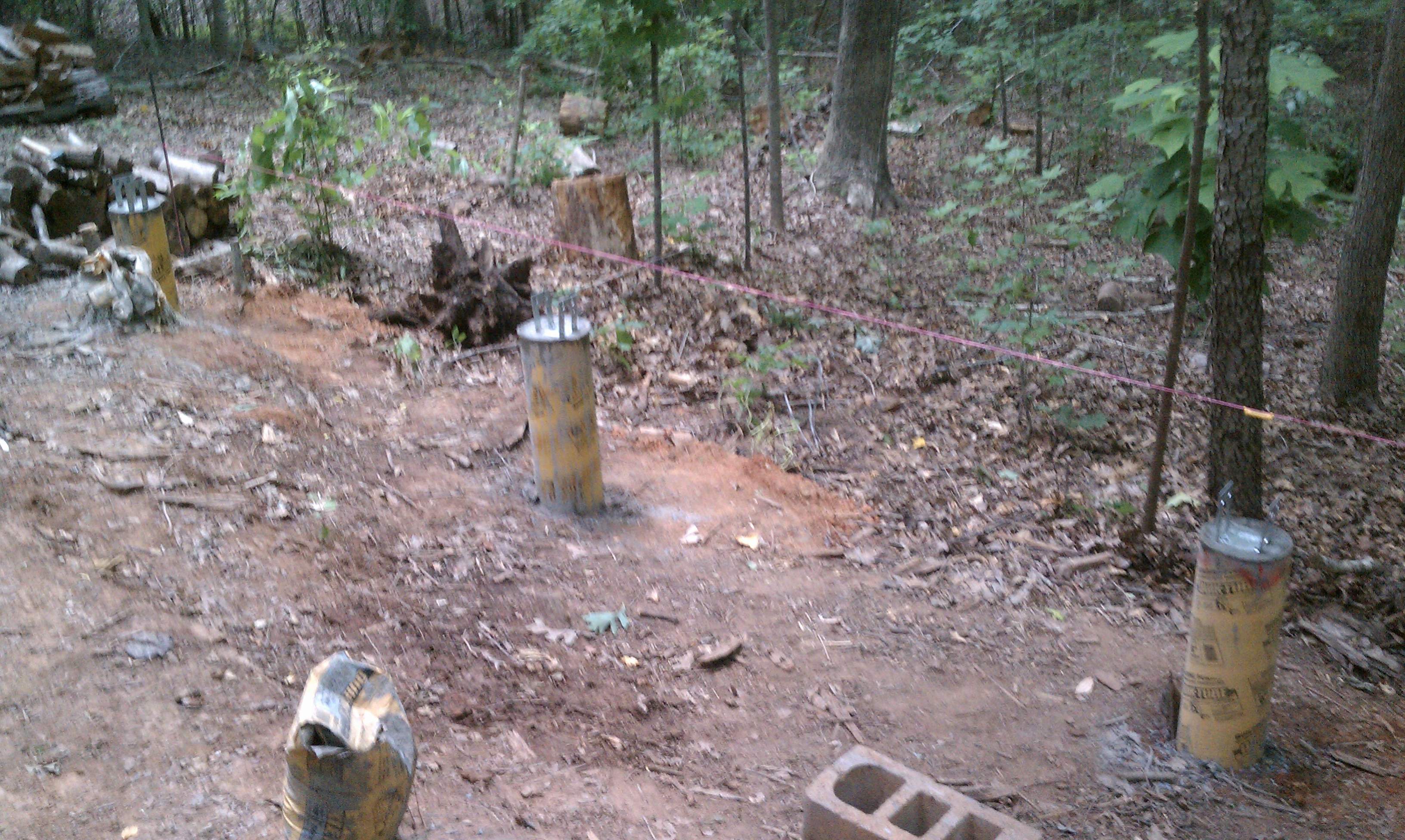

While waiting on my B2320 I decided to build a 16x16 lean two off the back of my current shed. The plans are to store one cord of fire wood under the 4 foot overhang. Then the tractor and implements under the remainder. The post are set now going to pick up the lumber and sheeting... here is a pic of the posts.
/ tractor/ wood shed #2
says the photo is corrupt. :confused:
think I fixed the pictures here ya go... this is last weekend working on the posts. I will bring the area up to grade once the shed is built

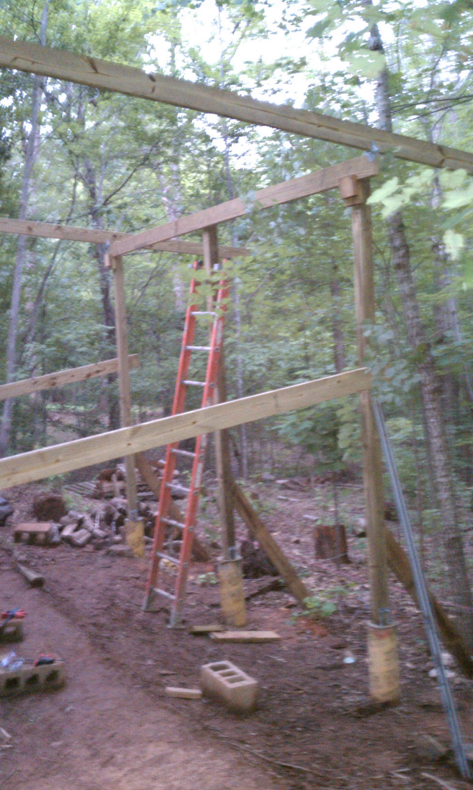

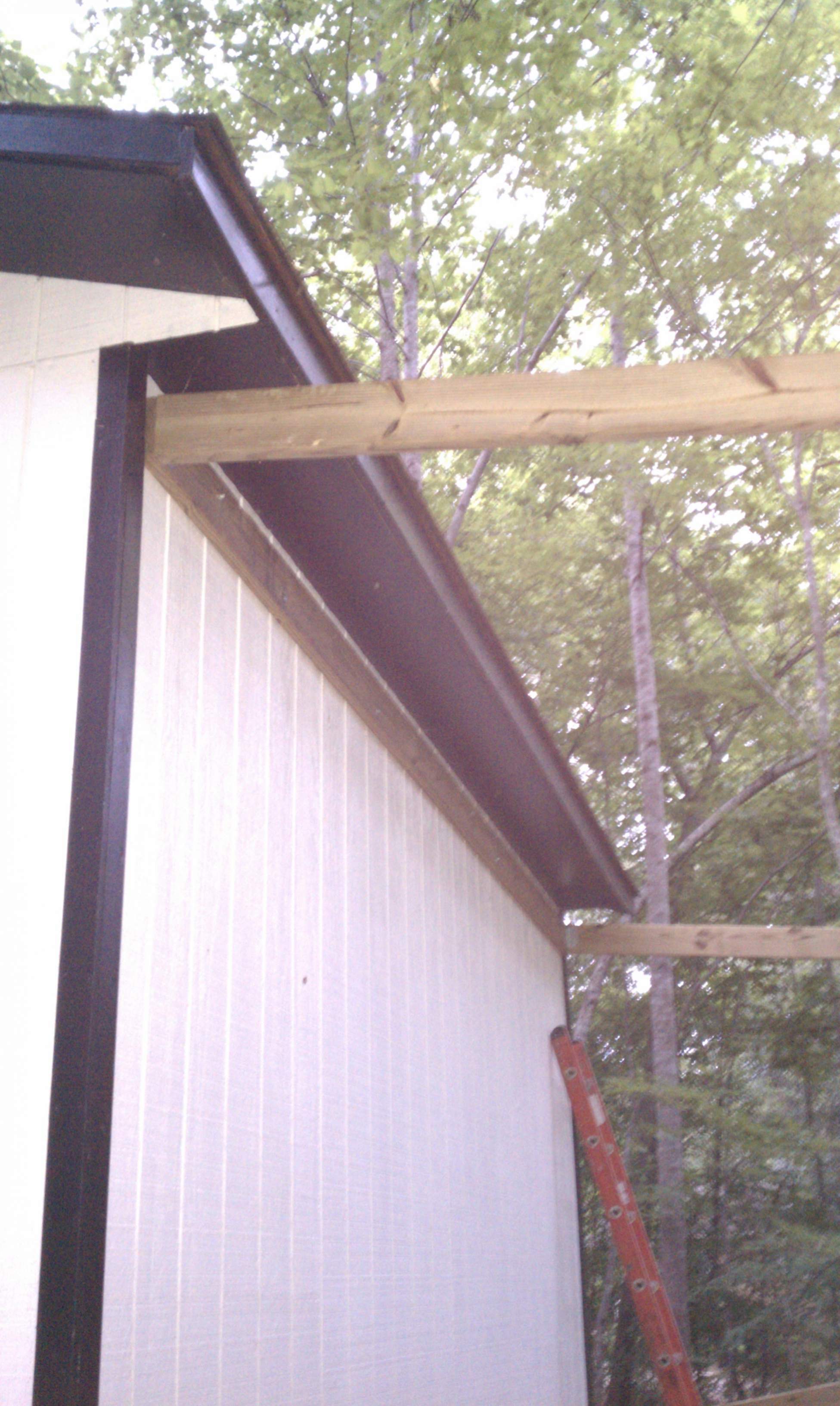

here is what we got done last evening... note some of the boards are just supports to hold everything square while we are building it. the hard part is done now. have to add the rest of the intermidiate boards, then sheet it and figure out what kind of roofing material I should use. any thoughts??

I was going to encourage you to keep the sides open for awhile and test it. I did an 18x12 enclosed. But with my tractor I note that I have to move 627 items to get to the thing in the back. So I just added another 18x12 lean-to and kept it open so I can have access to all the attachments without moving everything.
I'd use metal roofing which is what I use on storage building. One you don't have to sheath with wood and the frame cane be on 48" (2x6's)centers with 24" (2x4) cross braces. Use one opaque sheet on the roof and the inside will be light when you close in sides which some times leads to closing in ends.:)
Metal will be a little higher but when you figure in speed of completion, lifting sheathing and shingles and less wood for sheathing. Call a metal roofing supplier and price it. Building Supply stores may also sell it as well as farm supply stores.
Use gloves. 2x6 ridge down to side 4' on center. 2x4s across 2x6s 2' on center is what I do on my buildings as in this picture.
