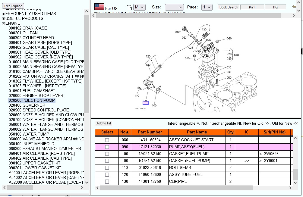

There's a small fuel lift pump on the side of the engine, below the injection pump, that might be the issue - with the tractor on level ground the tank is above the engine - the lift pump doesn't have much lifting to do, but if the tractor is sloped backward the fuel may not be getting to the main pump. (more likely to act up when tank level is getting low)

Yes and yes - take it off (2 screws) and test it in your hands. Push the button that sticks into the engine, holding a finger in turn over each pipe. One should suck, the other should blow. If they don't there's a failed diaphragm inside (not serviceable like the old ones on chevys were)

That's nuts. If it fails the finger test, a new one is under $20.
If the fuel tank level is low, try putting in a few gallons - might get it going - open the thumbscrew bleeder valve to bypass any air back to the tank - close it once its running.
