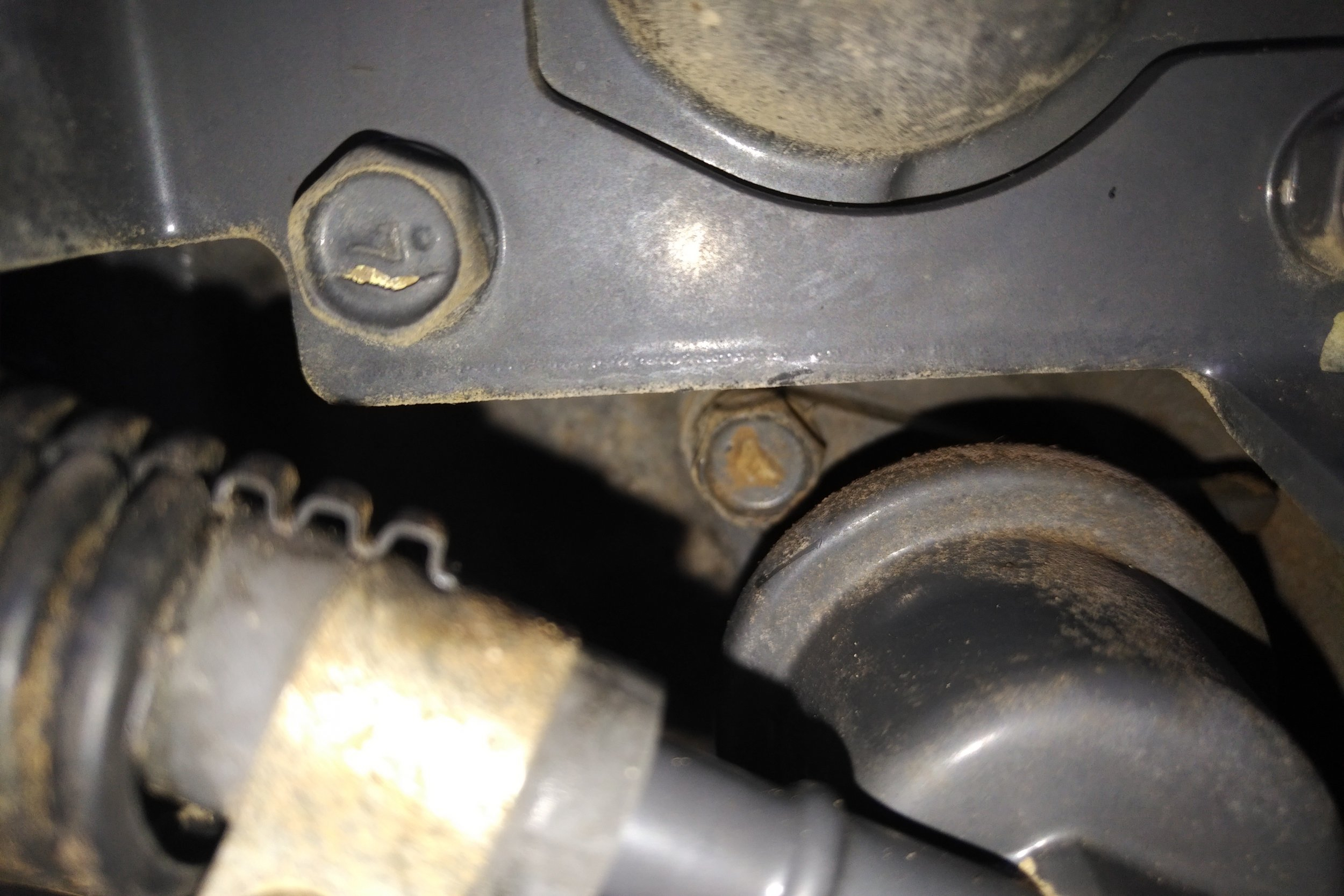

changed filter. plenty of fuel flow observed by gravity, as I turned the "off" switch improperly, and scrambed to test all settings to find the true "off" (to stop the flow).. although i don't think this proves anything
only got a few mins out of tractor
can't hold RPMS above 1500.
can't figure out what socket tool one needs to get to the pump nuts. The nuts are partially behind the pump casing.
based on other reading, the fact that tractor works for a while, and with full tank, not sure if pump is an issue.
Just two screws based on earlier input are kinda hard to get to..
Regular socket wrench can't get to it, would require removing stuff in the way.

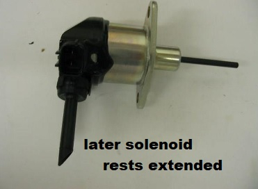

Could you have a faulty fuel shut off solenoid or possibly a problem with the wiring to it? This shows a picture of what it might look like Amazon.com: Mover Parts Fuel Shut Off Solenoid 1A021-60010 1A021-60015 for Kubota V2003 V2203 V2403 D1503 D1703 D1803 L2800 L3130 L3200 L3240 L3400 L3430 Bobcat S150 S160 S175 S185 T190 AL275: Automotive
From what I understand it should only engage to turn off fuel flow when you turn the key off and then should disengage after a few seconds to allow you to start it again. Means that ignition wiring could cause it to engage if there is some type of problem there.
Here's a tread from here about someone else having an issue with it Kubota L3430GST Fuel shut off solenoid clicking on & off
   / Tractor wont start on incline #19
Something might be interrupting power to your "stop solenoid". On a L3430 the stop solenoid needs 12v power to allow starting.
The actual performance of fuel solenoids has evolved. On older models the solenoid activated to EXTEND and cut the fuel for a few seconds (you can hear it click off a few seconds later, retracting to its rest oposition enabling fuel flow for starting next time).
On newer models it's function is reversed. Its rest position is EXTENDED, pushing the fuel rack to the no-fuel position. On KEY-ON the new type WITHDRAWS, allowing fuel to flow. You need 12v to it to allow fuel into the injection pump.

The above comment in RED needs some new light on it. There are two versions of the stop solenoid and two ways they work
The function of the "STOP SOLENOID" got reversed around 2003 with intro of L..30 models (and other products).
Until 2002 the stop solenoid acted on key-off to actively cut the fuel for a few seconds to stop the engine. A bit later it RESETS, enabling fuel to flow for starting next time. This arrangement is in use on 149 Kubota models - thru the Lxx10's.
Starting in 2003 the design changed. On 96 models since that time the stop solenoid still acts on key-off to actively cut the fuel to stop the engine BUT IT DOESN'T RESET. With the later solenoid, the key needs to be turned on to actively power it to allow fuel to flow.
Here are the two solenoid versions - Komrade's tractor has the later one - if anything cuts the 12v to it, the fuel stops.
