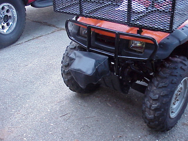

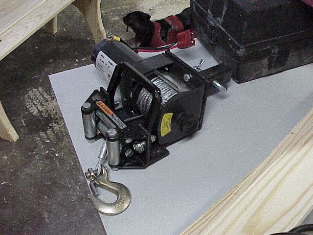

Yours looks a lot like one of mine. I first built this one for my 1990 F-150. 100% custom mount I made fit behind the bumper, I had to remove the license plate to expost the 2" receiver. I couldn't make it that slick on the F250 SD, sort of a big thing I had to add on but the 18 yo Ramsey winch still does it's thing.
The small winches are the HF $49 version, they work ok. I had to get the contactor elsewhere to make the system work like I wanted. My BIL how is an upholster made the covers.
