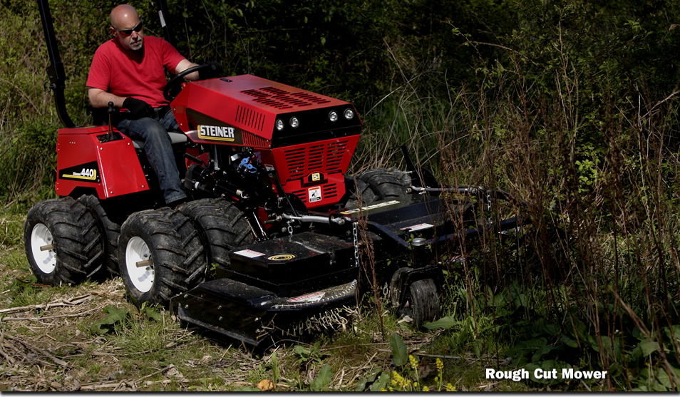

There are tractors made for hills
I've seen steiners on some amazing slopes.
