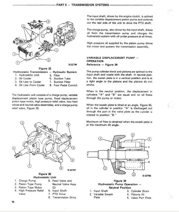

The schematic shows oil going over the high pressure relief flows from the high pressure side to the low pressure side. Since it is not dumping to tank, the relief is not the cause of your dropping charge pressure. The outside of your cooler looks sad, but that is not an indicator of what it looks inside. You are getting charge pressure so the circuit looks intact, but you don't know how much charge flow. I didn't read everything thoroughly but from what I did read, I didn't see anything about what the charge pump output should be. If the charge pump isn't putting out enough oil to make up for leakage in the high pressure loop under load, that would cause your pressure drop. Have you tried bypassing the cooler altogether to see if there is a restriction? I see the pictures of the piston slippers but couldn't identify if your pictures are of both the pump rotating group and motor rotating group. Are both shown in the picture?
All of the symptoms point through wear in one or more of the charge pump, hydro pump, or hydro motor. A piston pump like your hydro needs to be pressure fed or nasty things will happen like slippers pulling off the swash plate. If it has done much of this you should see things like erosion on the swash plate.
The feed valve/neutral valves on your system also show paths to the sump but I don't read much about them to know if the paths that bleed off leakage past these valves are large enough to caus loss of all your charge flow. It doesn't seem likely they are a problem though because your system works okay when it is cold.
Don't suppose there is someway you can beg, borrow or steal a flow meter to put in the charge circuit to see how much flow the pump is putting out?

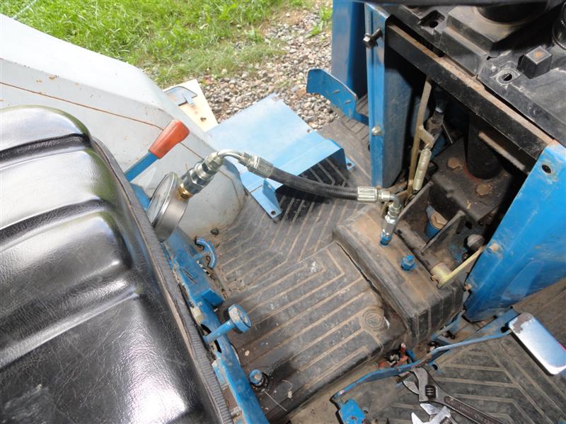

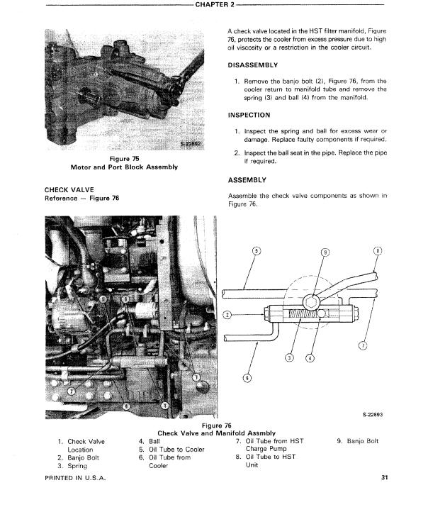

Thanks for the informative post Harry! It really does seem that the charge flow is loaw since it stays above 100psi until the fluid starts flowing through the hydrostatic motor.
Since I've taken off and checked/cleaned all the external piping and changed the filters, there aren't any blockages there, but the last place I haven't checked for a blockage is coming out of the sump in the rear transmission. I can't see that hole being blocked, but I should probably take the seat/rear fenders off and take a look.
I bought some clear hose that I thought I could put on the suction side (assuming the suction doesn't implode the hose - in which case there probably is a blockage somewhere). I was going to use that to make sure no air was in that suction line going into the charge pump. If it's solid fluid, then i'd borrow a flow meter and check that next.
I did bypass the cooler and it made no difference to the charge pressure.
Thanks again for taking the time to help me out,
Luke

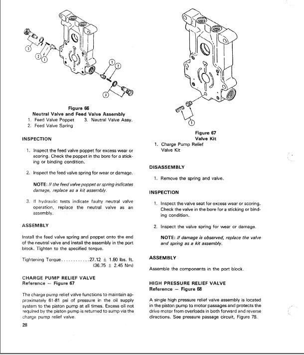

Your point about flow being better when it is cold brings up a point I've somewhat forgotten in trying to find the problem - as the fluid heats up, the problem gets worse.
As the fluid heats up it gets thinner, meaning that it's probably more likely that the issue has to do with the charge pump being worn and allowing oil to slip past it, rather than some blockage in the line or sucking air.
I'm not going to jump to that conclusion, but it probably is bypassing inside the hydrostatic drive somewhere.

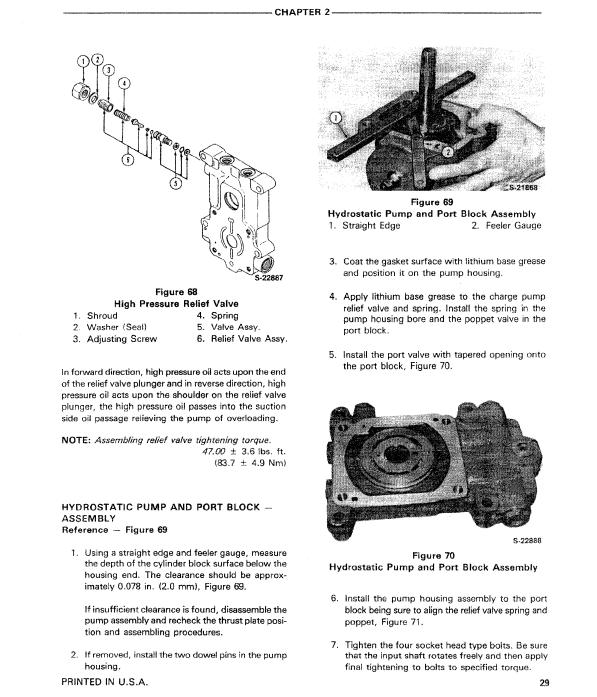

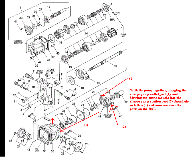

Something I haven't mentioned because I didn't think it was an issue is that when I had the hydrostatic drive out of the tractor, I plugged the output port of the charge pump, and blew air into the suction port (with my mouth), and some air seeped along the shaft into the high pressure orifice of the hydrostatic drive and came out the other ports. I figured it was probably just the way it was and one couldn't expect it to be completely sealed from air since the shaft had to spin, and spinning on a seal or o-ring would just wear it out. However, maybe that's the problem.....
When I took the charge pump apart, I looked for an o-ring and didn't see any o-rings that would go on the shaft, and there aren't any shown on the pump. I'm not actually sure how it seals and keeps the fluid from moving along the shaft.
/ Tractor squeals under load after getting warm #87
I am not sure what your gerotor uses for seals with the main drive shaft. I was thinking of using a flow meter to see if charge flow drops off as it gets hot and the oil thins out. If not that the next most likely culprit is wear in the expensive piston pump and motor. Your parts look so good though when compared to something like the rotating group I have shown here. This customer said the system which is a constant speed hydro kept slowing down until it stopped completely. It's hard to believe something can run long enough to be worn this bad. Your system may have worn parts other than worn slippers like this - pistons or barrels for example. Sure would be nice to find something less expensive to repair like a worn charge pump or defective feed/neutral valve - like an o-ring that isn't doing its job anymore due to age.

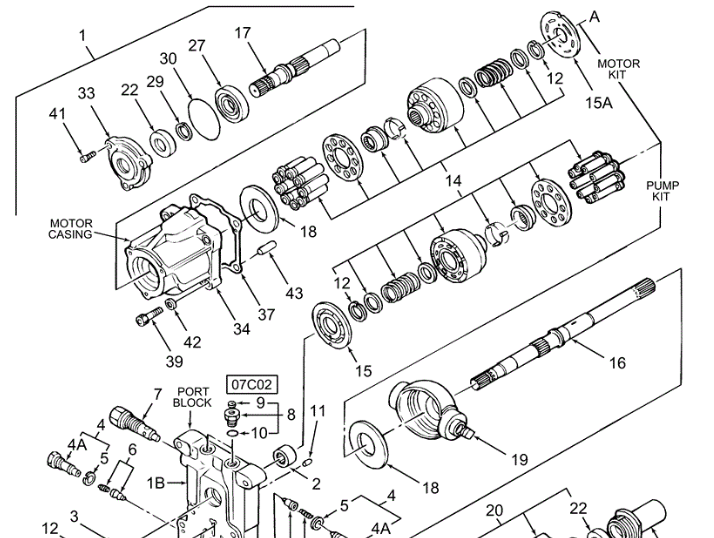

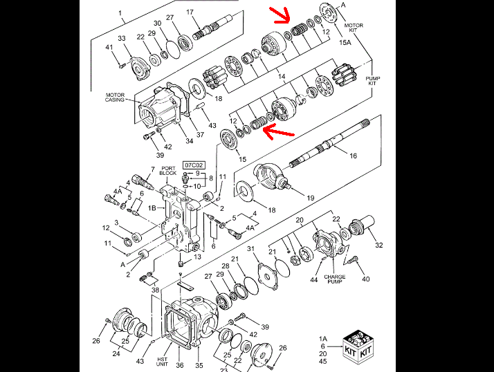

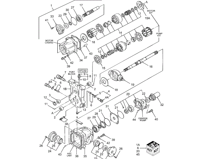

Attached is the HST assembly diagram. The HST actually has two rotating groups. I don't remember taking apart two. I'm not sure why it would have two, and what they each do? Having two would indicate to me that what I posted in the previous post is not true, or at least maybe one of the springs is not strong enough...

Best regards . . . Ed-
/ Tractor squeals under load after getting warm #95
Jim,
Wow, gotta check out Messicks.com tonite....I love breakdown sheets like these cuz the local dealers around these parts hold on to their "Interests" very tightly.....I'm just a repair guy taking work away from them (Until they need something from me:laughing::laughing:...
One of the problems Luke will have with testing on his machine is the Hydro Pump and Motor are one unit....(Cannot run flow meters between components to test).....may have to tear down anyways.....hopefully not but when do you just give up playing and get down to business and dig in...
The unit we rebuilt we changed valve plates (#15 & #15a), lapped barrels,pistons,new bearings, seal kit and go....:thumbsup:
Customer brought it in as basket case and saw nothing wrong with the wear on the critical surfaces....after we were thru it was back to climbing again...his unit had the same symptoms as Luke.....
Best would be to find proper test procedures as you suggested...I'm sure there must be ports to check charge, case and high pressure before he gets too deep...

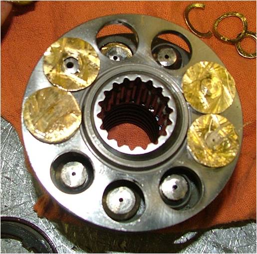

/ Tractor squeals under load after getting warm #96
"Customer brought it in as basket case and saw nothing wrong with the wear on the critical surfaces....after we were thru it was back to climbing again...his unit had the same symptoms as Luke....."
Luke, you have bad wear on your rotation groups......what you needed was a trained eye for the details of critical sealing surfaces when you had this apart the first time

I took off the clutch housing and removed the HST. The HST looks beautiful inside ...................
I just wanted to take out the HST and open it up to see if there was any obvious wear inside, and to see if there was any obvious problem with the relief valve, but it all looks fine to me...........................
Luke
It doesn't look fine......you have wear on the faces of the piston barrels and valve plates resulting in internal by-pass
the plates can be replaced and the barrels and pistons need to be be lapped.......but if the pistons in the bore of the barrels are sloppy or the shoes on the end of the pistons are loose (even slightly) then new rotation groups need to be ordered
the wear I'm talking about is on the mating surfaces and there should be absolutely no scratches felt with your finger nail......if you can feel ANY imperfections then it needs to be precision lapped (valve plates need to be replaced with new)......

I'm having trouble copying the pix but it's in the post #65.........the eighth pix showing the bottom of one of the rotation groups
BTW, the reason for two rotation groups is one is actually the pump, the other is the motor side

BTW, charge pressure decreases because of excess wear on rotation groups when engaging the swash plate....charge pump's job is to replentish oil on the suction side of the pump (depending on which way the swash plate is operating.....if the charge flow can't keep up with the excessive wear (by-passing) then the charge pressure drops too low, resulting in more wear and destruction of pump parts from cavitation on the suction side
