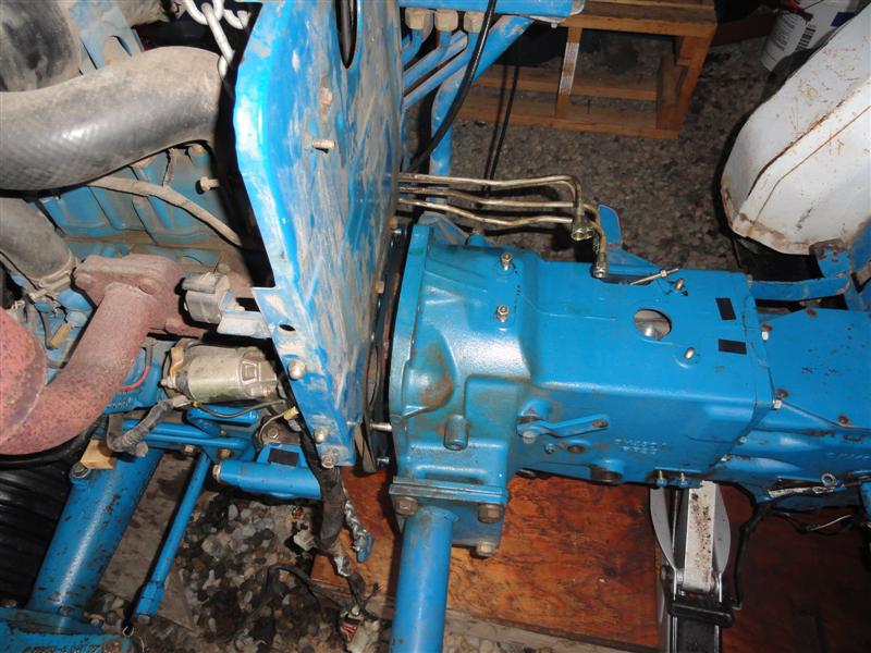

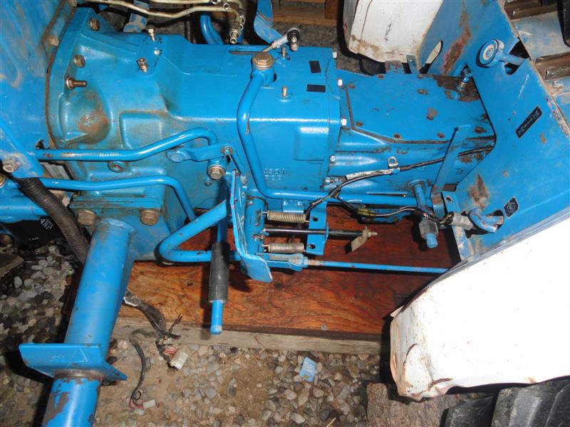

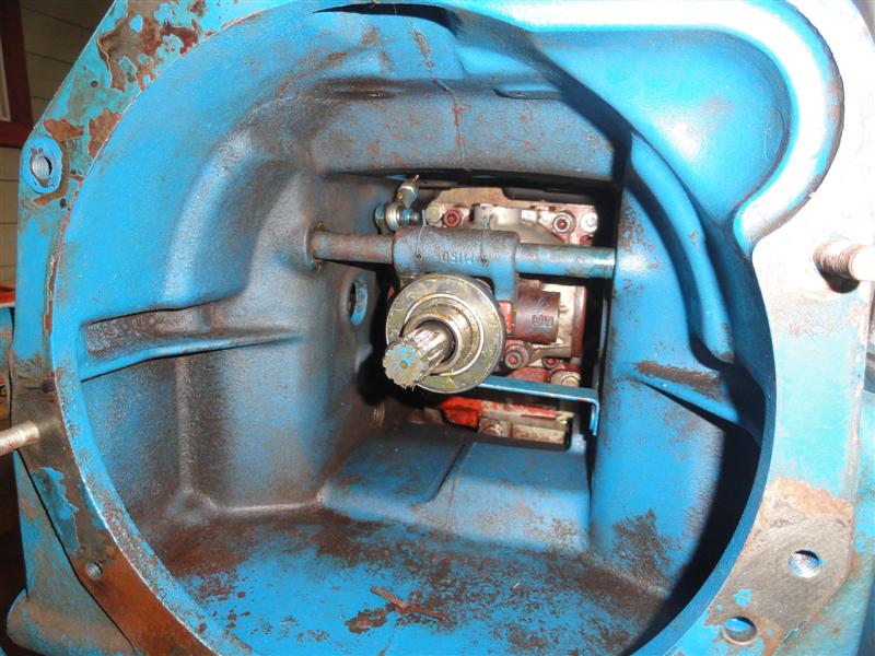

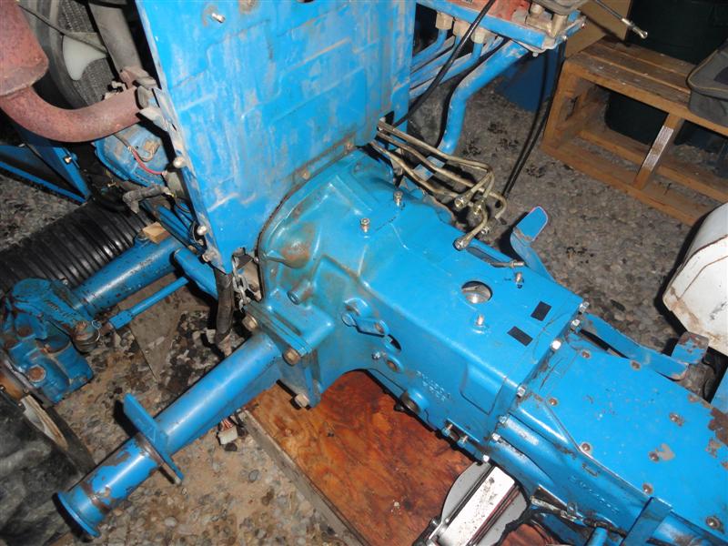

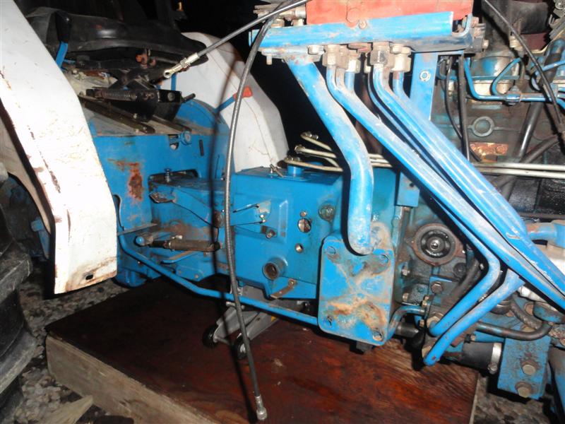

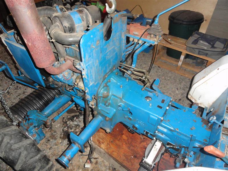

I took off the clutch housing and removed the HST. The HST looks beautiful inside and the high pressure relief valve looks fine. I guess there's a possibility that the high pressure relief valve spring is slightly weaker, but because of the underlying symptom - pressure drops as engine heats up but not necessarily as hydraulic fluid heats up, points me to the clutch being the entire problem. If the clutch was slipping, then theoretically the longer the tractor ran, the more it would slip and heat up and thus the easier it would slip.
I just wanted to take out the HST and open it up to see if there was any obvious wear inside, and to see if there was any obvious problem with the relief valve, but it all looks fine to me.
I could add an extra washer to the relief valve to increase the pressure that the valve would open, but it's probably smart to replace the clutch, put it all back together, test it out, and if there is still a problem try to pinpoint the issue further and then re-take it all apart and fix the next thing that it possibly could be.
Let me know if anyone has any thoughts on the HST or relief valve.
For anyone trying to take the HST out of this tractor in the future and not being able to remove the clutch housing, the bearing going to the front drive axle, as shown in some of the attached pictures, was completely seized to the shaft and finally came loose after spraying anti seize spray (liquid wrench) around the axle and let it sit for a while. I then had to lightly tap the shaft tip with a hammer to get it to slide backwards through the bearing.
Luke

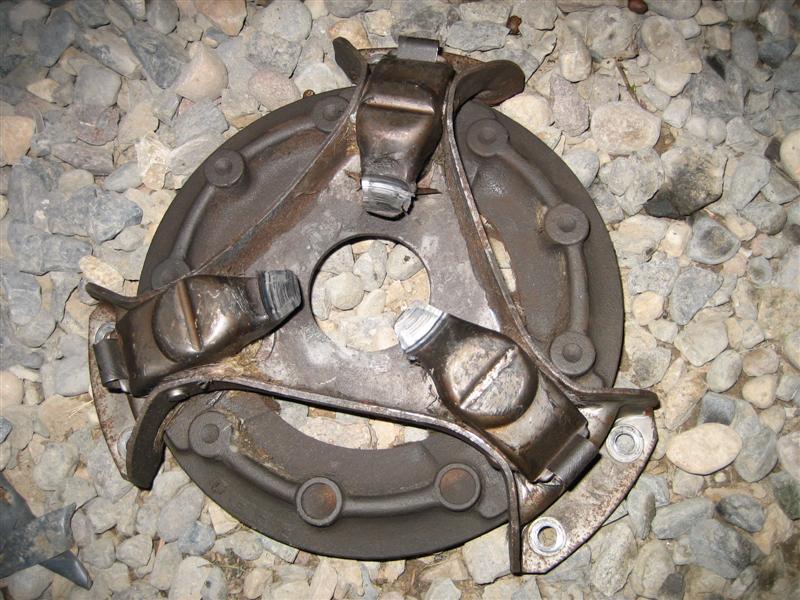

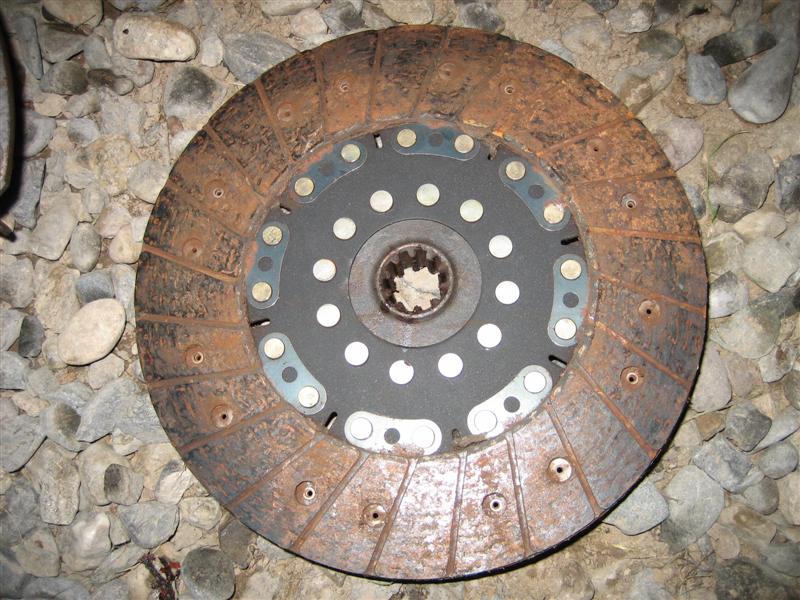

Looking at the clutch it's wonder it drove at all. The valve plate on HST looks like new yet. I wouldn't change anything there, put in new clutch and throwout bearing and try it.

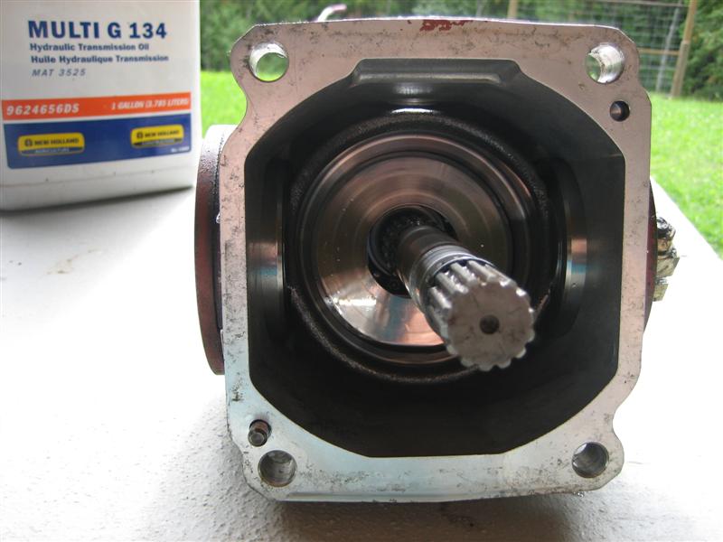

Here are some more pictures of the hydrostatic drive. It looks brand new inside!

Looking at your sparkling clean HST's inside and the dirt on the outside of the transmission, I just hope you are being extremely careful to keep any crud out of the transmission. I'm sure you will be very meticulous, but seeing the contrast in your photos makes me cringe a bit.

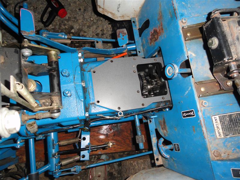

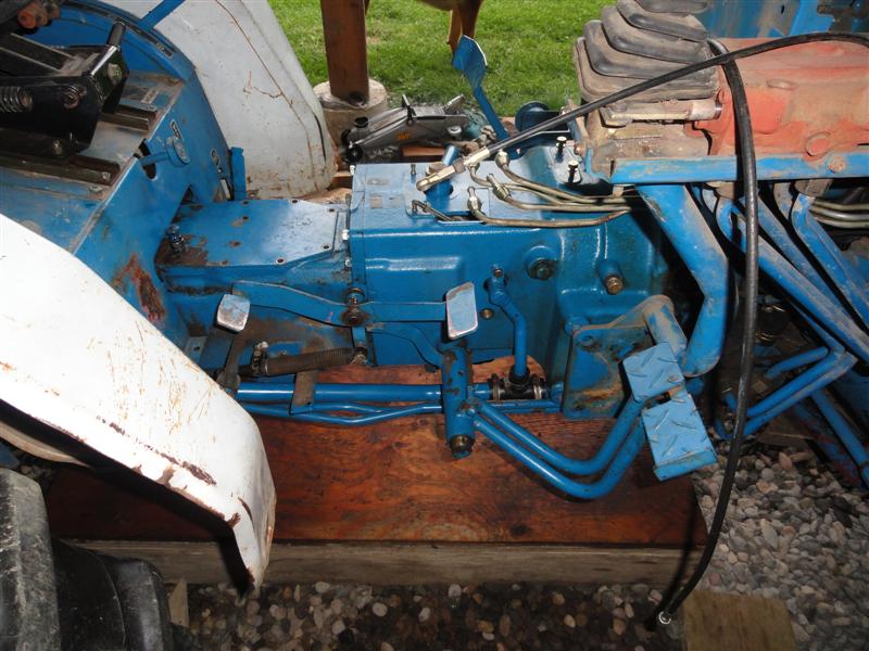

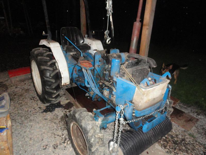

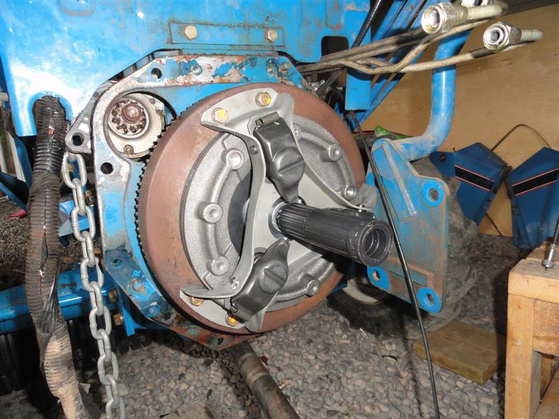

Well, my clutch finally arrived and I put it back together enough to test it out. Guess what?! It works just as well as it did before I took it apart!!!! That means I haven't made it any worse, but it still bypasses fluid somewhere and squeals around 2600psi and gets worse the longer it's driven.
A few weeks ago I bought a few implements that I got a good deal on. Yesterday I tilled a couple of acres with the rototiller and it didn't squeal at all in low range until I started tilling up a not so steel hill. The tiller runs off the PTO and actually helped to push the tractor up the hill when the tractor started losing power.
The squeal sounds like it's coming from inside the HST somewhere, but I'm not sure what else to look at in there, not to mention that it takes a couple hours to open the tractor up - draining power steering fluid, hydraulic oil, engine oil (the filter blocks a bolt)...
Luke

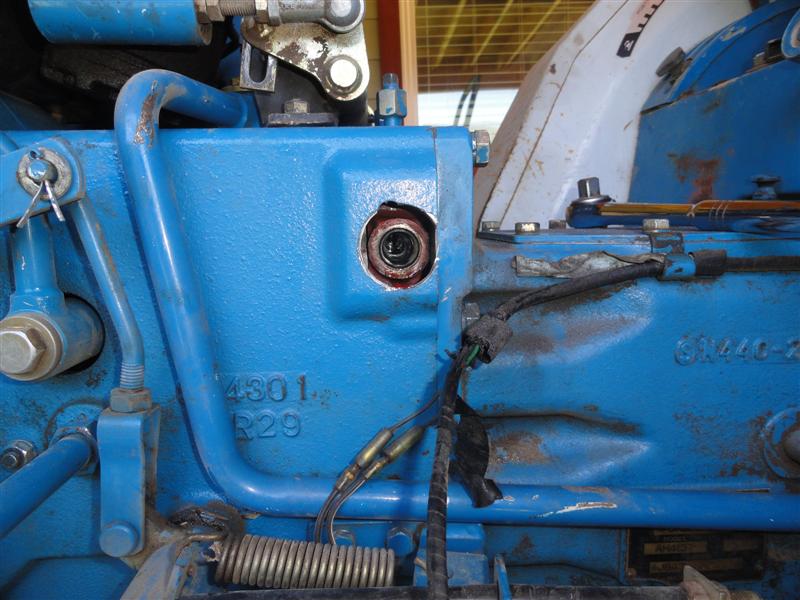

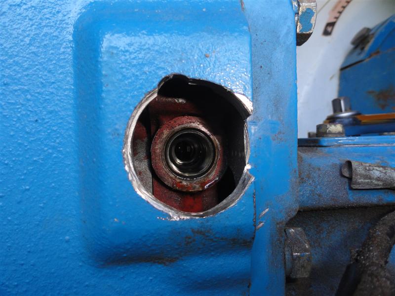

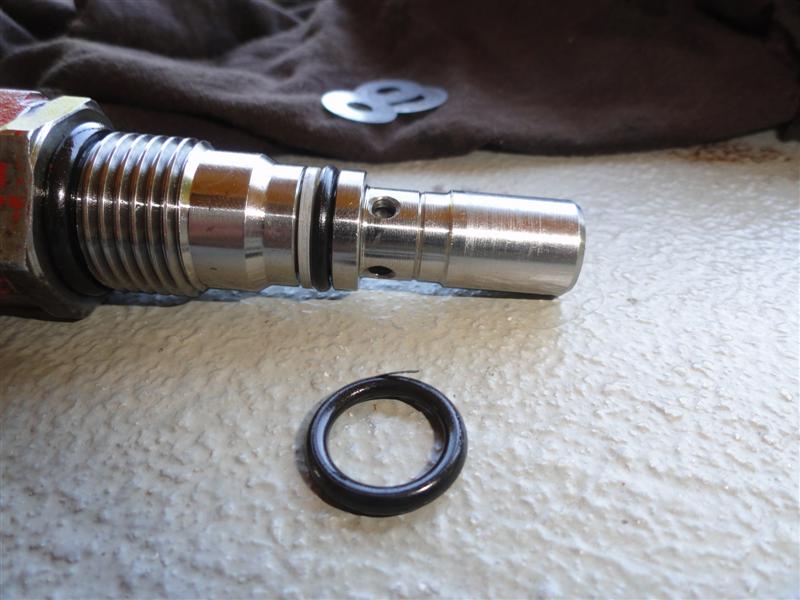

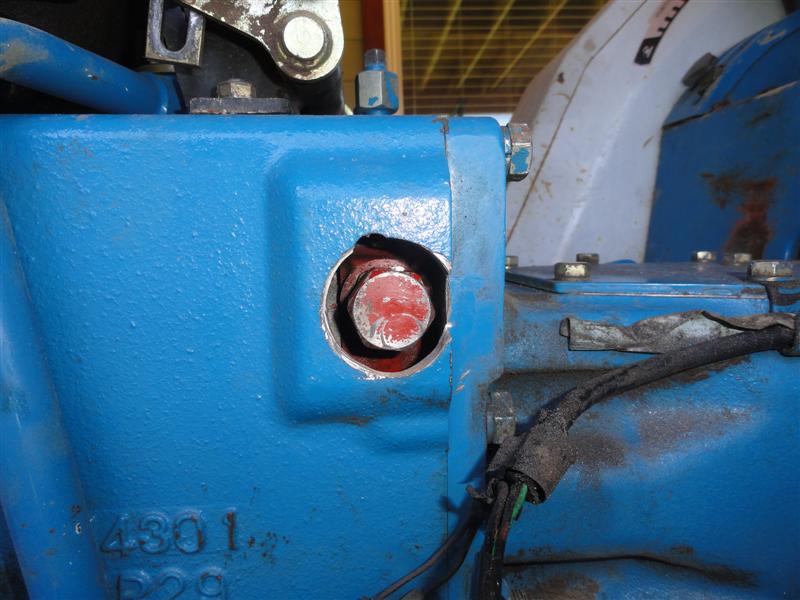

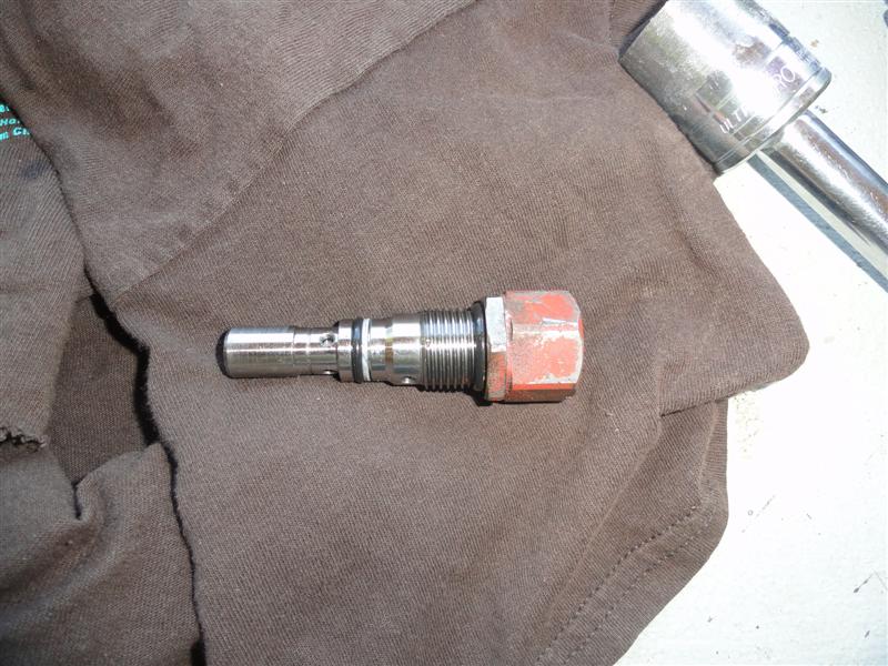

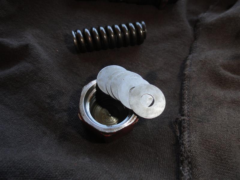

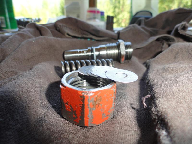

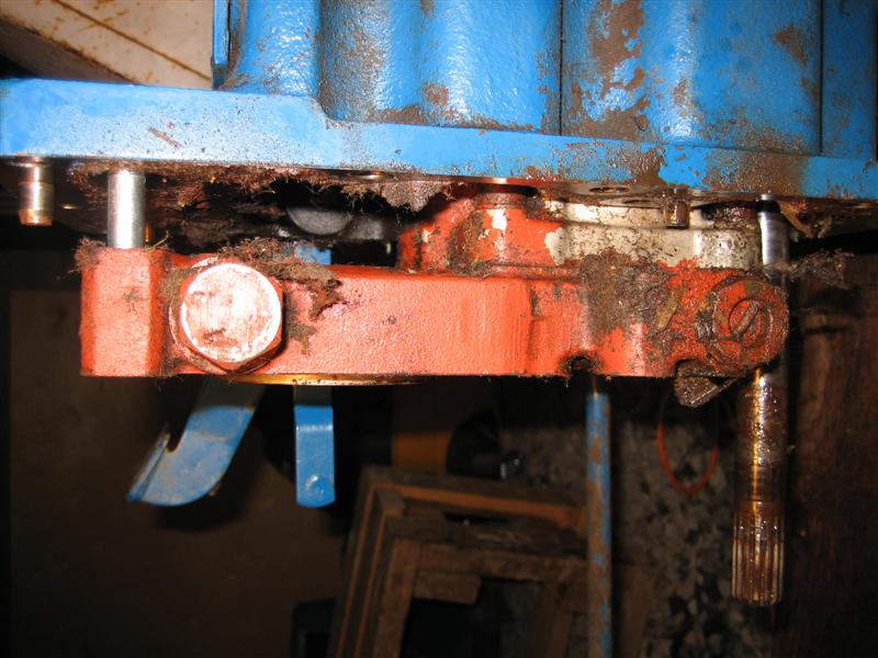

Today I decided to make a high pressure relief valve removal port instead of splitting the tractor. It was very easy to drill a hole through the housing, and I don't think it will weaken the mid section at all. I'll just have to find a nice plug to put in the opening.
I removed the high pressure relief valve, took it apart and found an o-ring that had a very slight slit in it, so I replaced the o-ring. I also added an extra washer to the ones that were already installed as spacers to slightly compress the spring. I figured I should see a difference if the spring has weakened and the issue is the relief valve.
I put the relief valve back together and back into the tractor (30min total procedure!!). There was no change whatsoever at the point that the HST started squealing with the brake on, engine running at 2500rpm, in high range, and then pressing slightly on the pedal either forwards or reverse.
Unfortunately I don't think there is an issue with the relief valve, but now I have no idea what else it could be.
Does anyone have any other ideas?
Thanks,
Luke

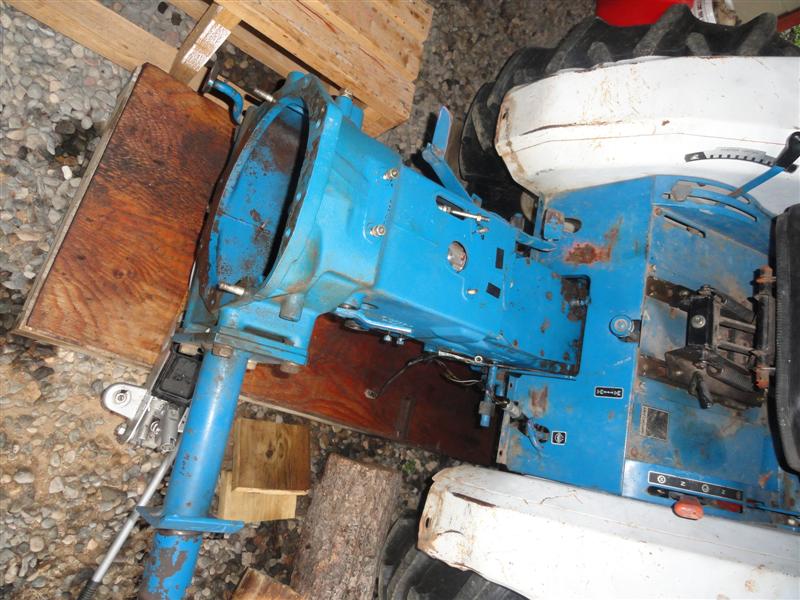

I hope that tractor NEVER has a FEL attached. That big hole in the bell housing will compromise the structural integrity. Don't know how much, but the hole there is making it weaker.
/ Tractor squeals under load after getting warm
#73
I actually don't think it'll make it any weaker at all because that section juts outside of the rear transmission housing and doesn't contact it at all. Also, because there is a bolt both above and below the new access hole, that section wouldn't have been adding much to the strength. I'll watch it though and see if any cracks begin anywhere in the bell housing. My bet is that if the bell housing was modeled in a program like Solidworks and analyzed for stresses through the material, there is probably little stress in that area, but of course, that's just my opinion. I'll bet that the reason an access hole was not created at the factory was to make it so dealers had to open the entire tractor to get to the valve so there was more money to be made in labor.
I'll let you know how it holds up after I put the FEL back on and do lots of work.
Thanks,
Luke

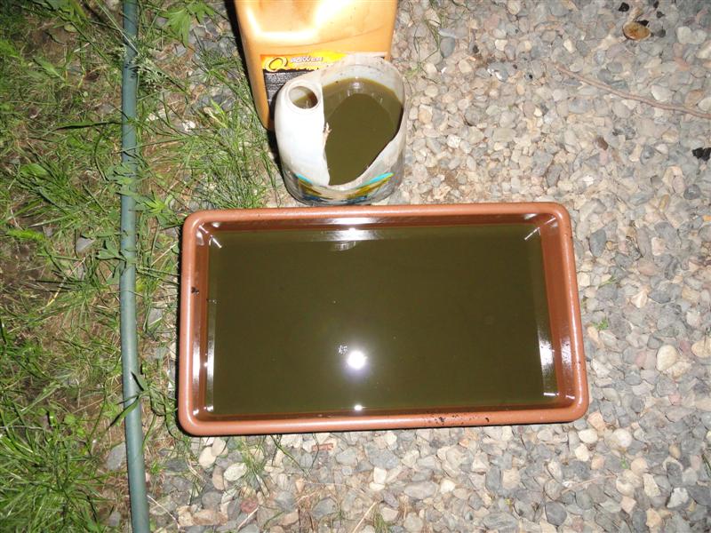

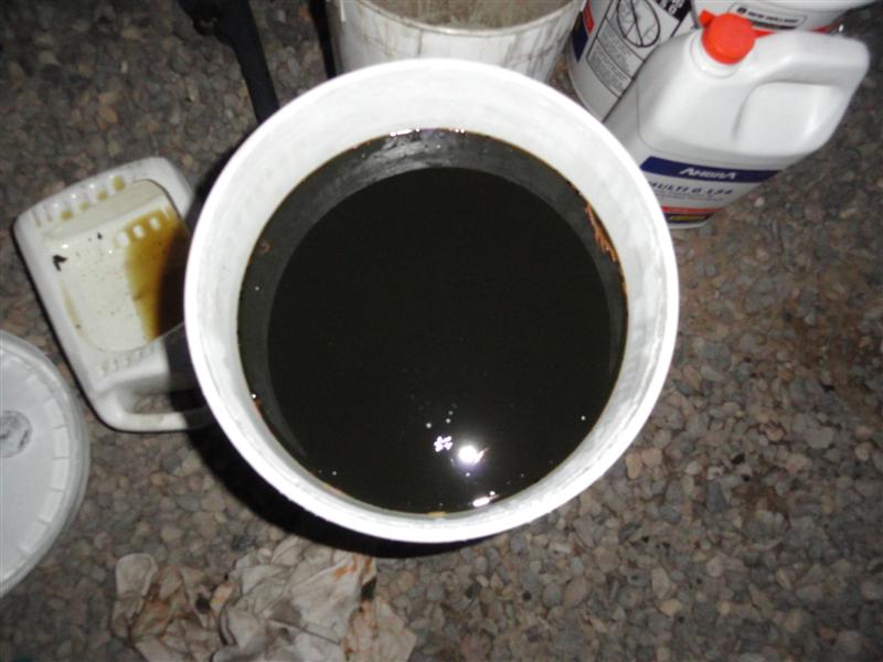

Things I have done so far:
Changed both hydraulic filters, the suction filter and the filter after the charge pump.
I have changed the hydraulic fluid to the fluid recommended by Ford New Holland (Ford 134).
I have removed and cleaned all the hydraulic lines.
I checked all the o-rings on the suction side to make sure it wasn't sucking air, and they all seem good, although I replaced one of them.
Checked the cooler to make sure it wasn't clogged at all, and actually bypassed the cooler but it made no difference.
When the above didn't solve the problem, I separated the tractor, took out the hydrostatic drive, opened up the charge pump and it looks very good - no scoring or anything else out of the ordinary.
I looked at the charge relief spring and it looks fine (not broken but could be weakened I suppose, but if it was weakened I would assume that the charge pressure wouldn't even be able to build to 90psi).
I adjusted the high pressure relief valve (both higher and lower) to see if that could be the issue even though it's pretty clear from the lack of charge pressure that it isn't the problem, but it didn't make any difference at all so I reset it.
After doing all the above (which meant separating and re-connecting the tractor a few times) it still behaves exactly the same as it did before I did the first thing which was change the filters and hydraulic oil - the pressure still builds to 2500psi and works worse as it warms up.
