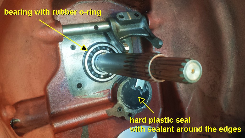

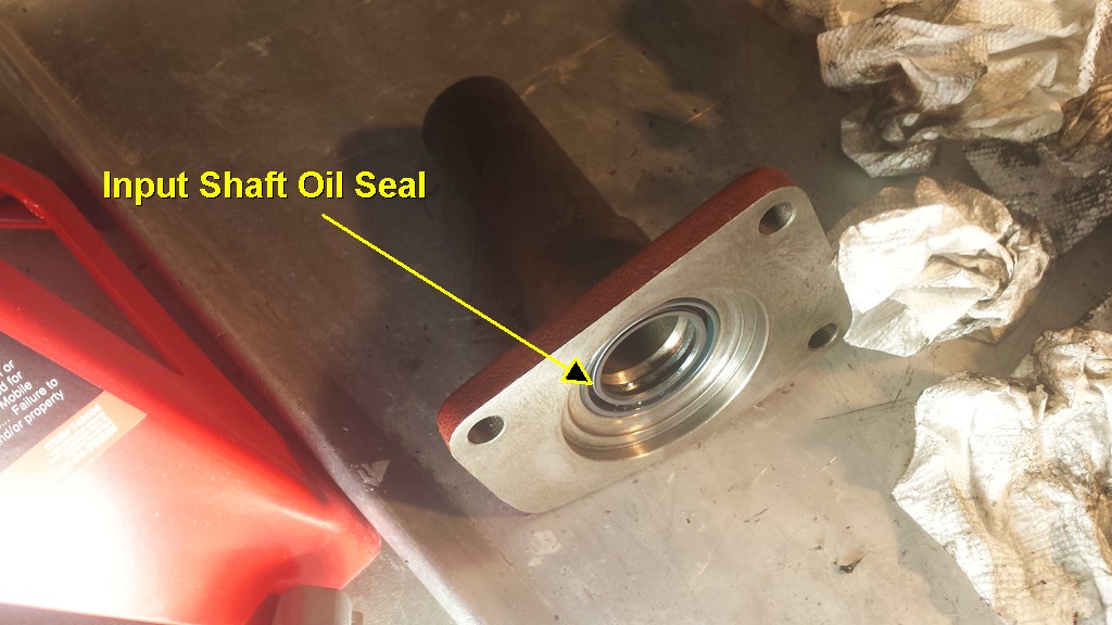

OK, so here's a picture of the input shaft seal and input shaft bearing.
The input shaft seal is easy to remove & replace. The input shaft bearing has a rubber o-ring around the outside edge. I'm reluctant to dig into it until I completely understand what's there.
The black seal has sealant around the edges. Guess I need to dig out the sealant and pry out the black plastic seal (destroying it)? Guess the new seal somehow taps into the hole?
Thanks!
Thanks!
The o ring on the bearing looks like it seals the output housing at the bearing. I would replace it.
Did you put any sealant on the OD of the seal? I use sparingly, Permatex Aviation Form-A-Gasket No 3. I would also us it on the black plug.
I would get a new black plug before trying to remove the old one. If I had a new one "in hand" I would not worry about destroying the old one.

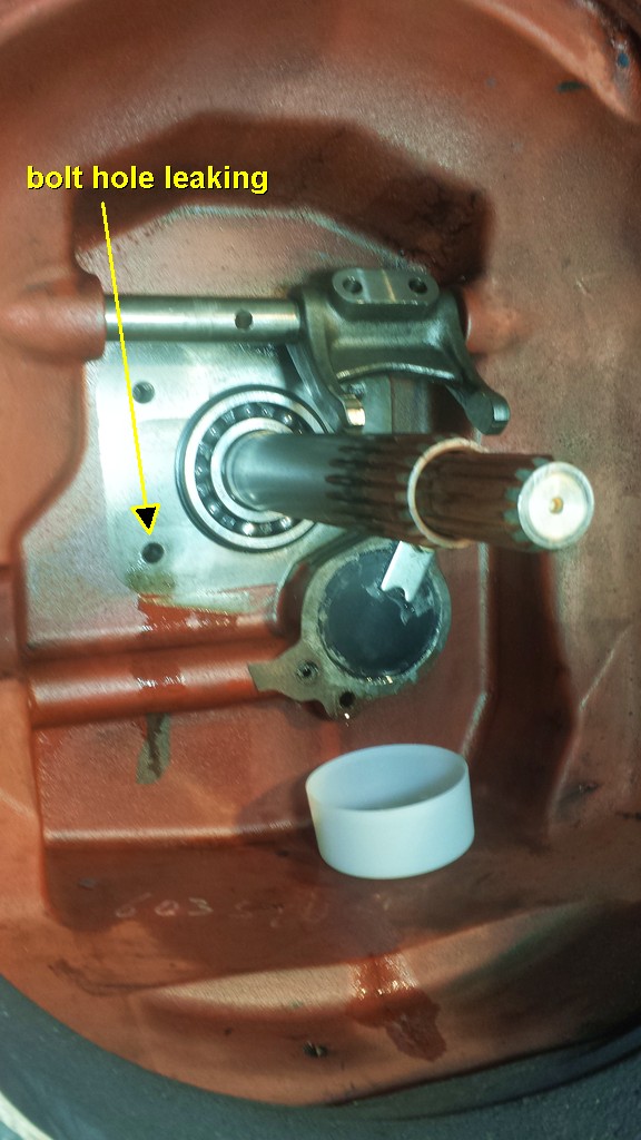

Good points. Also, the 4 bolts that holds the output housing on, are they blind tapped holes? If they are not, you should seal the threads. Being that you have a mystery leak, take a careful look to see if a tapped hole broke out into the inside of the case.

Funny you should mention that, I was just about to post this pic showing the bolt hole leakage from overnight.

I will seal the threads on all the bolt holes. Might put a small bead around the outside of the whole mating flange as well.

At least you found a smoking gun in your leakage problem.....good deal. Back in the day, we would use Permatex aviation to seal threads like head bolts. It looks like there are many products to choose from now.

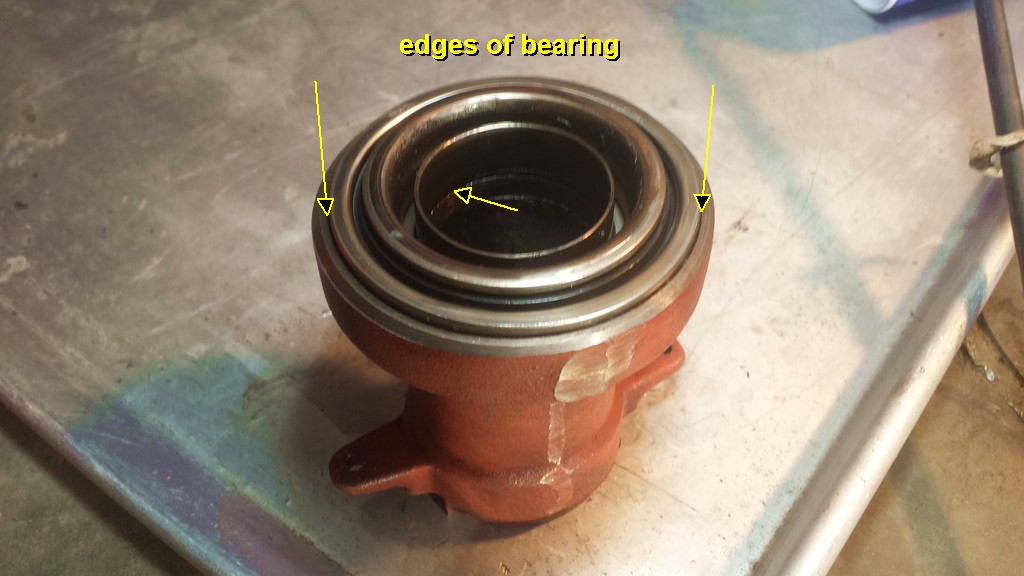

I'm wonder how to go about removing the throwout bearing from the hub?
The edges are very tight and I can barely get a pick in there. Do you think the bearing is pressed into the hole?

Should I use a penetrating liquid down in the cracks to see if it will loosen up? Overall, the bearing looks to be in good shape but I would like to replace it with a new one.
/ Tractor split - the Insides #33
Usually needs to be pressed out from the other side.
I'm almost sure that they make that a press fit. So even you could get a pick behind, it wouldn't move.

Talked with my local machinist and he can press out the old throwout bearing and press in the new one when I get it.
Removed the black plug/seal. Turns out it is metal, not plastic. Was loose enough that when I touched it with a small flathead screwdriver, it slid back in its hole about an 1/8 of an inch. Put some duct tape on it and it pulled right out. Even though you can see someone applied some kind of sealant on the outside surface... it was very minimal and the seal is very loose in the hole. Needs a more substantial bead around the edge to make it seal oil.

Interesting that it is that loose in the hole, it looks like it has a retainer on the upper side,
I wonder if it should have one in the opposite side lower?
With it being loose I'm surprised it didn't have an o-ring on it.

There are already threads in the opposite side lower hole. Looks like it was designed for two retainers but they only had one installed. Not sure the upper one was even touching the seal as the seal was able to move inward about an 1/8 " easily. I think with proper caulking, the seal will stay in place and actually seal.
