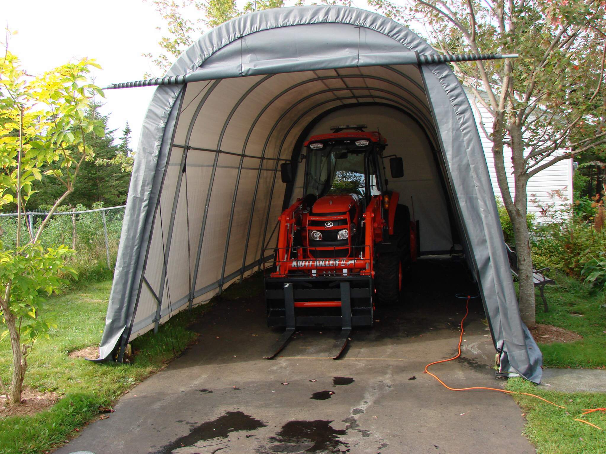

ShelterLogic for my 5740. Been there for four years and still like new. Very happy with it.

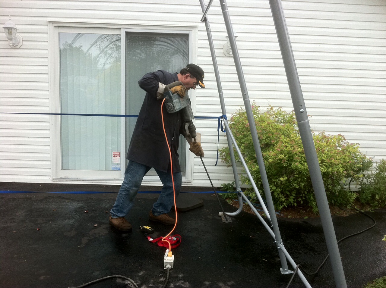

Does it need to be anchored to the ground? The ground is frozen.

That's the trick to a successful life with your shelter. Nail it to the ground, you don't want it blowing away. I welded plates to the bottom of the pipes, drilled holes in the plates then got a ground rod driver and hammered about a dozen 42" lengths of rebar in the thing. It will not move, not even during a tropical storm and we've had three of them since my shelter has been in place.

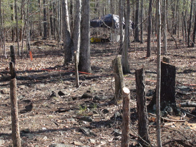

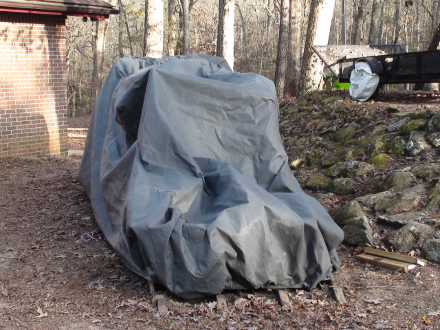

My tractor is 35 miles away at my densely wooded, very rocky property I am clearing for a home site. I have no room for any kind of stationary shelter and use a $90, large SUV type car cover. I put the ROPS down to allow the cover to engulf the tractor to ground level. Works great for a portable unit, as long as one does not need shelter and be able to work on it at the same time. I do not have a pic of the covered tractor, but do of the property. You could also use a combination of car cover and 12' x 12' popup canopy like what I have for my storage of fuels, chairs, etc, most of which are stored in a large, outdoor, deck-type storage box. The canopy cover on these are usually not very robust, so I have a very heavy duty 14' x 14' tarp over the top of the canopy. There are a lot of options.

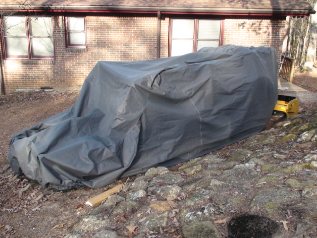

View attachment 360964View attachment 360965

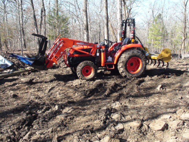

Found photos of the tractor covered and not:
