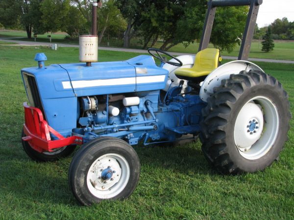

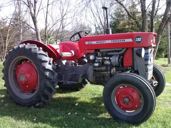

OK guys, found a couple tractors that seem to fit my criteria. Share your thoughts, both in terms of reliability, potential repair cost differences, functions/features that are good bad, etc. Basically do you feel these are a good match for me and if so which one and why.
MF135 Perkins Diesel 2100hrs well maintained in very good condition(their words, not mine), 4spd hi/low trans, live power, pto, newer tires and battery, tool box, extra lighting, $4900
Ford 3600 3cyl diesel 4200hrs, 8fwd speeds/2rvs, tires and rims are good(not loaded). He replaced a tube in one rear, water pump new 2yrs ago, injector pump rebuilt 2yrs ago($1800), 1 remote out back. $4500

That MF is a 130 not a 135, is that correct? . Why is a 9n bad? A 3000 series is better.

Murphy good catch. In my mind I thought it was a 135, but it is a 130. These 2 tractors are apples/oranges, thanks for bringing that to my attension.

Both tractors would easily fill your niche for food plotting and snowblowing. Both have live PTO which is a real bonus for snowblowing/tilling. The ford has the bonus of 10 more Hp over the MF and a rear remote which would be nice if you ever decide to pull implements with a hydraulic lift cylinder. IMO I feel both are priced a little on the high end. I would say 3500 max for about either of them. If they don't bite no worries there are plenty of tractors for sale in Michigan that will fill your need.

A lot of these old tractors have a lot of life left in them you just have to be pretty thorough in looking them over. I always bring a compression gage with me to check the cylinder compression. This will give me a real quick idea of whether or not it has some worn rings or in need of valve job. Check for blue smoke. Run the tractor through all the gears/PTO, Stand on the brakes and see if the tires lock, then run the tractor in lowest gear and depress the brakes gradually (to create a load on the tractor) to see if the governor works correctly and the clutch isn't slipping. Don't do this for prolonged periods because sellers automatically think your trying to glaze the brakes and burn the clutch but you are the buyer and with these things all sales are usually final so it makes sense to check them out. Minor oil leaks from seals/gaskets are to be expected so I don't put much value on what is dripping. Most leaks from my experience are more of an eyesore than anything. Hope this helps with you finding a future tractor to fill your needs. Have any additional questions feel free to msg me.
