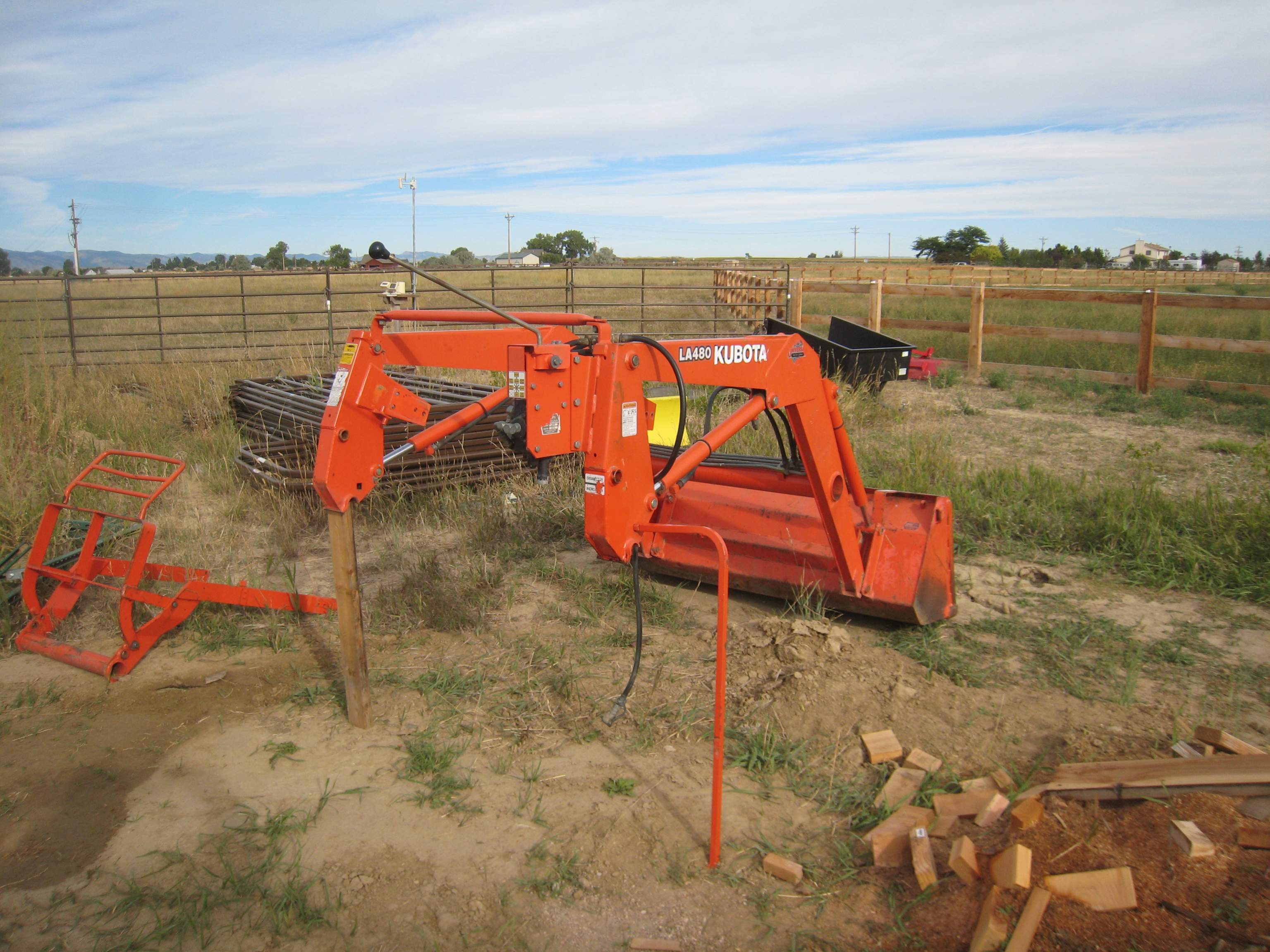

In Thanksgiving 2009, I purchased a Kubota B8200 HST to help build a horse pole barn for my wife. After breaking ground in December and working every spare moment, every weekend, all vacation, many, many evenings, the barn was completed in September 2010. During that time the 8200 was indispensable lifting, moving, and pulling. I got it from a local repair shop. The head mechanic had just rebuilt the engine and I bought it from him. It basically only had wiring to start it and fire the glow plugs. I replaced the wiring for the lights, flashers, and dash and also replaced the tach/hr meter cable and then the spinning sender unit on the front of the engine attached to the fuel cam. That all was fun so I've been looking for something a bit more challenging. Especially now since I have a nice large space in which to work since the barn is completed.

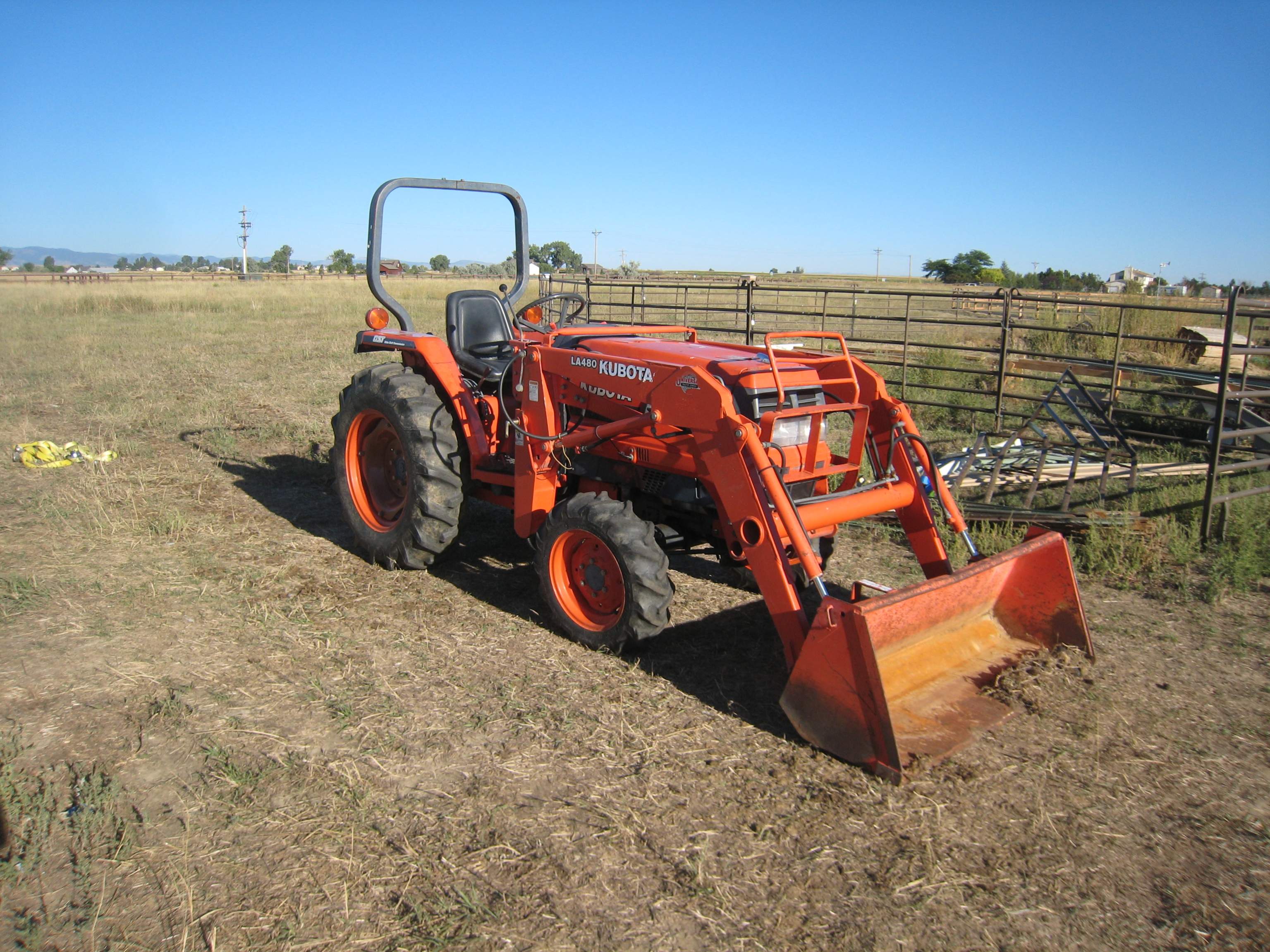

In October my wife found a Kubota L2900 GST with loader on craigslist. (I've got a great wife!) It had a seized engine. Everything else was supposed to be running just fine but it's kind of hard to tell when the engine doesn't turn over. The hr meter said 580 hrs. The starter engaged but wouldn't turn the engine. There were no leaks. The owner suspected a seized connecting rod bearing and he also gave me a set of new seals for the front axle. It was a great price and I bought it on impulse. Kind of high risk in that it was thousands of dollars and I've never done any real engine work. Worse case I'd have chalk it up as very expensive entertainment.

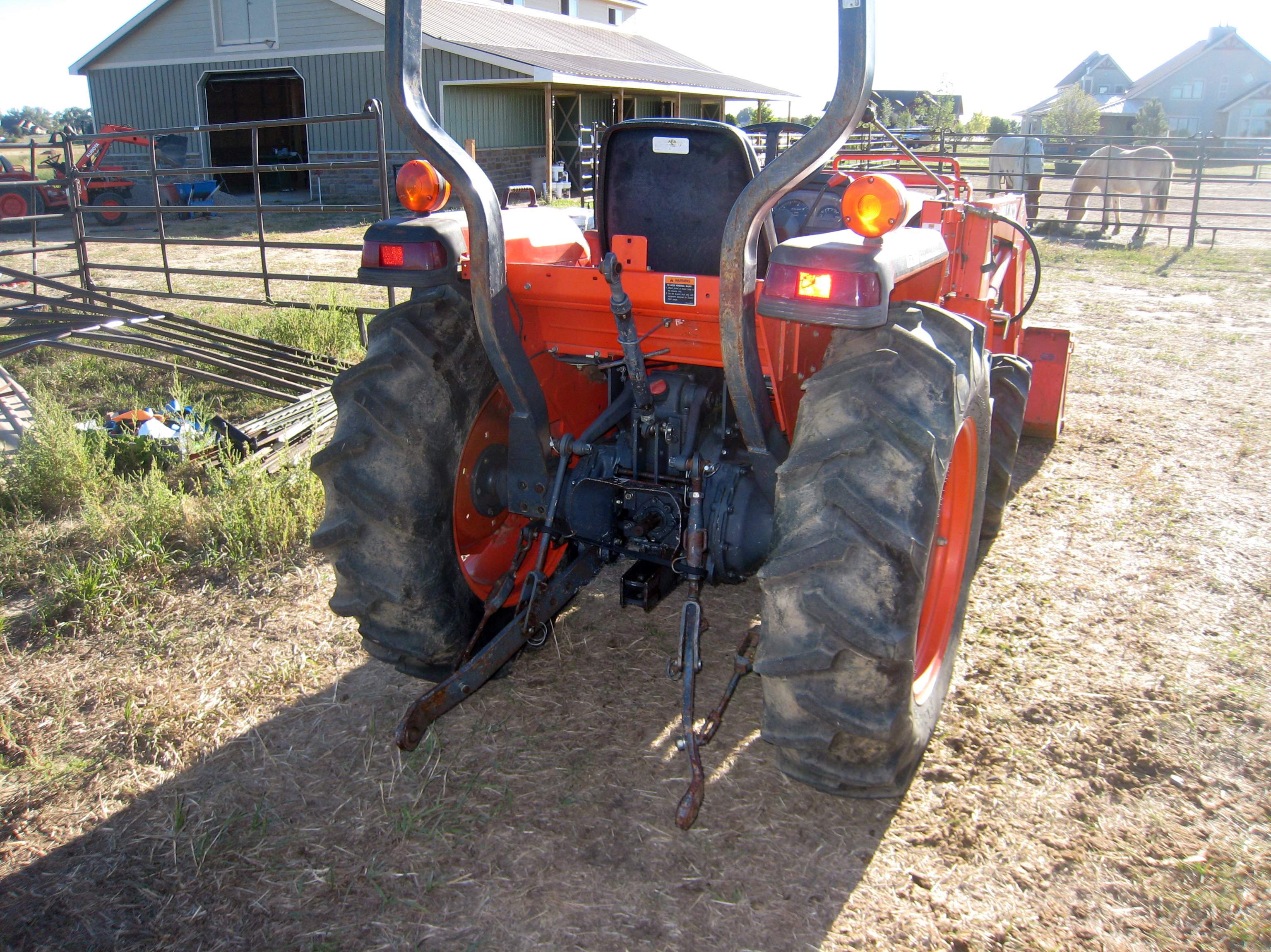

After getting the tractor home the first task was to remove the loader. No engine function = no hydraulic function. This was one of the hardest parts of the entire project. The previous owner had one of the back pins out but not the other one. The loader was kind of skewed binding up the other pin like you wouldn't believe. I was pulling on it from all directions with my other tractor. There was no access to poke the pin out from behind and it took hours to remove. Finally figured out that if I spin the pin around and around by banging it a million times with a large hammer, it would finally spin out. I was very concerned that the loader had been twisted out of alignment by some nasty act like rolling the tractor. Figured I'd save that problem for another day.
I rolled the tractor in the workplace and began to plan the cracking adventure.

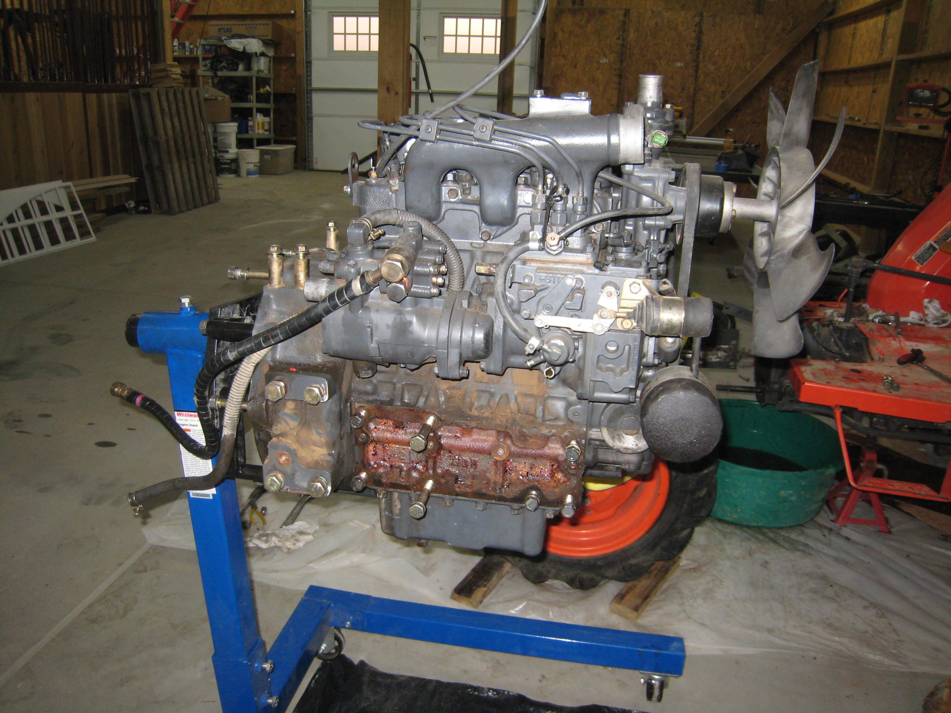

Remove the pressure plate, clutch, and freewheel, and mounted the engine on my engine stand. Sure enough that sucker is seized. No amount of force is turning the crank. On the positive side, makes it easier to bust loose the freewheel bolts.
The hyrdo pump is much larger than on my B8200. I hope that translates into greater loader lift capability.
For those interested, this is a D1503 Kubota engine - 3 cylinder, 1.5 liter, 30 hp model. Non turbo. This is a popular engine series that includes a D1403, 1503, 1703, 1903 and 2203. Maybe a few more. Surplus Center has a new 1903 42 HP model for $3800 or even a turbo 2203 for $5k. Should I put one of those in there instead? :)

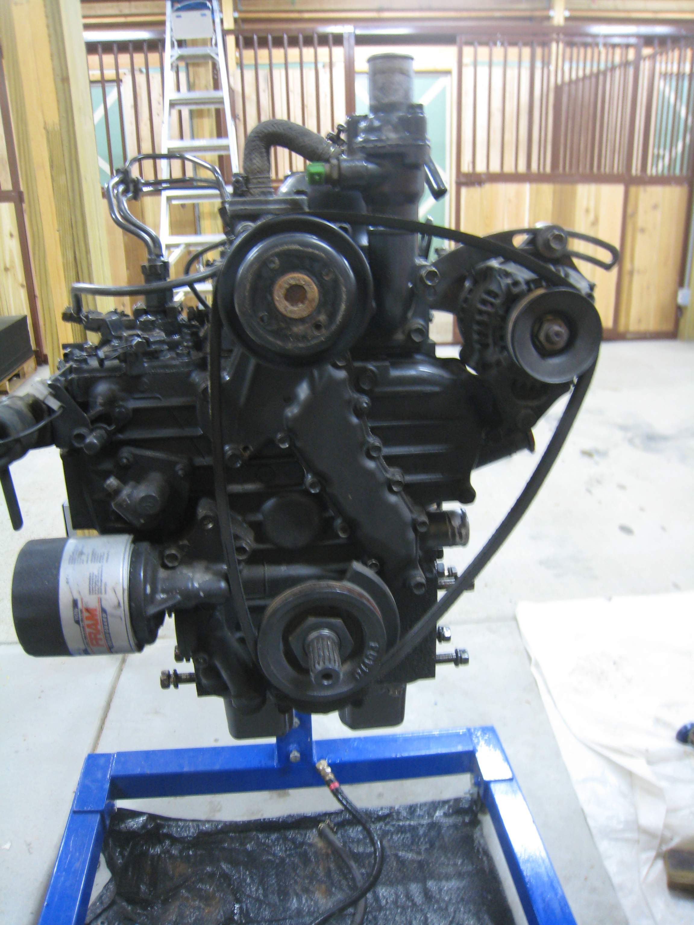

I've encountered my first tool problem. There is a big nut holding the pulley on the front end of the crankshaft. Worse, the crank extends out well beyond the nut. Not only can one not use a regular flat wrench on the nut because it's recessed in the pulley, but one can't use a regular socket either because of the extended crank. Note that the end of the crank is splined and it is torn up. Nothing goes on the end here and I'm not the one who apparently grabbed it with vicegrips. No rental places had a deep 32mm socket so I had to order one online. Also bought a 3/4" socket handle to drive it.
This nut was a bear to get off. The book says to retighten it to 160 ft/lbs. It took both my neighbor and me to break it free one person to hold the wrench on, the other to twist it. The socket thickness is a bit too great to get good purchase on the nut inside the taped indentation in the pulley. But we got it. Even with that great force, the engine crank didn't budge. It's really frozen.

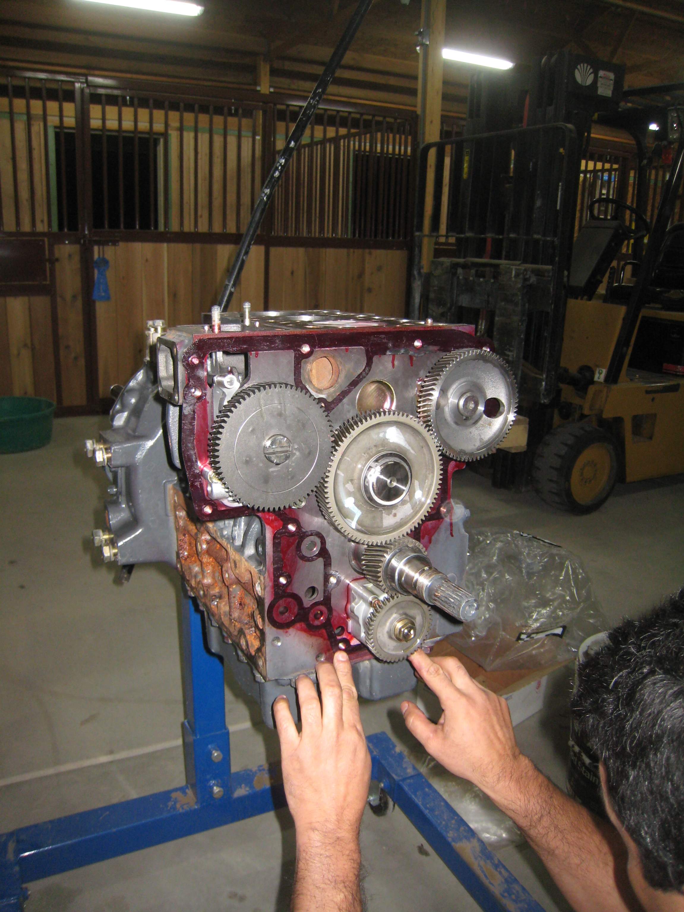

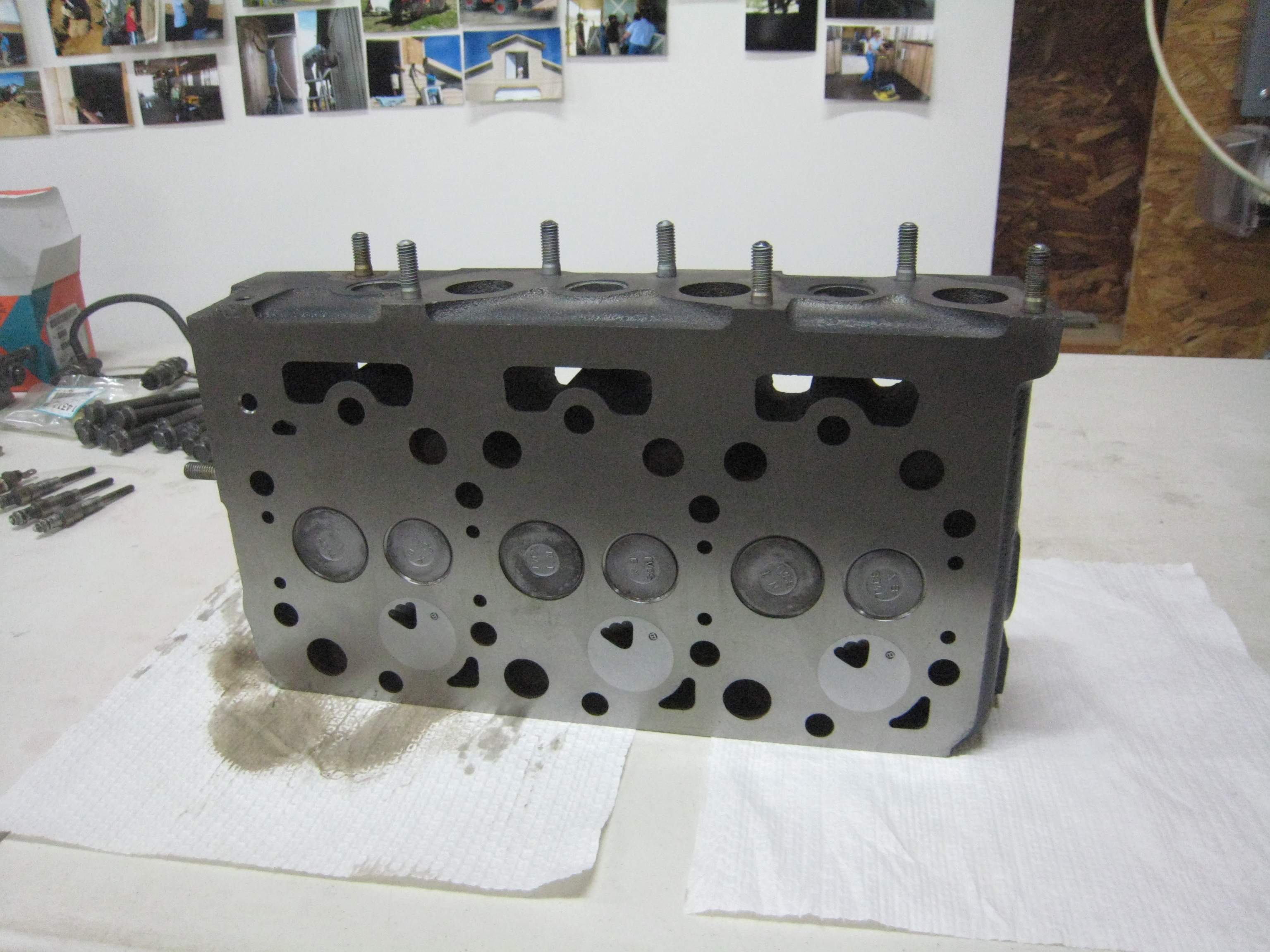

Removed the head, push rods, lifters, oil pan, injector pump, oil pump, and camshaft. Pulled out pistons. Crank still wouldn't turn. Has to be some type of crank bearing problem
Just FYI if you are interested, the frontal picture shows the engine with the gear cover removed. The top left gear is the injector pump cam, the top right gear is the valve camshaft, the middle gear is the idler gear which connects the crank to the camshafts. The bottom geared thing is the oil pump.
The timing marks were very easy to see on the gears so it was pretty simple to ensure that cams were aligned with the crank.
Even though there is no spark, a diesel engine still has the notion of timing. In this case, timing refers to the time at which the fuel is injected into the cylinder. For these engines, timing is adjusted by adding or removing shims underneath the injector pump plate. This varies the distance between the fuel cam and the injector pump followers. Adding a shim delays or retards the fuel injection timing.

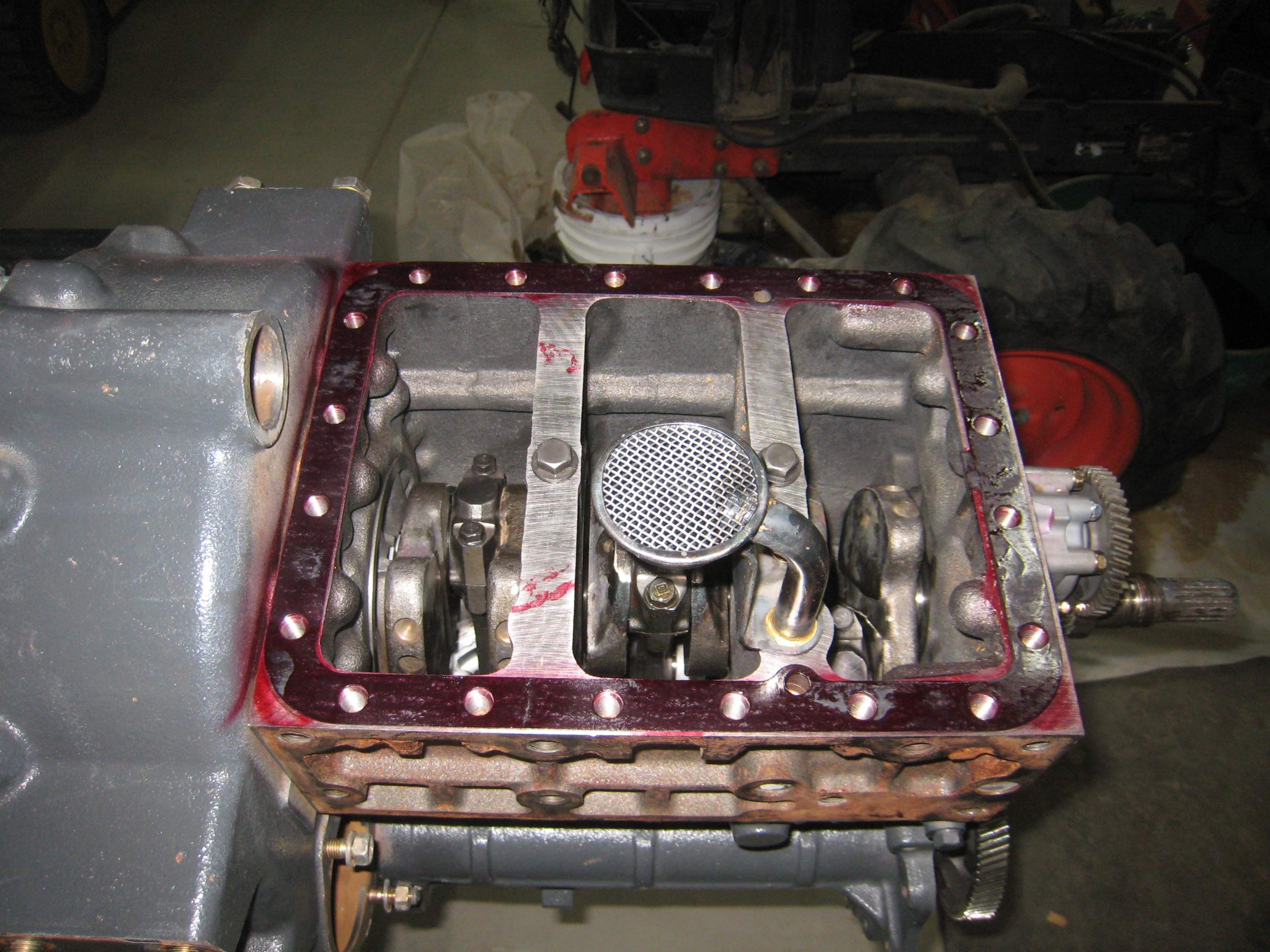

Problem root caused!

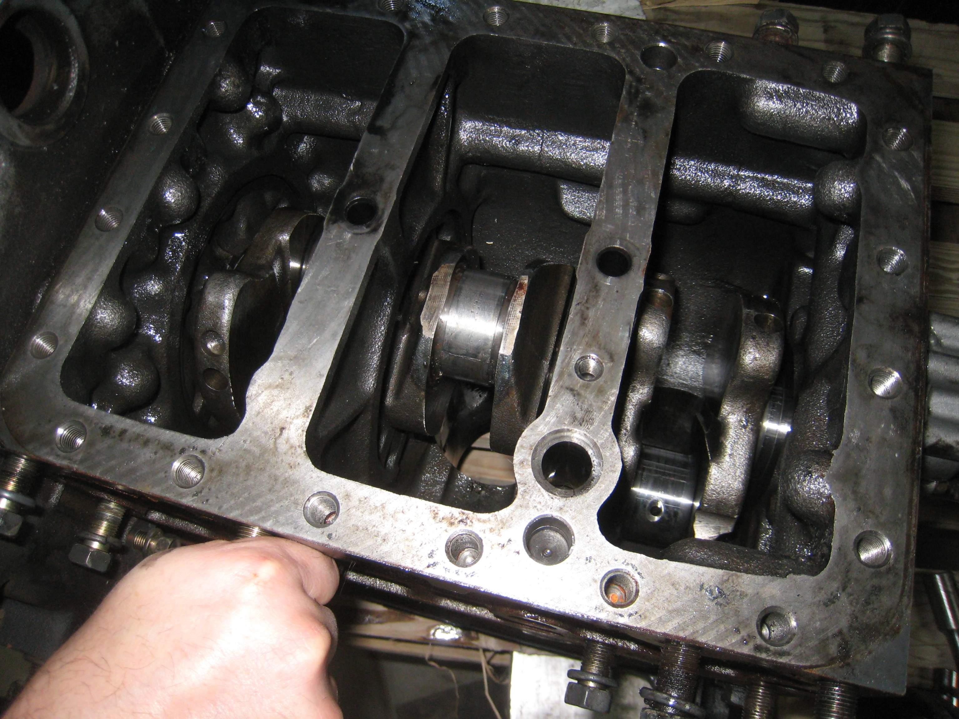

Removed the crank assembly and found the problem. The middle connecting rod bearing had fused to the crank journal. Wow, the previous owner said it was a connecting rod bearing and he was right. I still don't know a lot about engines but I'd think there could be many things that could cause engine seizure. How'd he know that was the problem?
The lighting is bad but the first pic shows the scoring and melted metal on the crank. The 3rd picture shows what connecting rod bearings look like. Really just C-shaped metal sleeves. I was expecting something a bit more elaborate.

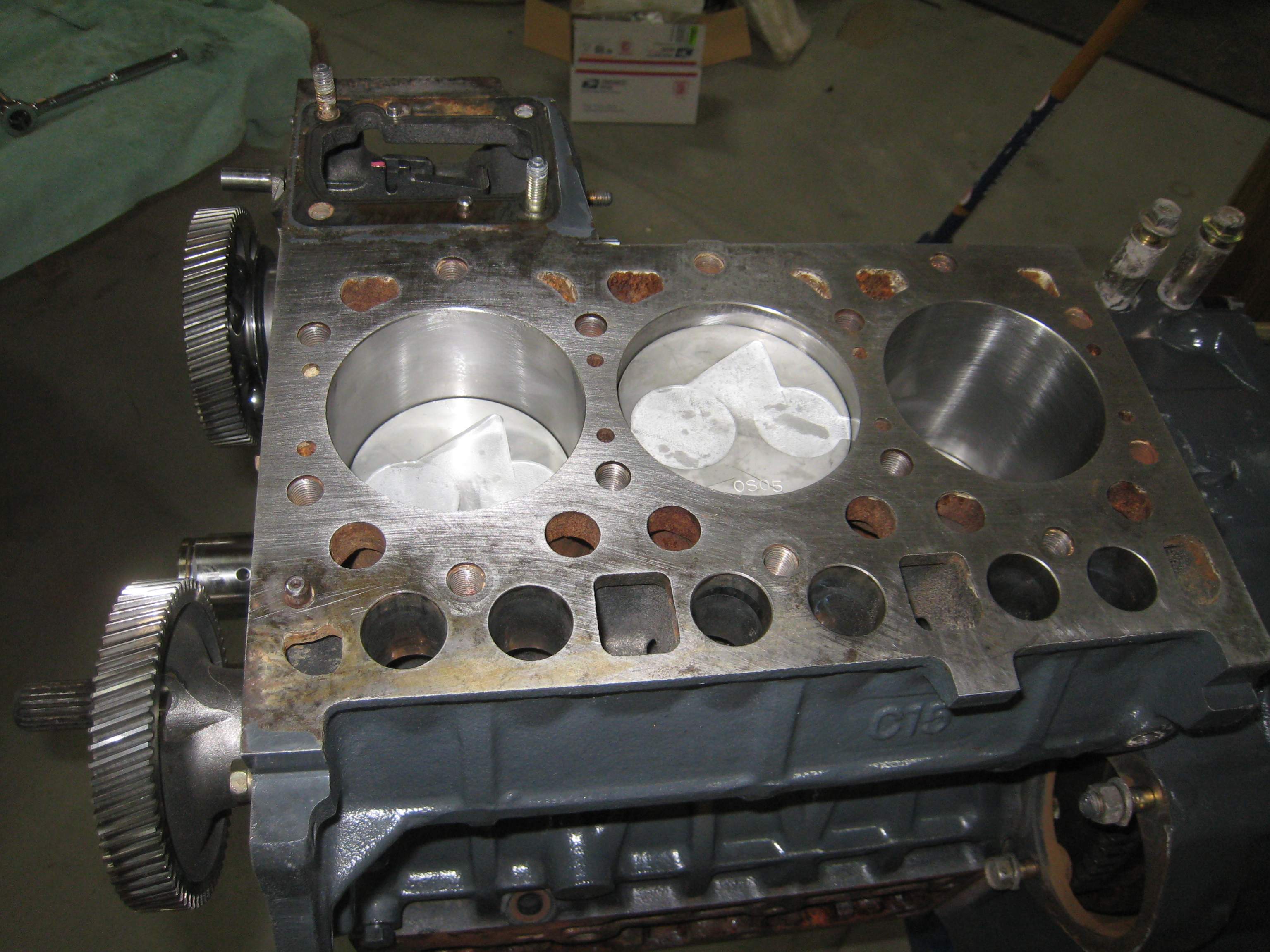

I took the engine parts to an engine machine shop to see what needed to be done. Hoping that they can tell me what to do and do something with the exiting crankshaft. BTW, the place is The Engine Shop in Longmont, CO. Great guy.
To make a long story short, the machinist thought that the connecting rod bearings were new. They had been installed incorrectly or not pre-lubed and they seized up right away. He said that they did exactly what they are supposed to do. If there is excess friction they are supposed to seize up and kill the engine motion rather than let something catch and bust out of the engine block.
One cylinder was .010 oversize, one .020 oversize, one .040 oversize. The machinist rebored the cylinders .020 oversize first putting a sleeve into the cylinder that was .040 oversize. He also reground the valves and was able to polish off the messed up the crank journal. I bought .020 oversize pistons and rings, gasket set, and a new oil pump just because I had everything opened up. I probably paid more than had I purchased a rebuild engine but I wanted to rebuilt the engine myself. Heck, if I would have had to purchase a new crankshaft, that would have cost more than a rebuilt engine.

The machinist allowed me to install the crank bearings, pistons, and camshaft in his shop under his supervision. I then brought the block home and put the rest of the engine together and painted it.
These pics show the engine fresh back from the machine shop. The first pic is right after I installed the rear main seal. The big gear on the left side drives the hydraulic pump.

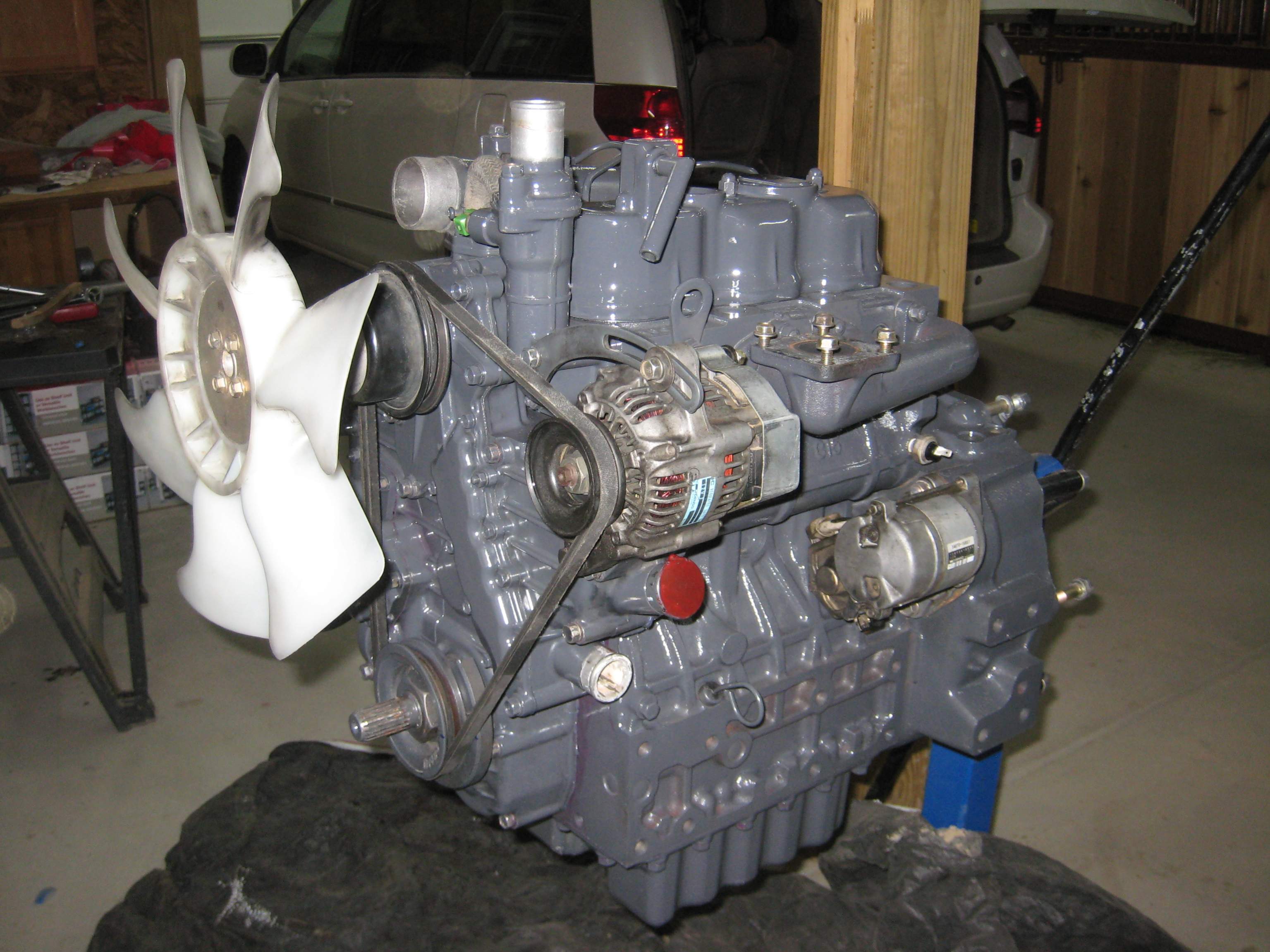

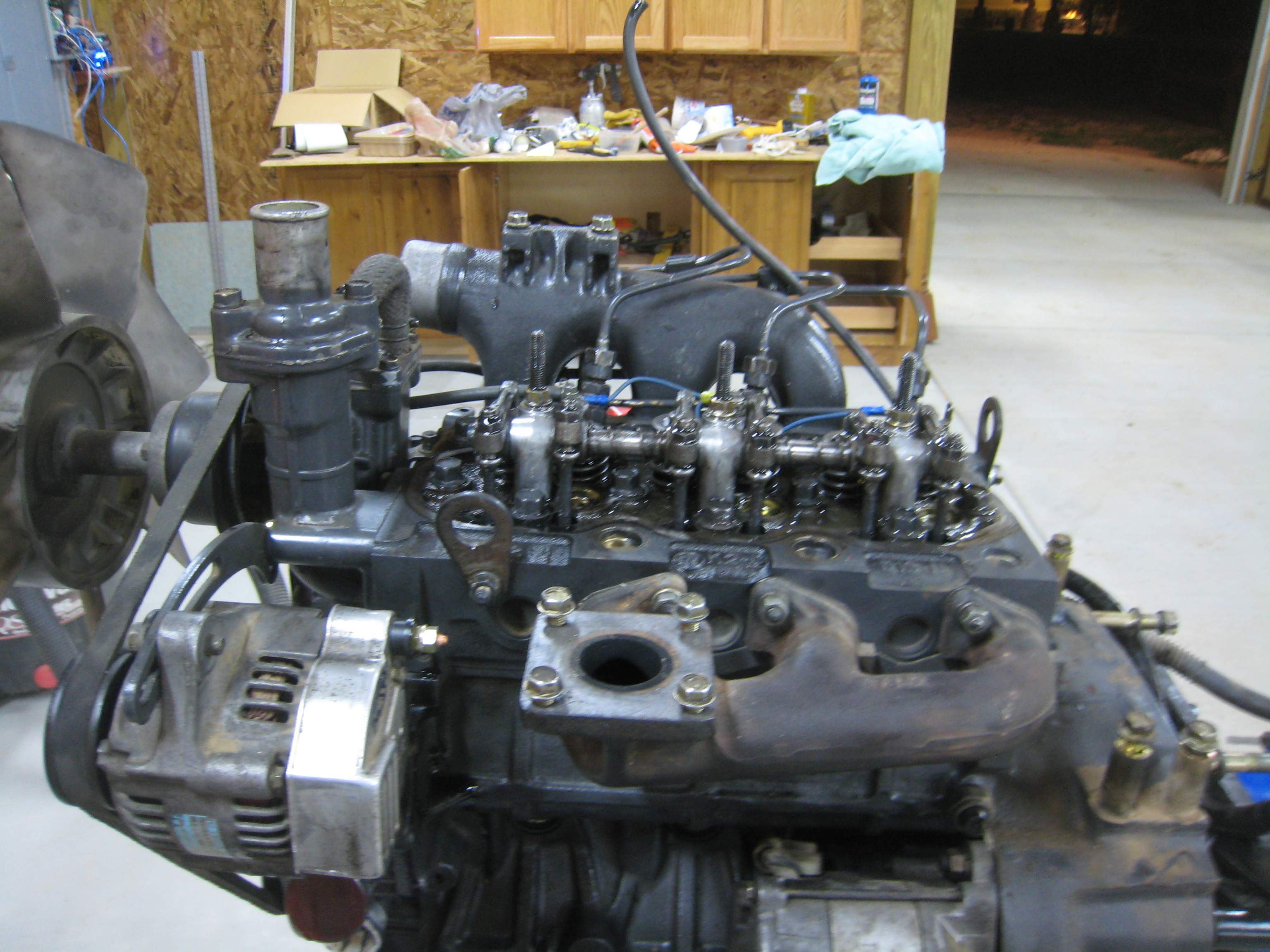

More pictures of the reassembly and final, newly painted engine.

I reinstalled the engine back in the front half of the tractor hooking up the radiator, fuel, and electrical console. Turned the key and the glow plugs fired. Turned the key again and blew the main 40amp fuse. Rigged up a 40amp circuit breaker and blew the breaker every time I moved the key to start. So I wired up a temporary switch between the battery and starter/solenoid connection. Used the key to ignite glow plugs and used switch to engage starter. The engine turned. And turned and turned. The air bleed valve didn't seem to be doing much so I removed one of the injector lines. After a lot of cranking, fuel finally began coming out of injector line. Hooked it back up and the engine sputtered and came to life! Sounds great. It was pretty thrilling I must admit.
