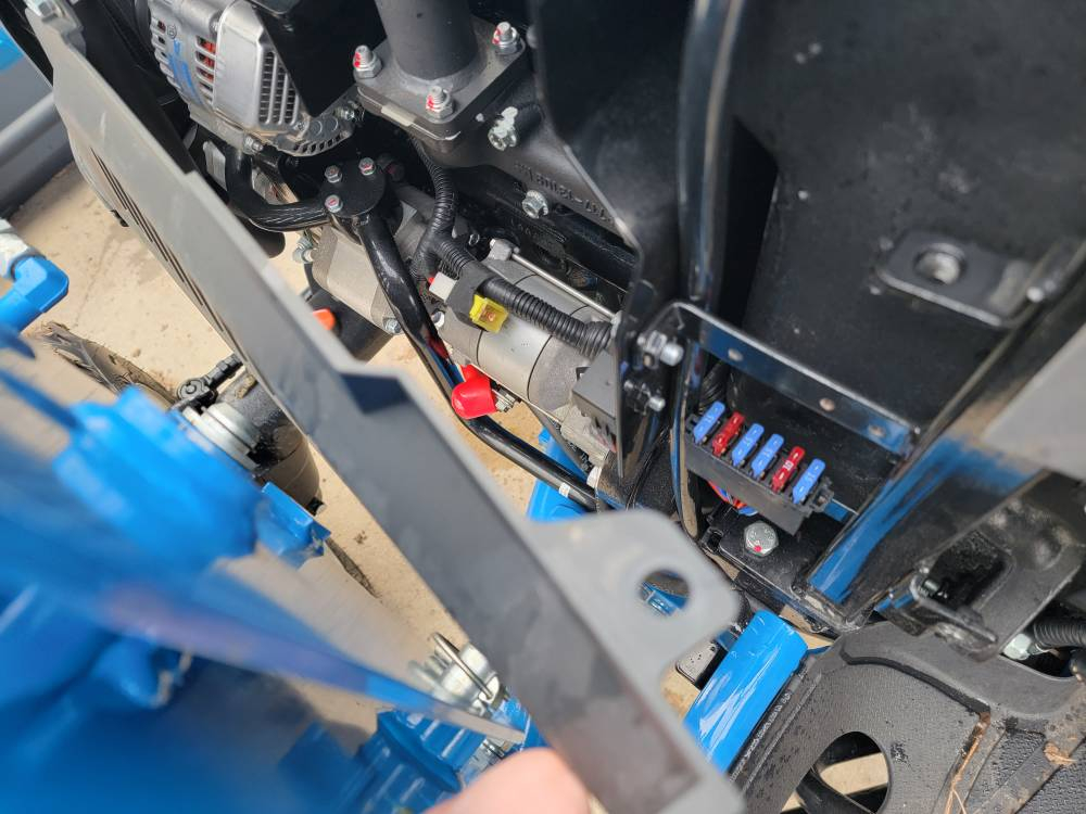

I had some time today to troubleshoot. I was able to solve my issue. I tracked down an owner's manual and checked out the electrical section. I located the fuse box behind the black, cosmetic panel on the left side. There's a catastrophic 60 amp fuse before the starter. Then there's a small fuse box. I checked all of the fuses and one, 10 amp "con/switch" fuse was blown. I replaced it and the tractor started right up.

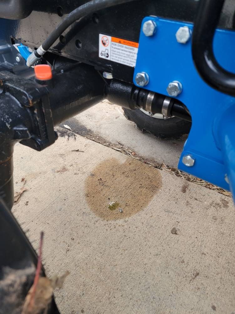

I still have a small leak underneath the engine and it continues at a drop per minute while running and immediately afterwards. At least I'll be able to move it.

Since multiple photos won't seem to upload, here's photo of the fuse box location.

I was just looking at your thread and owner's manual. I was going to have you check F1, F2, and F5 fuses. What you found was the F2 fuse blown for the controller and switch.
That controller would be on the right side of the dash somewhere behind the key switch and to the right. That should act as a master controller for all the safety switches and inputs. Without it the ECU should not get the start command from the controller.
