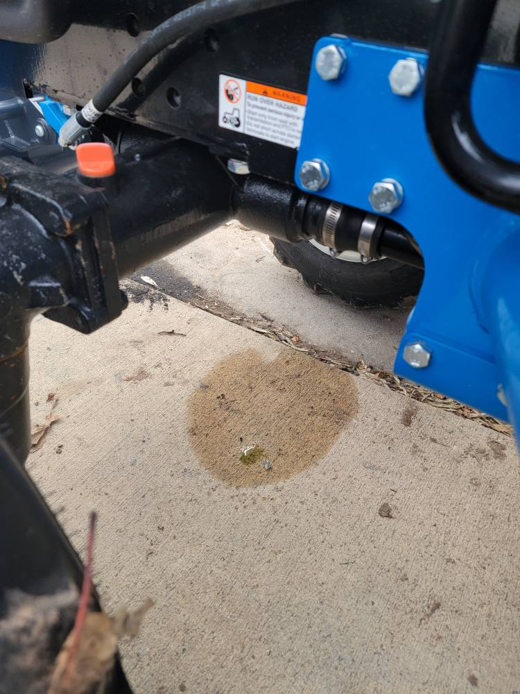

I had some time today to troubleshoot. I was able to solve my issue. I tracked down an owner's manual and checked out the electrical section. I located the fuse box behind the black, cosmetic panel on the left side. There's a catastrophic 60 amp fuse before the starter. Then there's a small fuse box. I checked all of the fuses and one, 10 amp "con/switch" fuse was blown. I replaced it and the tractor started right up.
I still have a small leak underneath the engine and it continues at a drop per minute while running and immediately afterwards. At least I'll be able to move it.
Thanks to everyone for your help and suggestions. All of your input will serve me well as I continue my rural journey. View attachment 730070View attachment 730069

Since multiple photos won't seem to upload, here's photo of the fuse box location.
/ Tractor quit and won't start #25
I was just looking at your thread and owner's manual. I was going to have you check F1, F2, and F5 fuses. What you found was the F2 fuse blown for the controller and switch.
That controller would be on the right side of the dash somewhere behind the key switch and to the right. That should act as a master controller for all the safety switches and inputs. Without it the ECU should not get the start command from the controller.

Update: Trailered the tractor to the dealer. They are going to look at the oil leak and inspect the harnesses for damage. I'm not confident the dealer's service is going to be thorough or effective. This dealership is not primarily in the business of selling tractors. I knew that going in, but I also had conversations with the technicians and felt confident. After my interaction with the service manager, not so much now.

Update: Looks like everything is squared away. I picked up the tractor last Thursday. Two hoses, one hydraulic and one radiator, were both leaking. Service ran the tractor for a half hour without leaks. I ran it at home for an hour and no leaks, so it looks like we're good. Service handled the repairs quickly and pleasantly.
Now I get to work.
