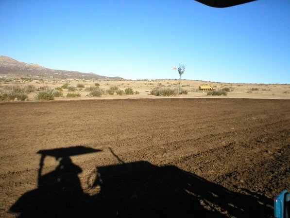

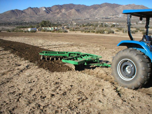

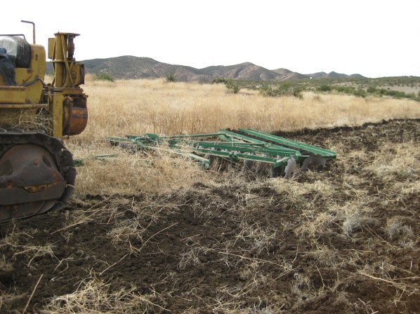

Galen, the reason for asking is that there have been several TBN members that have said that their tractor pulls such and such disc. Many times the size of the tractor and the size of the disc just don't add up to what seems to be a practical combination. So to confirm what these people have said that they do with no problems, I usually ask to see some pictures, I would love to be able to pull a big disk with my tractors, I just want to see what they have so that maybe I could do the same.
Guess what, no pictures yet. So this leads me to believe that just maybe these people are stretching the truth just a bit. I have no problem showing the different combonations that I pull, size, guesstimate of weight, type of disc and ground, topography. It is my feeling that you should be able to pull a disc through any type of circumstances that you may encounter on your property. If you can only disk once on hard ground, and then after the first pass you get stuck trying to do the second pass, what good is that?
Now all I have to base my thinking on is what my circumstances are and the results that I want. We have old John Deere offset pull discs, a 6' an 8' and a 12 footer. All have 22" disc blades. Guess that the 8' weighs a little over 2000lbs, the 12' might be close to 4000lbs. Most of our land is rolling hills, elevation changes 140', nothing drastic, our property is 1 mile deep. We have an old Cat D6 that we use to pull the 12 footer and there are times when it works, as in the tracks slip in the ground. Now I can pull these discs with my 7520 on flat ground 2 times. It won't do is three, and it is not due to my R4 tires, just not enough power. Yes if I had R1s maybe I could crawl, but what good is that? I usually pull our 8 footer with the 7520, and there are times, if conditions are just right that it will have problems. This is why I often question disking posts. Would just like to see what people are using, because what I have would not do it.
