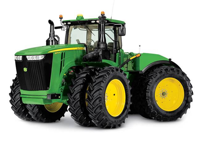

This is 4WD. If yours is smaller it is mfwa.
