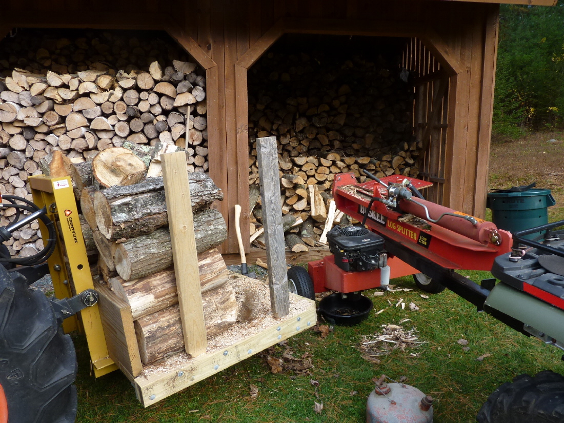

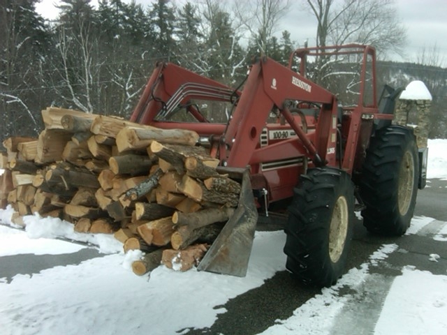

This mirrors my take on the question. When I split wood, rounds are gathered in the front end loader bucket, then positioned within easy reach of the splitter. Trailer is on the other side of splitter. So round is taken out of the bucket, split, then tossed into the trailer. Less bending; less picking wood from the ground.

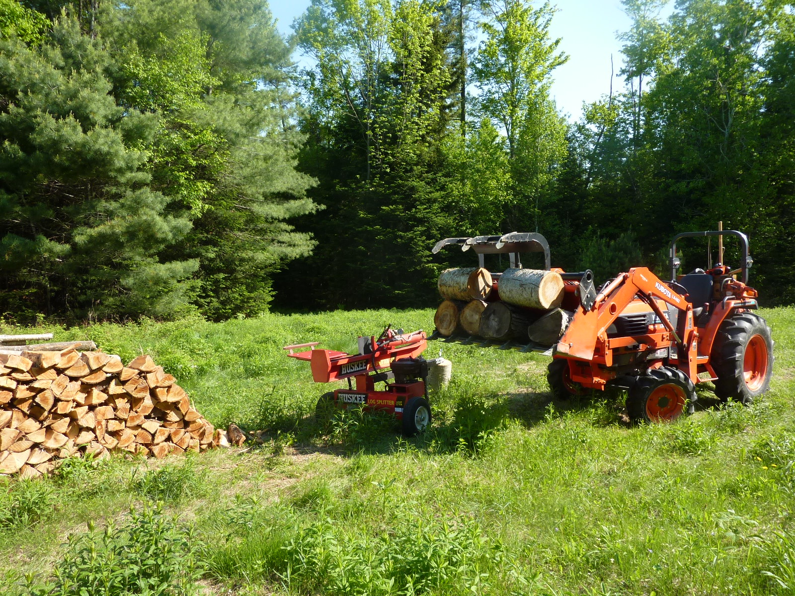

thanks for all the help, I think I have decided to go with stand alone for some of the reasons mentioned here. I saw one setup where it was a stand alone. Tractor posistioned a cart at the end of the splitter, unhooked, then tractor had logs in bucket, they positioned bucket next to splitter so he just had to pull logs out of bucket, split and put in cart, then just pull cart away when done.

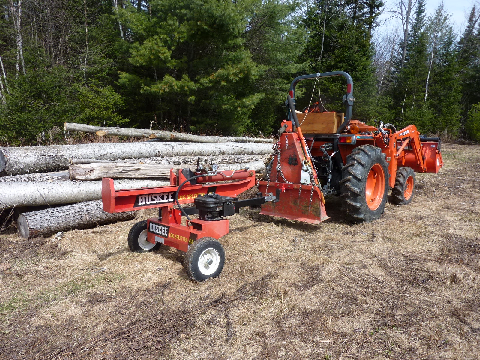

I have a 3PH splitter. It has it's own PTO pump and is not dependent on tractor hydraulics, so it's MUCH faster. I believe it's also more powerful as it's a bigger pump.
Advantages: No extra engine to maintain. No tires to go flat. I can't prove it, but I'm pretty confident that it's more fuel efficient. With a 20 horse diesel running the pump, it's darn sure more powerful. With the 3PH, I can set it to whatever height is comfortable to work with. Or, lower it right to the ground to set a big round on it. Moving it to wherever is just a matter of hopping on the tractor.
Disadvantages: Initial price was fairly steep but not really bad for the power. It's a bit of a pain to put on and take off. It ties the tractor up when it's in use, but that just takes a little planning.
I usually have the splitter on the back and the forks and grapple on the front. With the tractor and a chainsaw, I have everything I need to turn tree length logs into firewood.
Works for me.

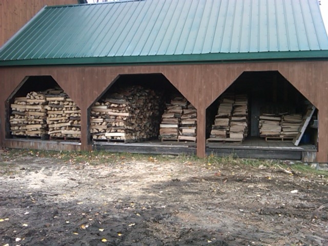

TPH advantages:
You can "put" the splitter in places you cannot put a stand alone. (EG: I set the end of the TPH unit on the lip of the wood shed, aith the rounds piled up at the edge of the shed. I park next to the rounds, split em and they go right from the splitter to the floor of the wood shed. A lot less handling!) You can set the splitter beam on the ground for the big rounds, even have pallets on either side of the beam so the big rounds RORO. You can adjust the height of the splitter to your perfect lifting height for the location situation. More HYD PSI power. I often set the splitter on a couple of large rounds to take the weight off the back of the tractor when splitting. That also allows, via use of the QC hoses, me to have the tractor available to move stuff around. Generally, however when I do that I simply raise the splitter with the lift and go about my business with the tractor and loader. I have 2 tractors and an F350 with remote hydraulics, so the splitter can be run by any of these machines. It would be VERY easy to mount QD wheels and a pintle loop on the splitter if I wanted to drag it to a splitting site with the truck.
I have had both a stand alone and a TPH splitter...... They both worked fine, however I prefer the TPH unit and parted with the stand alone unit. I like the versatility I get with what I have.
As to the hours on the tractor???????? I don't worry about hours on a tractor that will outlive me by 50 years..... In fact, I really enjoy working with them, no matter what chore we are up to.

They both split wood. Like most tools there are pros and cons to the different styles. You learn to take advantage of what you have. I have a stand alone splitter. It works out well for me because I like to use the tractor and splitter at the same time.
