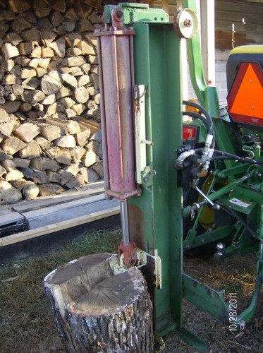

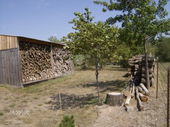

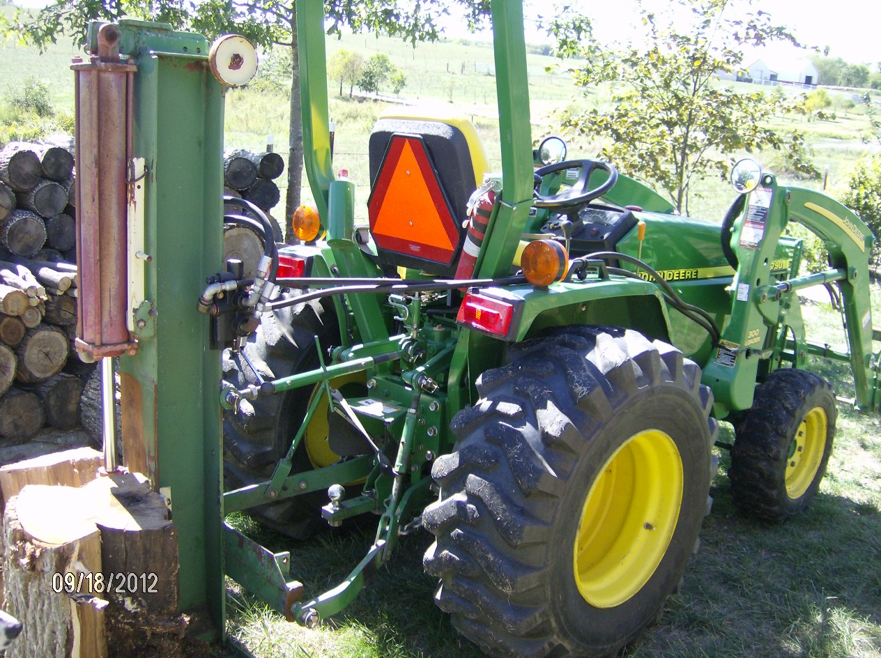

I bring my rounds in from the farm & stack them along the fence about 20' from the wood shed. Either split by hand w/Fiskars X27 splitting axe or sometimes use the 790. HPIM3896 (Custom).JPG HPIM3026.JPG I just roll the blocks from the pile to the splitter & stack the splits as I go, no big hurry! I understand that my set-up would be too slow for some, but works well for me! I'm about 3 years ahead on wood now & more trees that need to be cut. ~~ Lowell

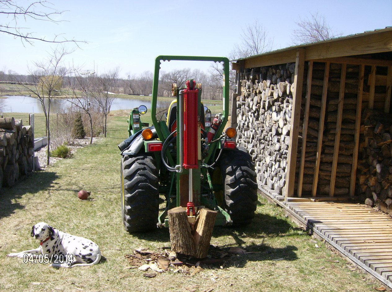

Nice set up......... I like the wood shed. I also like the vertical nature of your splitter. Take some side pictures if you will. I am curious how it attaches to the tractor. be great for splitting huge rounds. I make do by setting the splitter on the ground and rolling the rounds up to the beam, sometimes even using a pallet to make the step up easier. I had one what seemed like 3'+ round that I just didn't even attempt. It was pine and didn't seem worth the effort.
My splitter has the wedge on the beam end but I could modify it with a wedge on the cylinder rod pretty easily. The whole thing is SOOOOO incredibly heavy I cannot think of how to modify it in a way so i could choose to use it horizontal or vertical.
Just thinking about it.

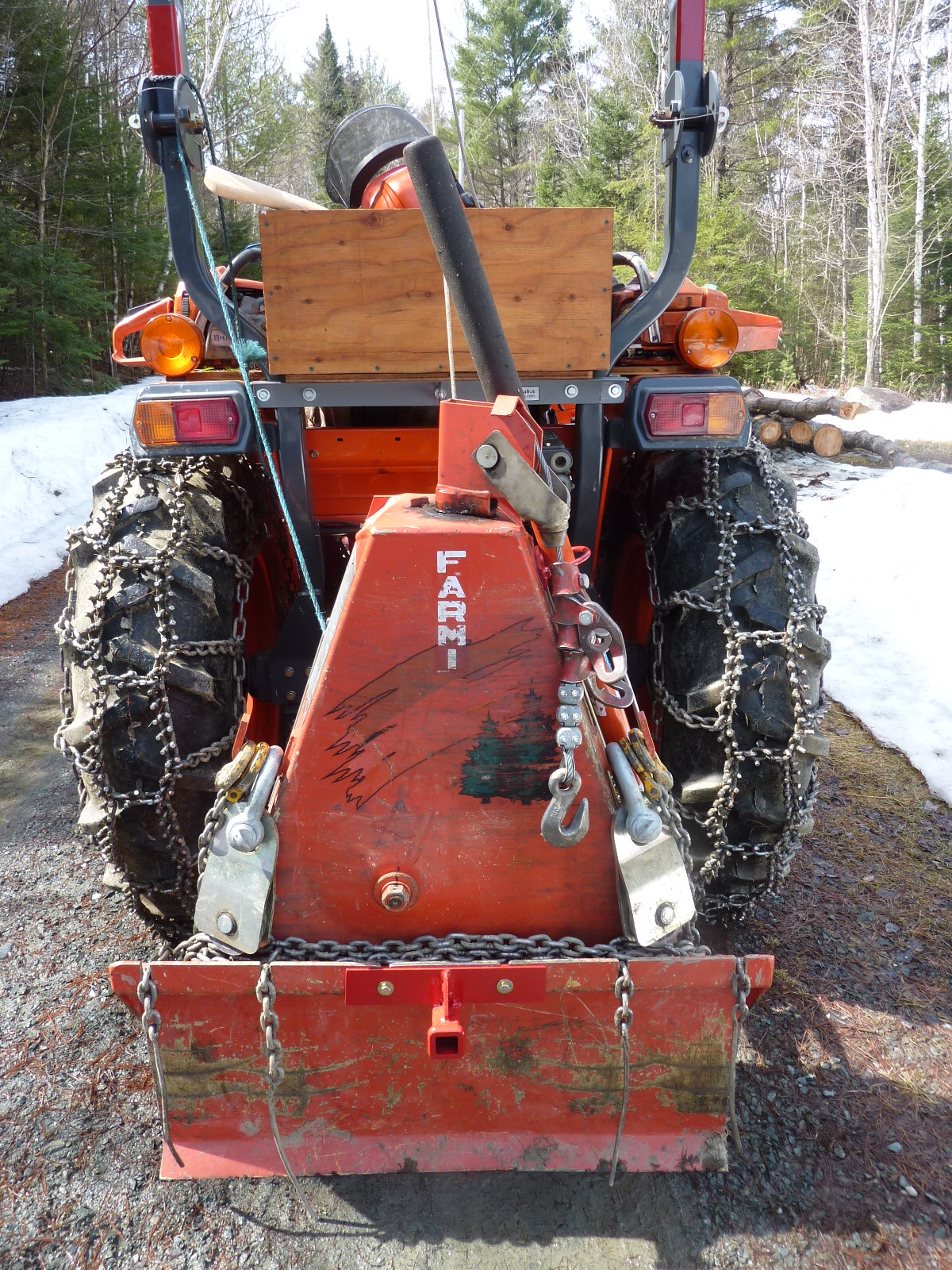

Gordon,

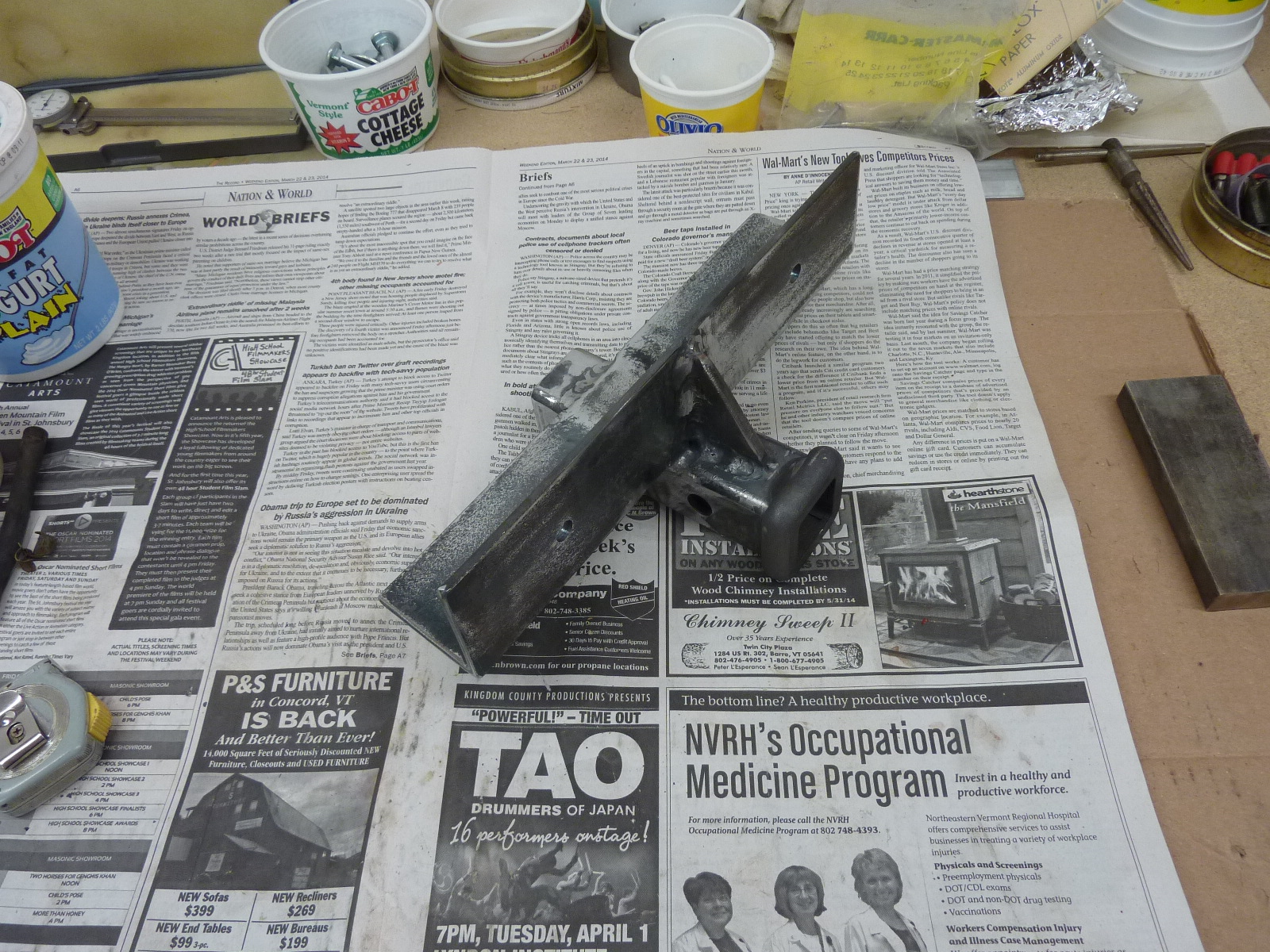

That is a slick setup on the winch. Do you tighten the bolts in the slots. I was thinking about getting someone to fab up and weld pallet fork receiver for my splitter. After seeing your solution, I think I will do the same. Did you use grade 8 bolts?
   / Tractor Log Splitter #25
Gordon,
Here is what I did. It is a 1-1/4" Reese Receiver - not heavy duty but good for a small trailer or my splitter. I also have a small vise on a reese hitch so I can hold my saw to sharpen or work on. Plus it works with all my 4 wheeler stuff which is also 1-1/4". I used two grade 8 3/8" bolts which have a proof load of 9300 lb each.
I think I paid around $10 for the receiver the rest was spare pieces I had. Getting it welded up should be cheap.
gg

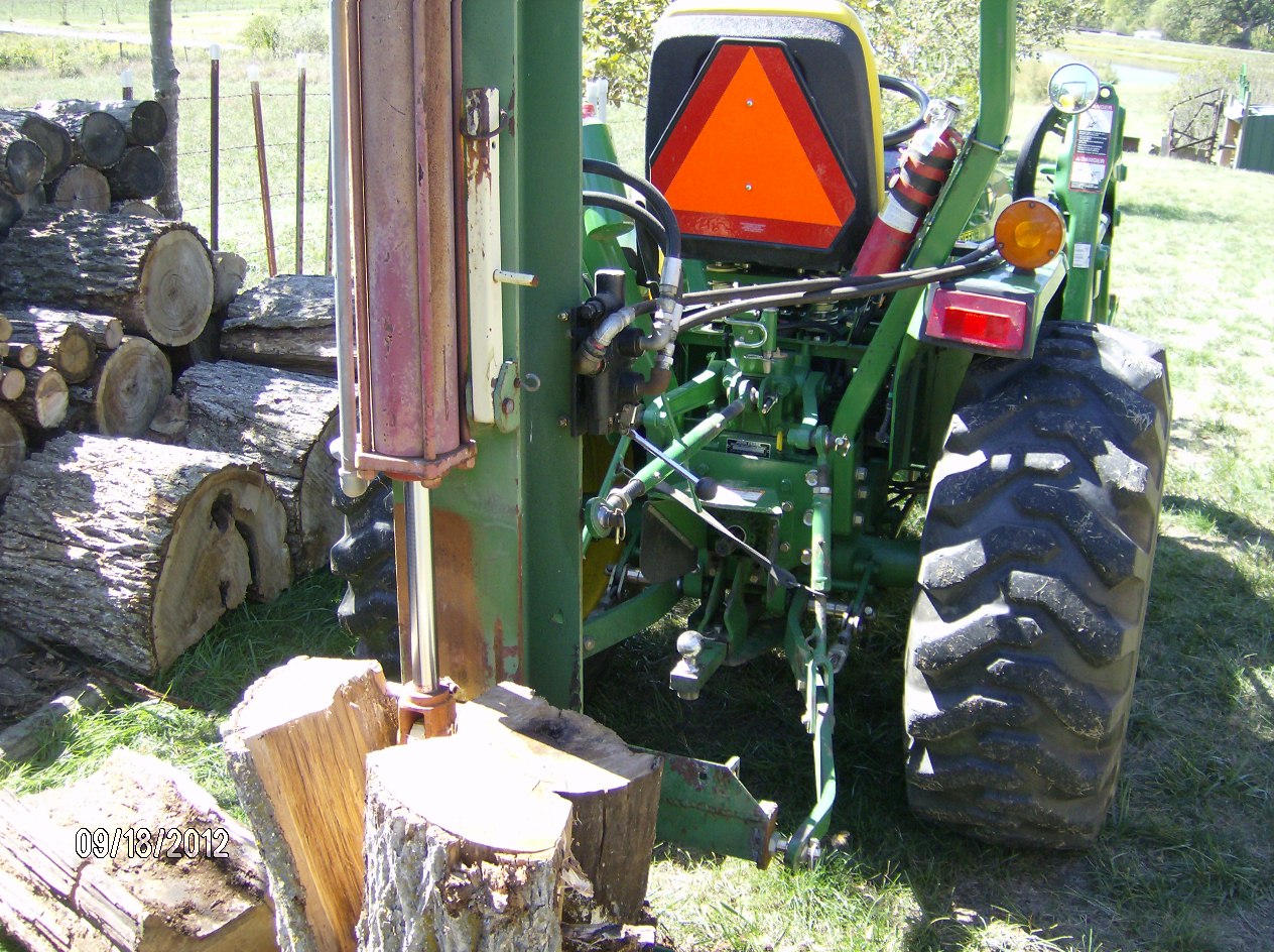

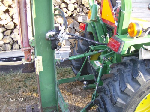

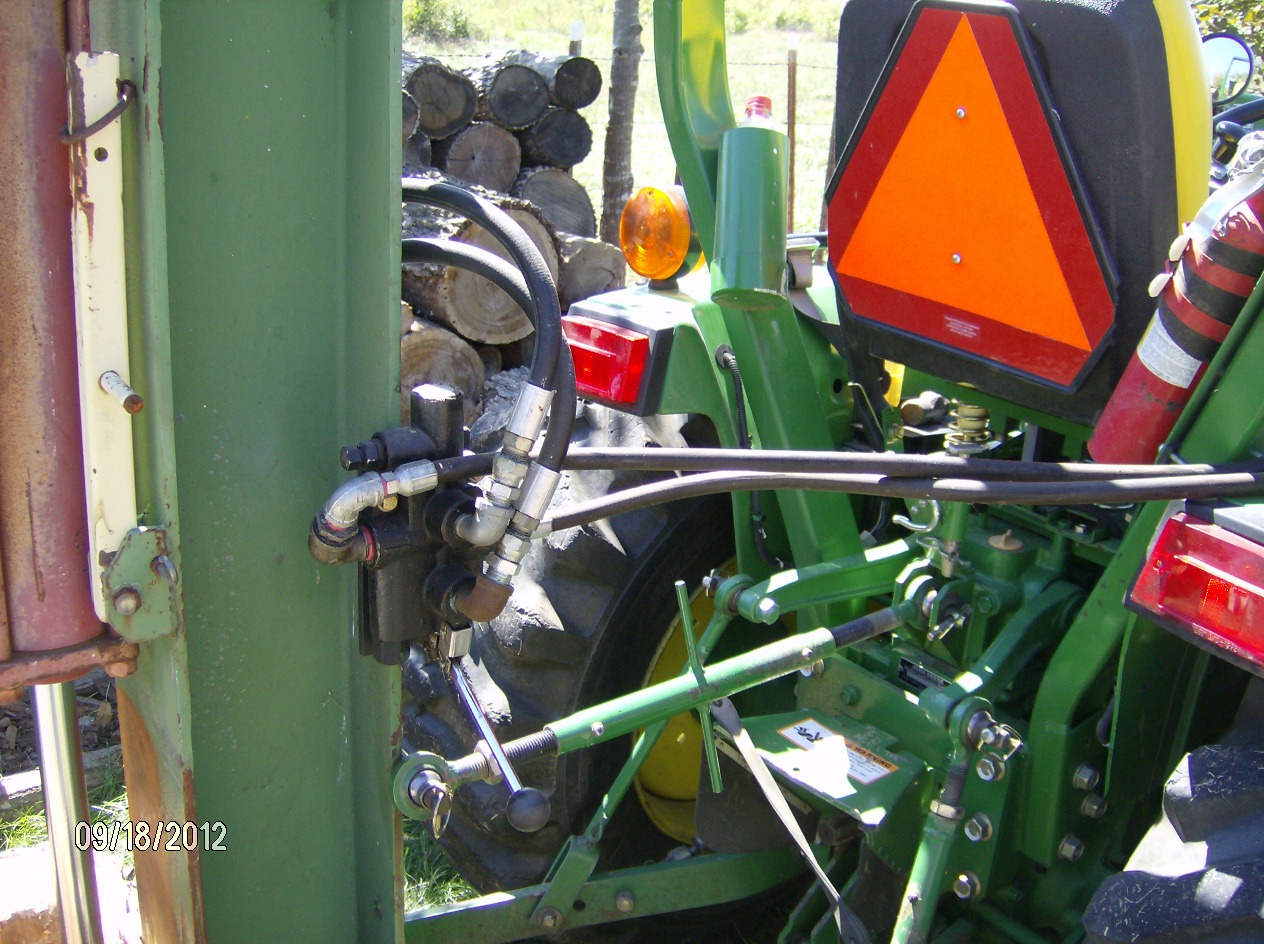

Here are the pics that I can find: HPIM3912.JPG HPIM3913.JPG HPIM3914.JPG
I originally built the splitter for my JD 520 using the tractor control, just added a lever & flipped the linkage over to it. The "H" beam came from the county bridge dept. (used), had to buy a new cylinder, but most of the rest of it was scrap I had on hand. When I got the 790, I had to add the control valve & long hoses, nearly doubling the total coast of the splitter to around $500.

How do you take it off the tractor and store it. it looks pretty heavy!
   / Tractor Log Splitter #28
Back it up to a corner post & set it on a wood base with a chain around the post so it can't fall over.
