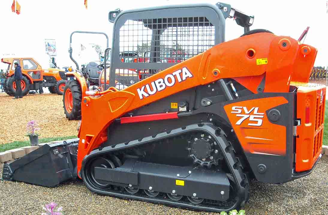

What size Kubota do you have to go to to get hydraulics the same as a Skidsteer Loader?
How about this size? The Kubota SVL75 has a 19GPM implement pump, and
runs at 3555psi.
Honestly, you can't expect compact tractors to come close to what
skidsteers or excavators can deliver. Even a mundane Bobcat S185 can
do 17GPM at over 3000psi. You have to go to Kubota's largest
M-series utility tractors to get that kind of flow, and I suspect that they
put out less pressure.
Then, the SS's also offer a "high flow" option.
If you want to run hydraulic implements, you really need to have them
sized for tractors, rather than SS's. That is what I do.
