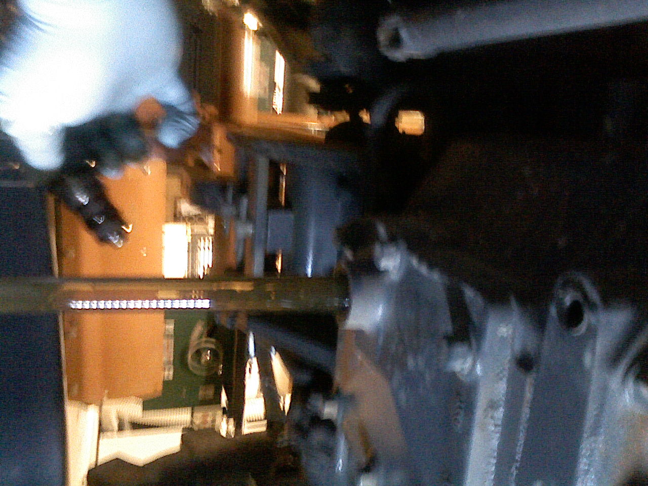

sorry, but I may not be using the right terminology. The filter has a threaded area that it screws onto, and a bolt (I guess) with magnets on it that goes through the center of the hydro filter. At least my 45 is that way. The pic shows how loaded my "bolt magnets" were.
Hope that solves any brain racking. Sorry for any confusion.

/ Tractor hydraulic/tranny fluid #13
this is the picture of my hydraulic fluid plug (for the whole system). Hst's have two filters - one for tran and one for hydraulic system, and I believe gear drives have only one.

Thanks for clarifying that for me. The 20's don't seem to have a set up like that.
rim
