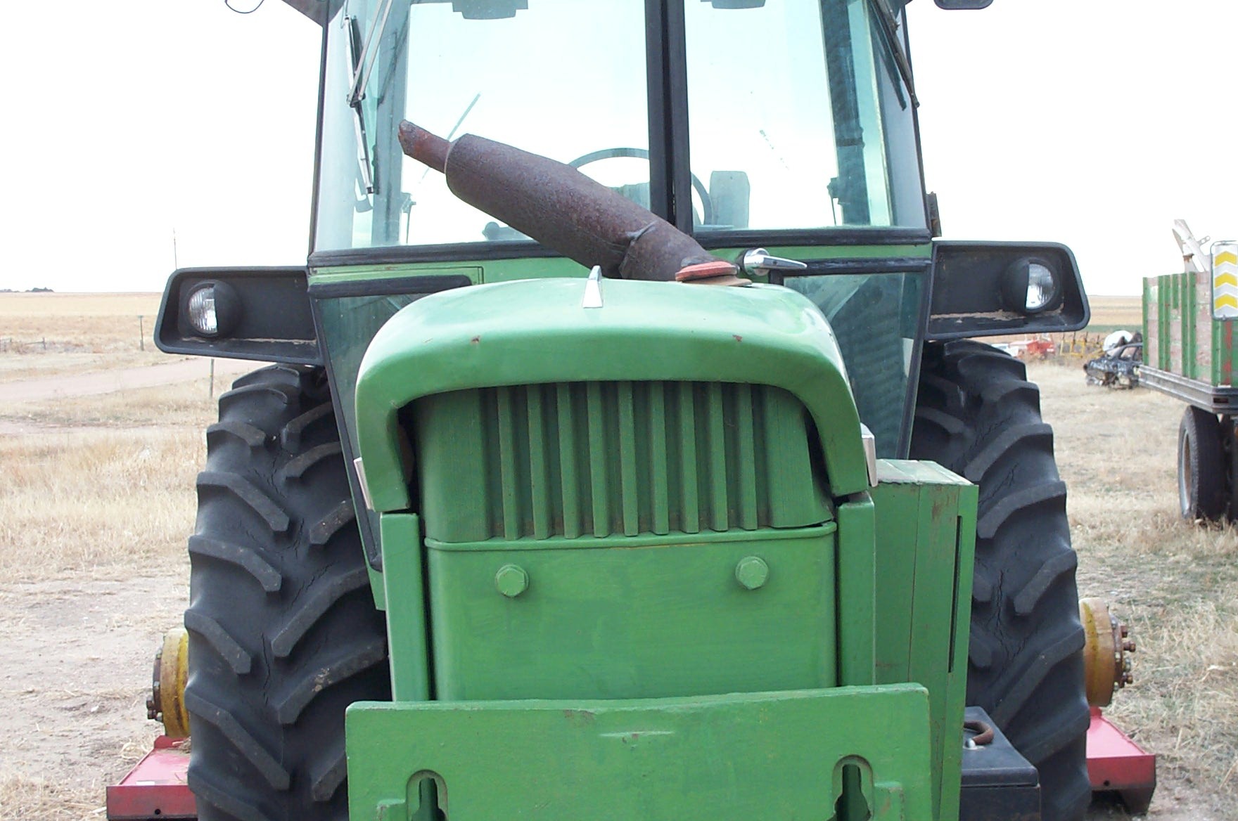

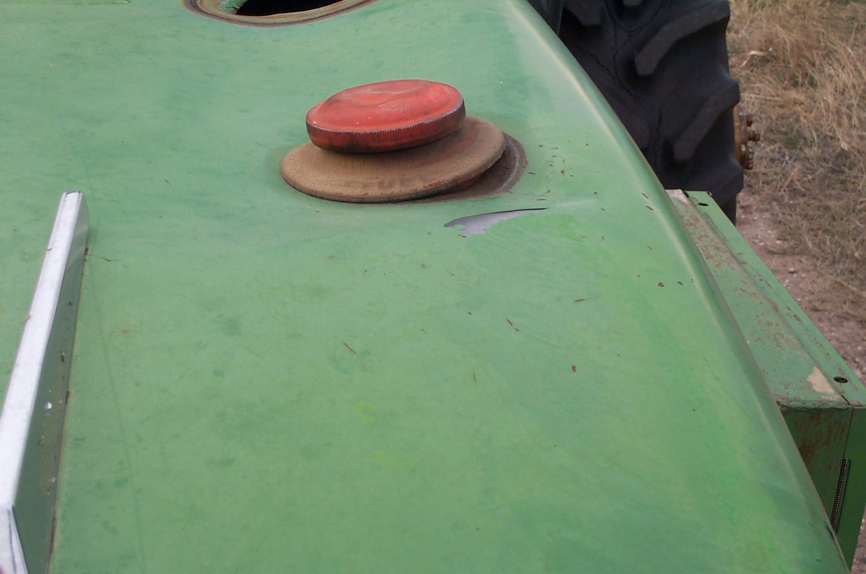

I had a 50 foot auger blow off the Bin and hit my tractor missing the cab by inches took off the muffler hood and even too the neck off the fuel tank and air intake,
as stated I took it off turned it up side down and basically walked the hood back straight, a little with a rubber mallet and block of wood for back up, there were no small dents in it from pounding, and turn out well, I would suggest trying not to use bondo if possible
Now if you could a walked that muffler back into shape it woulda been *REALLY* impressive! :D
