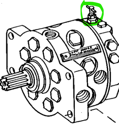

Hi,
I’ve done research but have not found a solution. 1998 John Deere 310SE backhoe with 4.5l (272ci) diesel engine. When mild temps , starts immediately. When cold, will hardly turn over and sometimes not start. Put battery charger on it and it shows batteries almost fully charged. Three guesses as to what might be going on: bad ground wiring; bad starter motor; or batteries (2). I just can’t think of why it starts like a champ all summer, then barely turns over when cold (below 35f). What would be most likely affected by cold temperatures? Seems batteries to me, but curios if anyone has had and cured this problem. Thanks.

A diesel engine Achille's heel is cold weather. Oil viscosity is high requires (so more starter torque to turn over the engine), battery output is low at lower temperatures (so starter torque output is naturally lower). Combustion chamber walls are cold and that has a deactivating effect on starting the combustion process. Your best bet is to get a block heater and plug it in for a couple of hours before you want to use.

It may have been mentioned but I will mention as it's very important that to start JD engine in tractors with similar closed-center hyd system one needs to utilize a front hyd destroking mechanism so front hyd pump isn't attempting to build hyd pressure during engine starting process. Manual DS screw encircled in green or electric controlled DS valves are available. Also relocate battery ground cables from tractor sheet metal to engine block for better electrical continuity.

Tex Jim I didn’t know about that screw. I remember shifting the steering wheel from side to side make the engine turn faster. Grounds are really inadequate on all this equipment, I agrree
